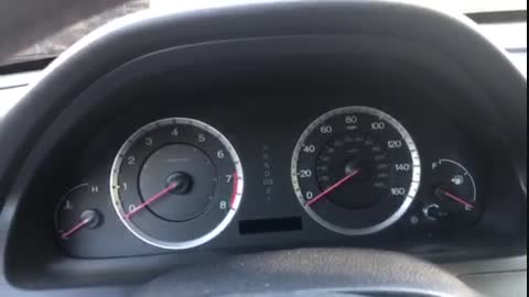

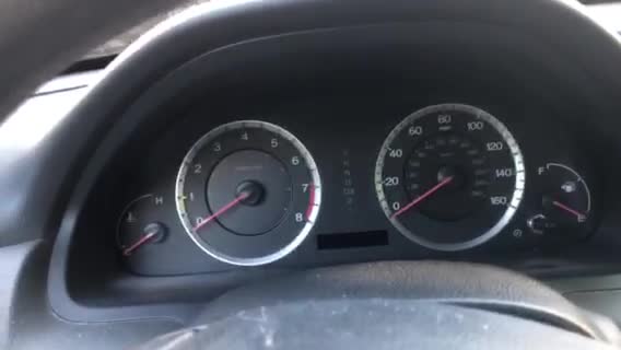

When turned the key on III position, dash boar lights all turned on. I attached video. Several days ago I could shift gear from neutral to parking, but today the gear was locked I could not move from parking position to neutral.
When turned on engine the starter crack sound is very weak, alternator moved second, and engine could not start.

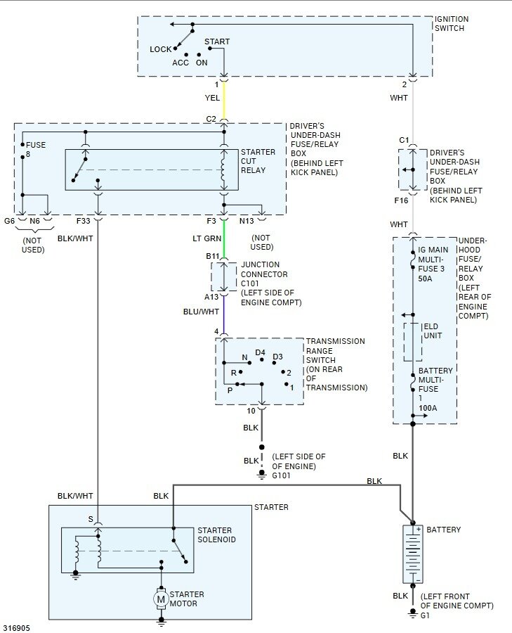

So, I want to check the wires to starter and to ECM. I got diagrams from former your technician, but I could not identify the real parts and locations, and how to test wire, etc.,

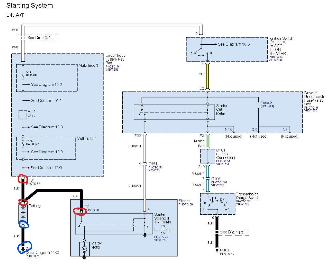

The issue is not with the ECM. It plays no part in getting the engine to turn over(which yours isn't doing) You have a low voltage issue. First clean both ends of the main battery cables. Now you will need a bit of help for the next test. Take your voltmeter and set it to 20 volts. Put one probe on the negative terminal on the battery. Then put the other one on a clean spot on the engine block. Have someone try the key while you read the volts. In a perfect world you would see zero, however in reality you can see up to a half of a volt. This is called voltage drop. It is the resistance in the cable and both connections.
Now do the same test on the positive cable. If both of them show less than half of a volt, the cables are OK. Now do the same test between the engine block and the cars body. There are a couple of ground straps that can fail, here you should see much closer to zero volts. If not then the grounds are suspect.
Attached is the diagram for the starting circuit. The red circles are the points you want to test. Corroded connections are very common. The easiest way to get to them is to simply follow each cable. Another way you can test if you don't have a helper is to turn on the headlights, that will also give you a current draw but won't show as high of a number in the tests. Because your car doesn't go completely dead when you turn the key I suspect the issue is on the starter motor battery feed but a bad block ground could also cause it.

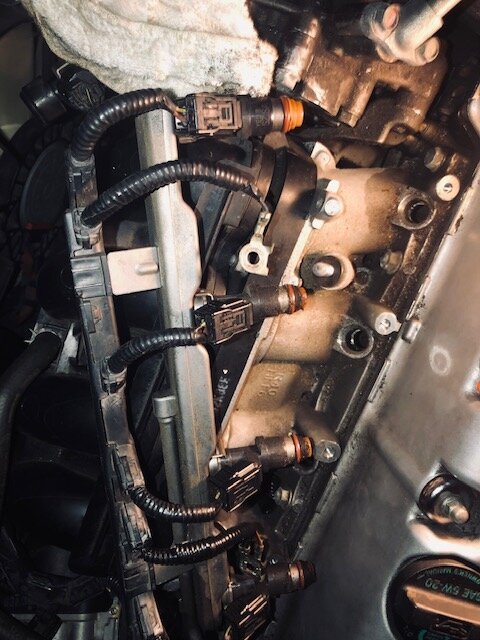

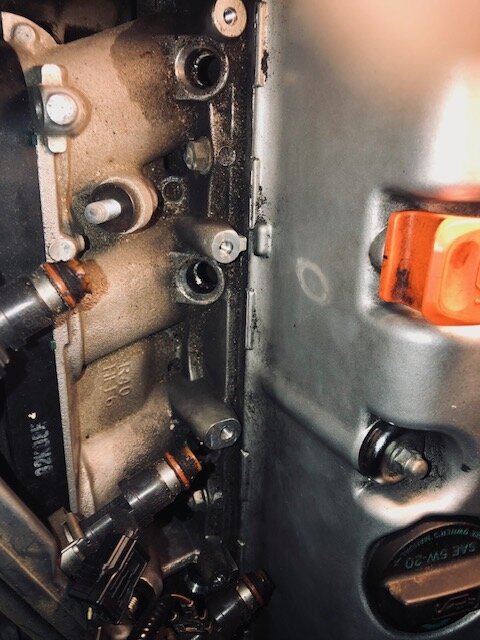

When I check injectors wire and looked at bases of each injectors I found #2 and #3 injector bases were not tightly inserted to the base, and the bottom of injectors very dirty covered with dirty debris and oils fixed round of injector bottom as images attached. Sb had touched the injectors. The injector leak and contamination as well as congested injectors may be the error sources. Therefore, I replaced the two problematic two injectors with OEM honda parts, OEM ignitioin coils and OEM spark plugs. Great recommendation I will check with fuel pressure.

You don't use a sensor, you use a mechanical fuel pressure gauge tapped into the fuel line under the hood. You should get 48-55 psi with the vacuum line on the regulator disconnected. If it is higher than that or the regulator was bad it could add extra fuel and give you the trims that are pulling fuel. However you also might want to check the engine oil for fuel, fuel in the oil could also add fuel through the PCV and cause this.
