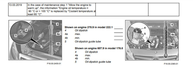

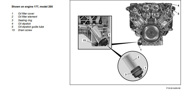

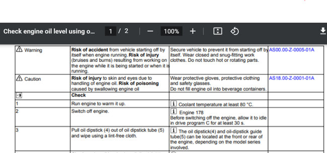

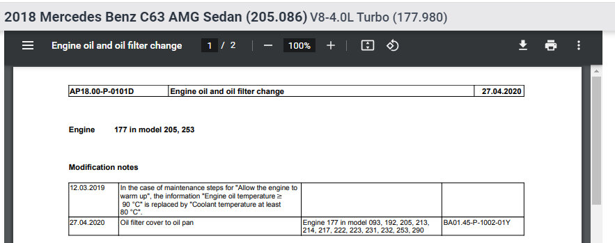

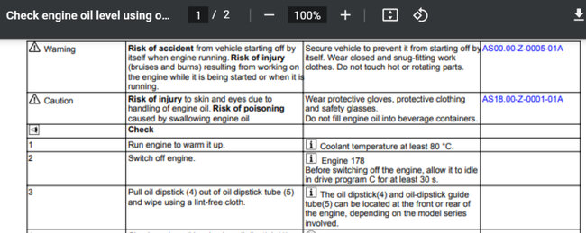

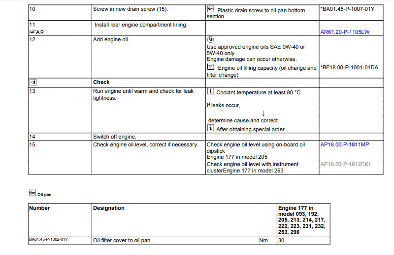

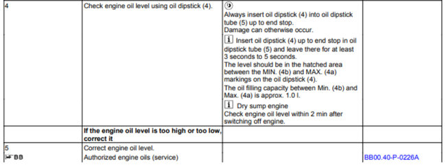

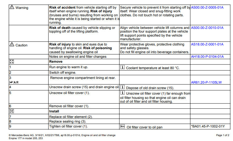

This is actually a 2018 GLS63 AMG, but i couldn't find the option for it in the list. How do i check oil level and how to change oil.
Apr 25, 2023 at 4:20 AM
Experienced Mechanic
110,248 POSTS
If you look below, I attached the directions for changing the oil and filter as well as how to check the oil level.
Take a look through them and let me know if you have questions.
