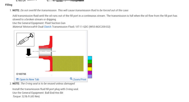

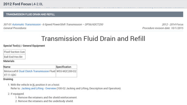

How to change transmission fluid?
2012 FORD FOCUS
171,000 MILES • 4 CYL • 2WD • AUTOMATIC
BHAMDOC1973
  • 2,007 POSTS
And what type of fluid is recommended and capacity, please?
Jan 12, 2023 at 5:39 AM
  • 54,840 POSTS

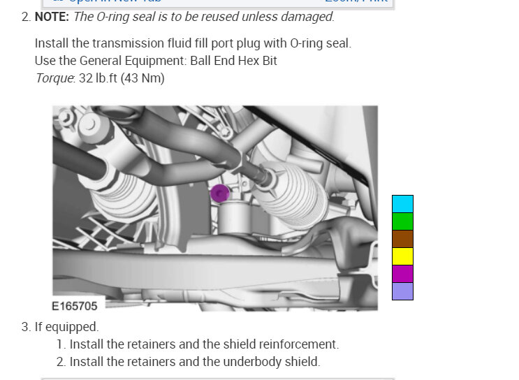

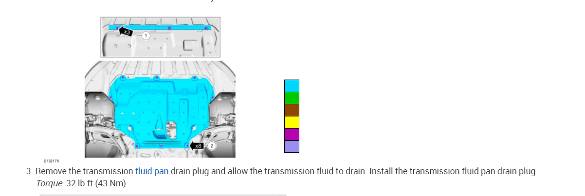

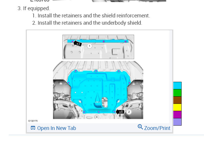

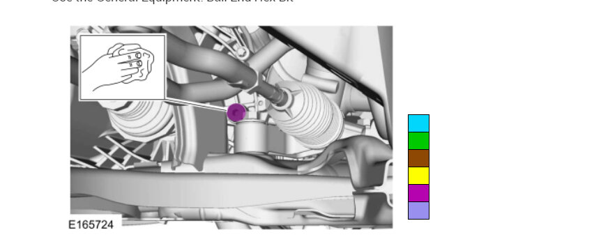

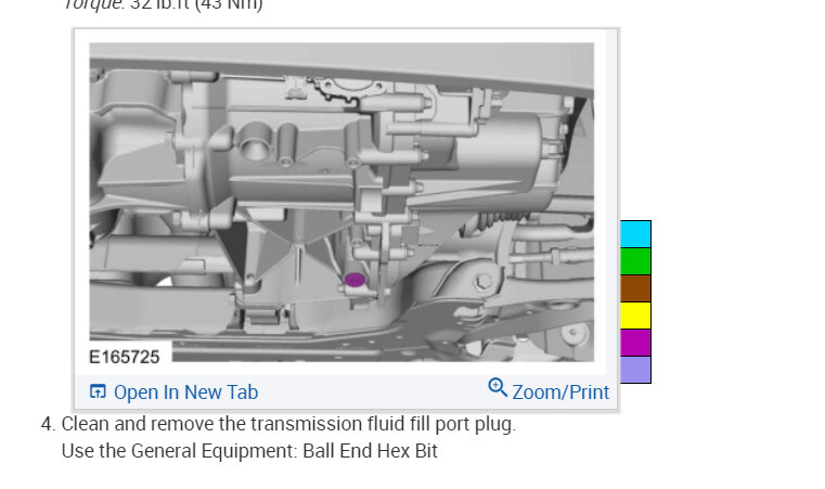

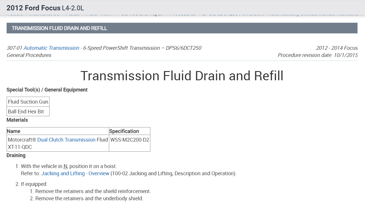

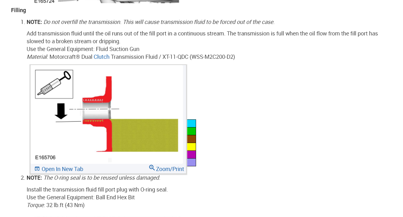

Here is a guide to help walk you through the steps and the instructions for your car in the images below:
Fluid Types
Automatic Transmission Fluid
Ford Part Name
- Motorcraft Dual Clutch Transmission Fluid*
Ford Part Number
- XT-11-QDC
* Automatic transmissions that require Motorcraft Dual Clutch Transmission Fluid should only use Motorcraft Dual Clutch Transmission Fluid. Refer to scheduled maintenance to determine the correct service interval. Use of any fluid other than the recommended fluid may cause transmission damage.
Capacities
Automatic Transaxle .................... 1.9 quarts (1.8 liters)*
* Approximate dry fill capacity. Actual amount may vary during fluid changes.
Check out the images (below). Please let us know if you need anything else to get the problem fixed.
