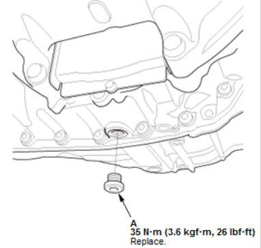

I have seen many videos with the 2.4l engine, can you find out for me where the fill plug is located on top and whether it is the same as the 2.4l one?
Mar 23, 2026 at 12:22 AM
  • 55,423 POSTS
Sure, here is a guide to help you with the drain plug location in the images below.
Always use Acura Automatic Transmission Fluid (ATF Type 3). Using the wrong type ATF can affect shift quality. Check out the images (below). Let us know if you need anything else.

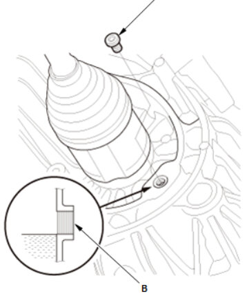

I don't think the fill plug is on side by axle like it's showing. I see the drain plug which is an Allen key type on bottom. But the oil should be on top
Mar 23, 2026 at 10:24 AM
  • 55,423 POSTS
This is where they show the fill plug, can you confirm?
Mar 24, 2026 at 1:47 AM
BHAMDOC1
  • 362 POSTS
Ya i see one now on top, same allwn key tupe as the bottom one
Mar 24, 2026 at 1:54 AM
  • 55,423 POSTS
Okay, good job. Let us know if you need anything else.
