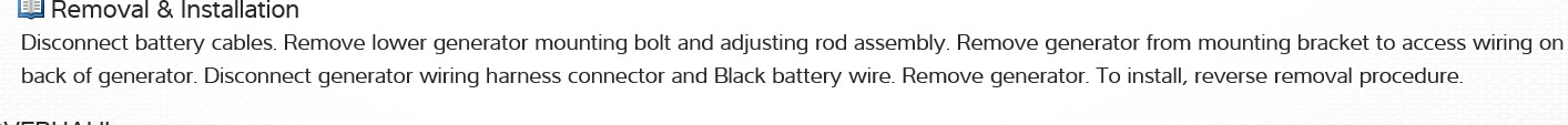

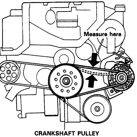

How do I install the alternator and the belts?

See pic for removal and install
