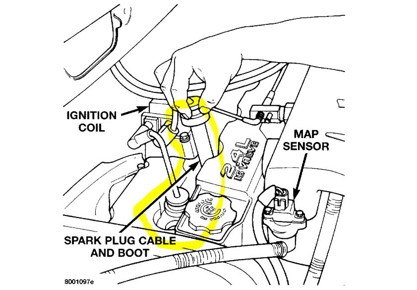

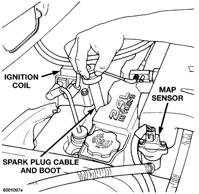

Where are the spark plugs on my van and how do I get to him?
Jan 13, 2019 at 11:37 AM
Good morning,
I attached a picture of the location and the procedure for you to change the plugs.

Here are the directions specific to your vehicle for replacing spark plugs:
REMOVAL AND INSTALLATION
Fig 6 Spark Plug Cables
See picture 1
CAUTION: Note routing of secondary ignition cables before removing.
- Failure to route cables properly may result in radio interference, ignition cross fire, or ignition short to ground.
NOTE: Keep plugs in order removed.
- A plug, that looks different from the rest, could be a problem indicator.
CAUTION: Never Wire Brush Spark Plugs.
- The spark plug insulator tip is harder than the bristles of wire brushes.
- Bristles of wire brushes can leave a conductive, metallic film on the insulator which could lead to conductive deposits.
- Conductive deposits can cause spark plug failure and engine misfire.
- Use a jewelers file to remove deposits from the electrode gap or use a spark plug cleaning machine to clean spark plugs.
Always remove cables by grasping at the boot, rotating the boot 1/2 turn, and pulling straight back in a steady motion.

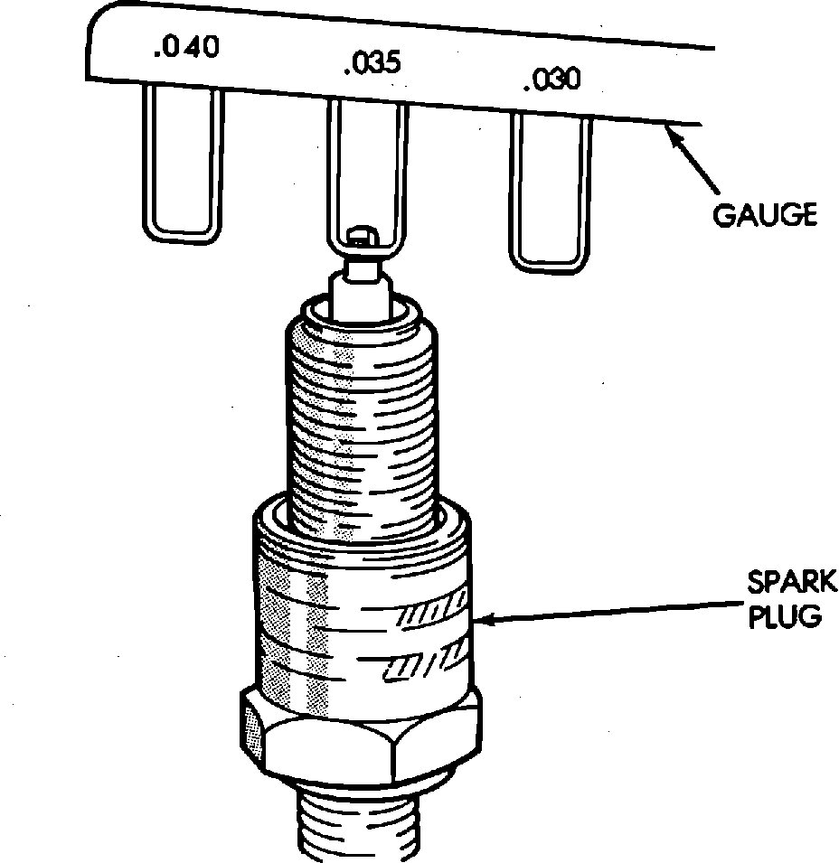

You will need to confirm the new plugs are properly gaped. See pic 2 which shows how the gap is checked. You will need a feeler gauge to do this. Here are the gap specifications for your vehicle.
Gap .................... 1.2 - 1.3 mm (0.047 - 0.051 in)
