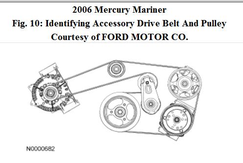

how to change the serpentine belt
2006 MERCURY MARINER
108,000 MILES
MWINESKY
I've changed a few belts in my time but this one got me stumped its in there tight. looks like there should be a panel to be removed
Apr 20, 2013 at 11:16 AM
HMAC300
  • CAR REPAIR CONTRIBUTOR
  • 48,601 POSTS
you have to remove the right splash shield first . also replace tensioner at same time tighten tensioner mounting bolt to 33 ft. lb Check out the diagrams (Below). Please let us know if you need anything else to get the problem fixed.
