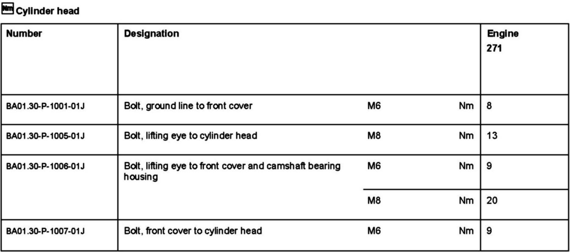

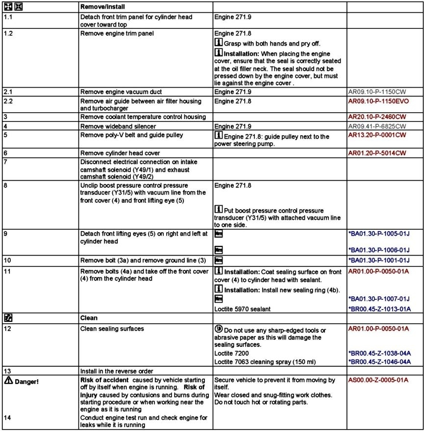

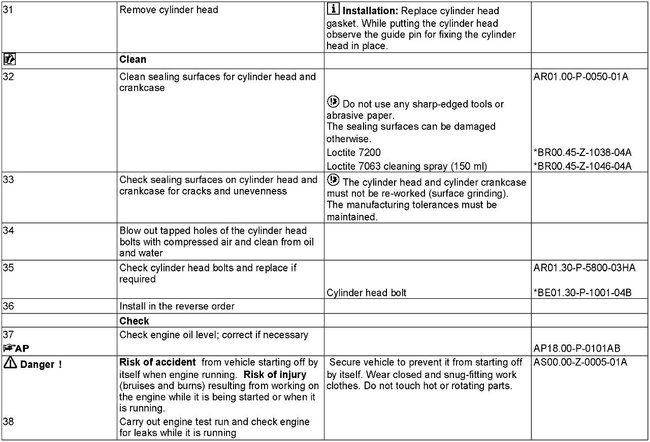

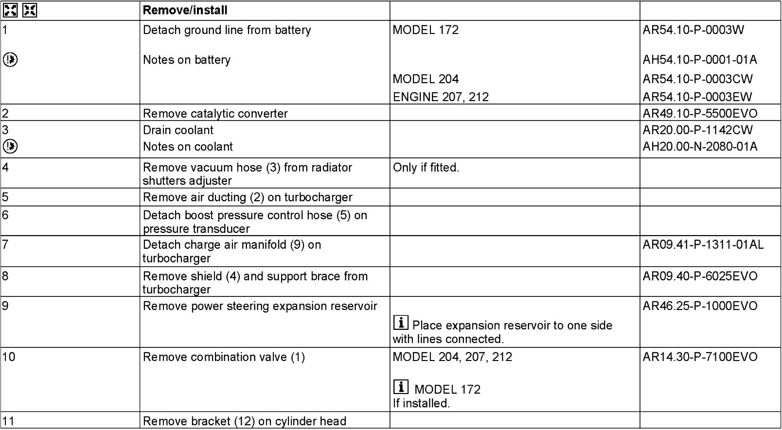

For that you might want to buy a subscription to alldatas DIY side, that way you can follow the process easier. It's about 30 bucks for a year of access and gives all of the same info we have access to, plus you also have this site to ask extra questions on. It also will have all of the torque numbers to match your engine.
http://www.alldatadiy.com/

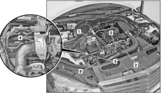

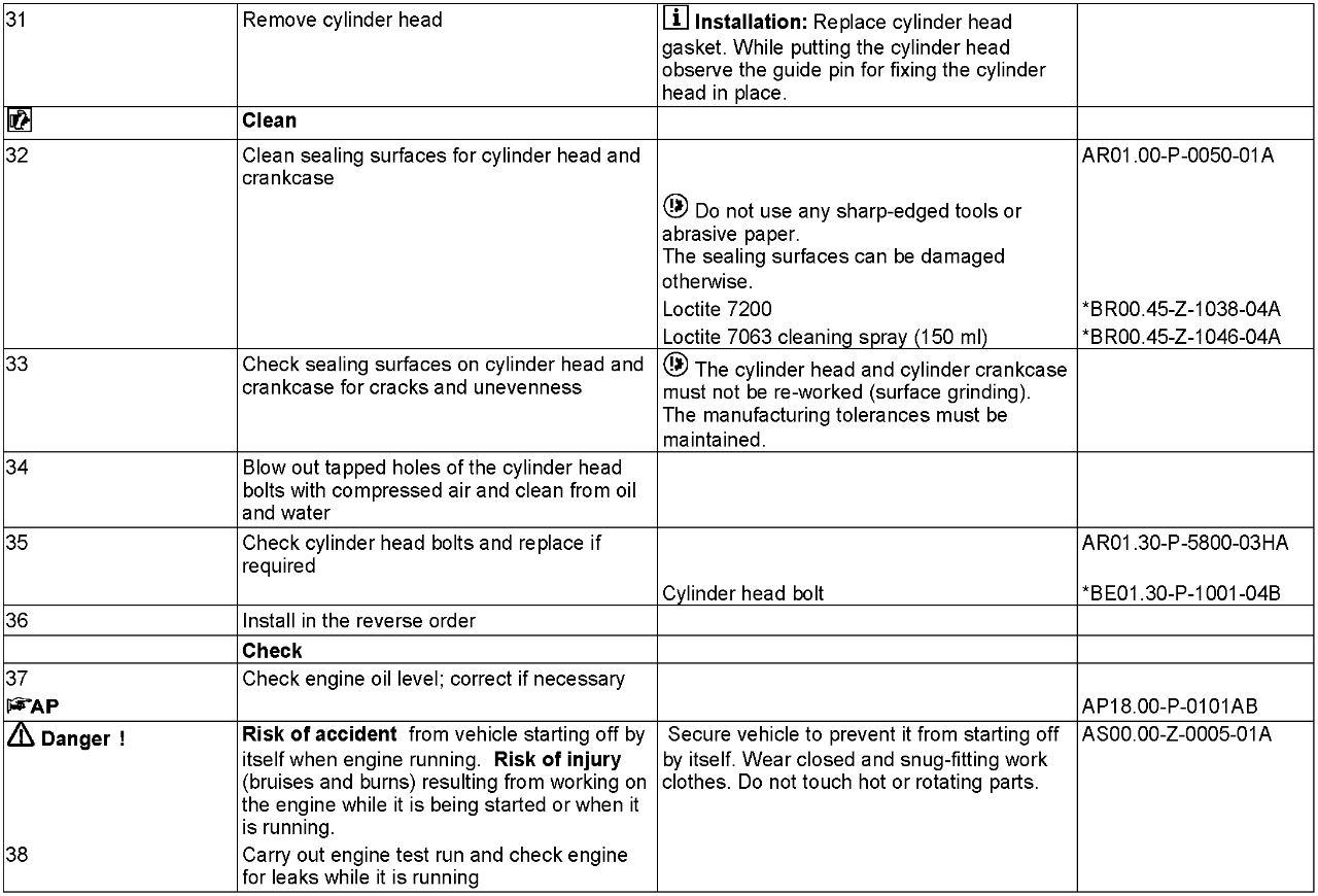

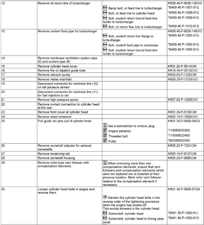

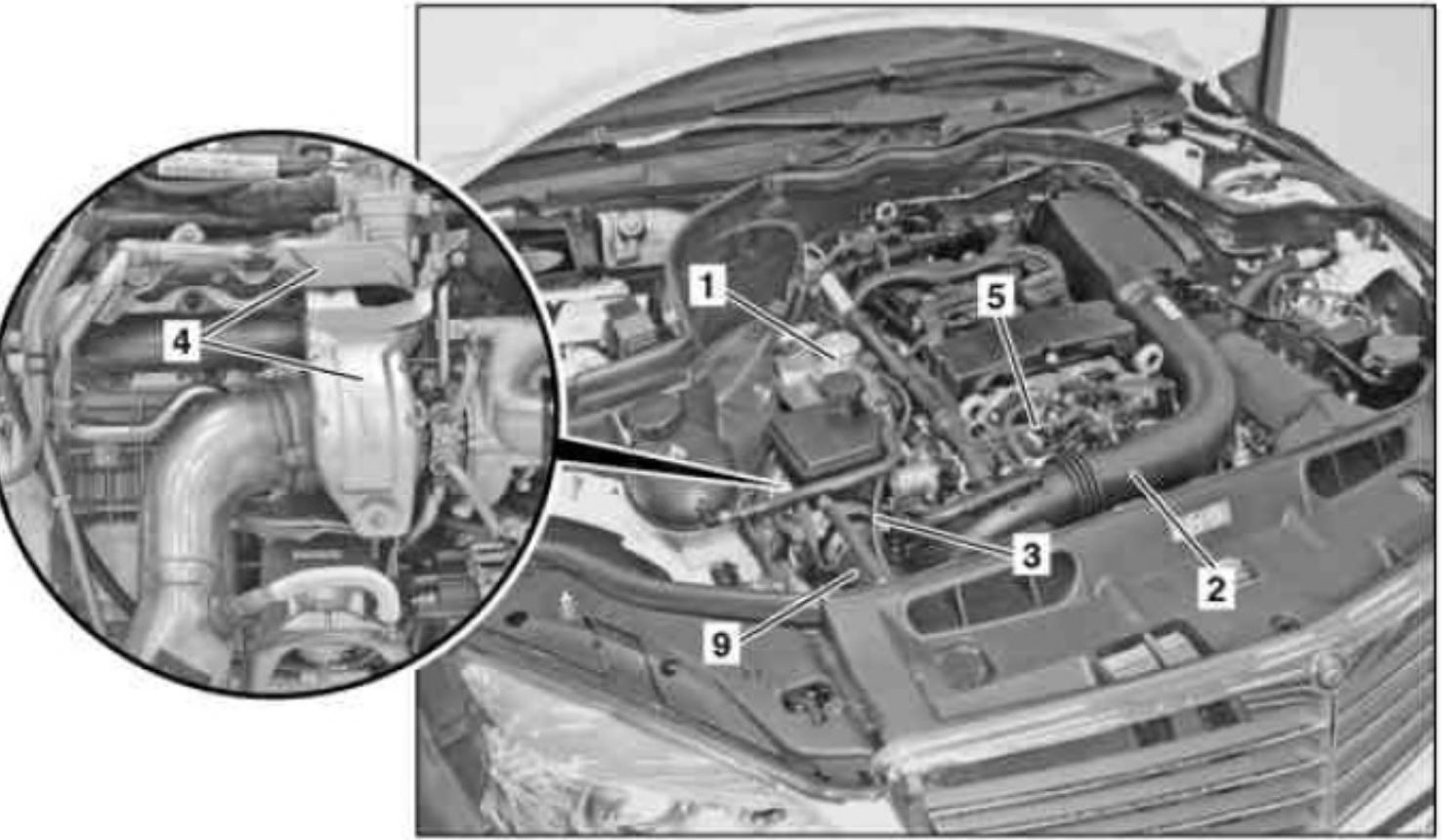

This is what the book has for this job.
Image 1
1 Combination valve
2 Air ducting
3 Vacuum hose
4 Shields
5 Boost pressure control hose
9 Charge air line

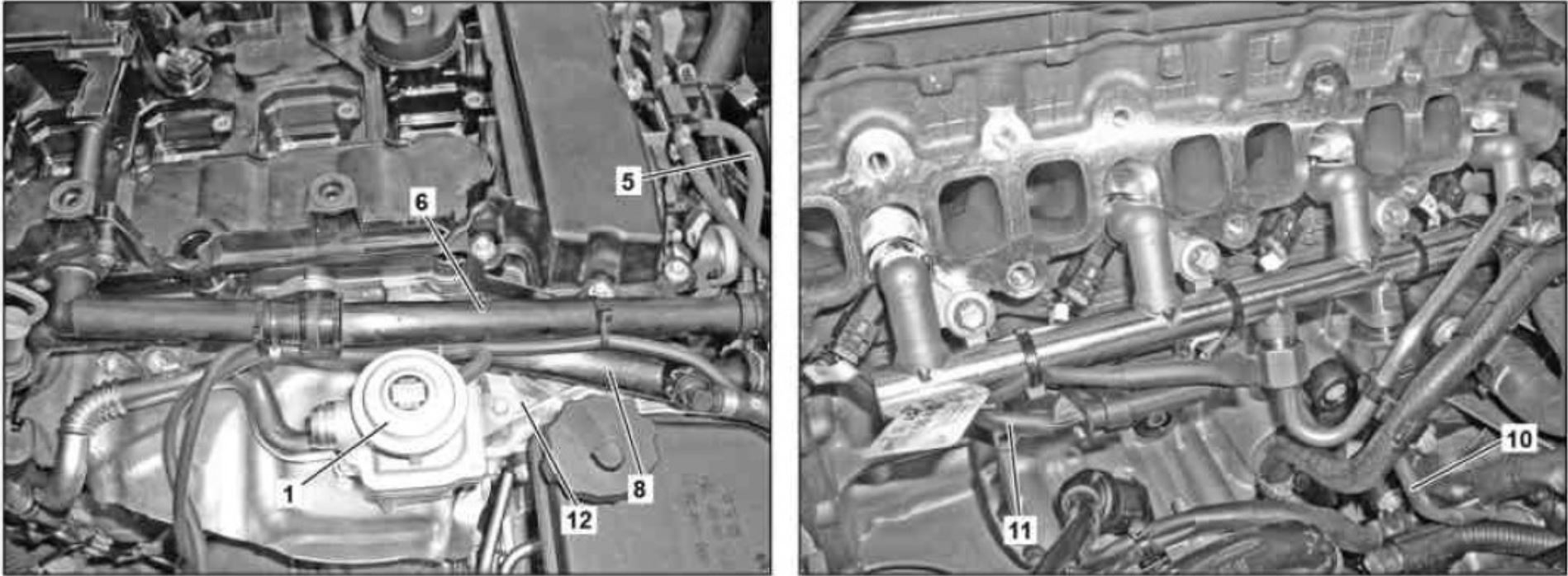

Image 2
1 Combination valve
6 Crankcase ventilation system pipe
8 Coolant pipe
10 Electrical line
11 Electrical line
12 Bracket

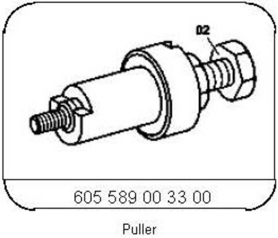

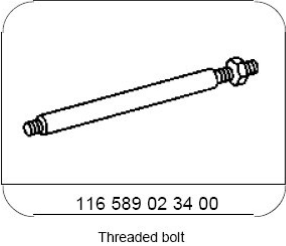

Images 3 thru 5 are the instructions for the head.
The tools are the special tools needed.

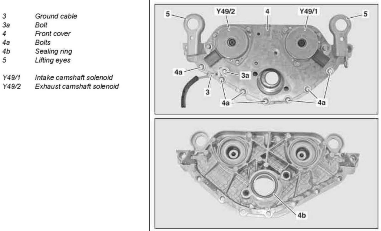

The other 3 images are for the front cover on the head.
