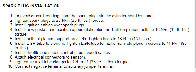

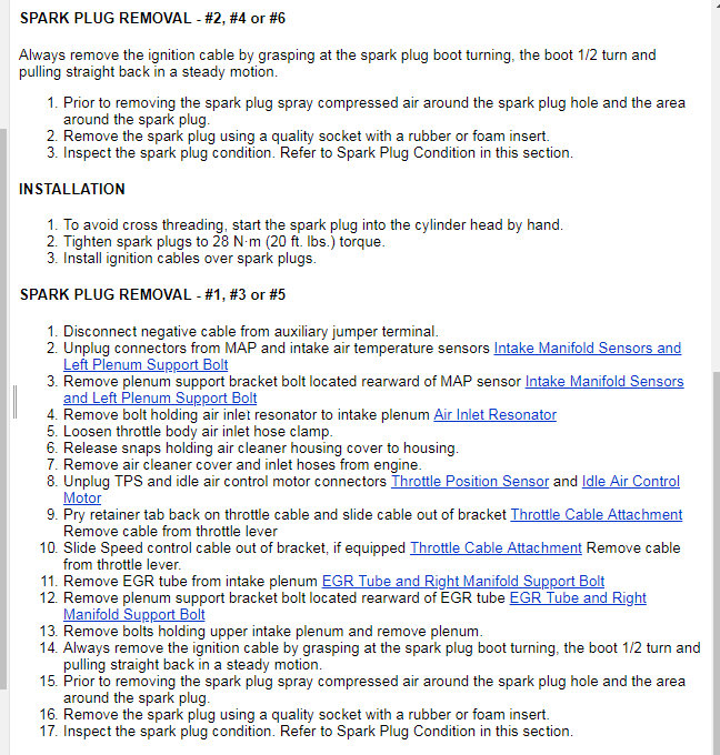

How do I change the back three spark plugs when you can't even see them?
Jul 13, 2019 at 10:12 PM
Hi Jamie,
Please see the attached documents. Unfortunately you need to remove the intake plenum in order to remove the plugs. Not the easiest job but if you take your time, it is doable.
Let me know if you have questions. Thanks

It's impossible to see the back three spark plugs you can't even see the spark plug wires the only way to take out the spark plugs on the back three is t'pol the intake manifold.
