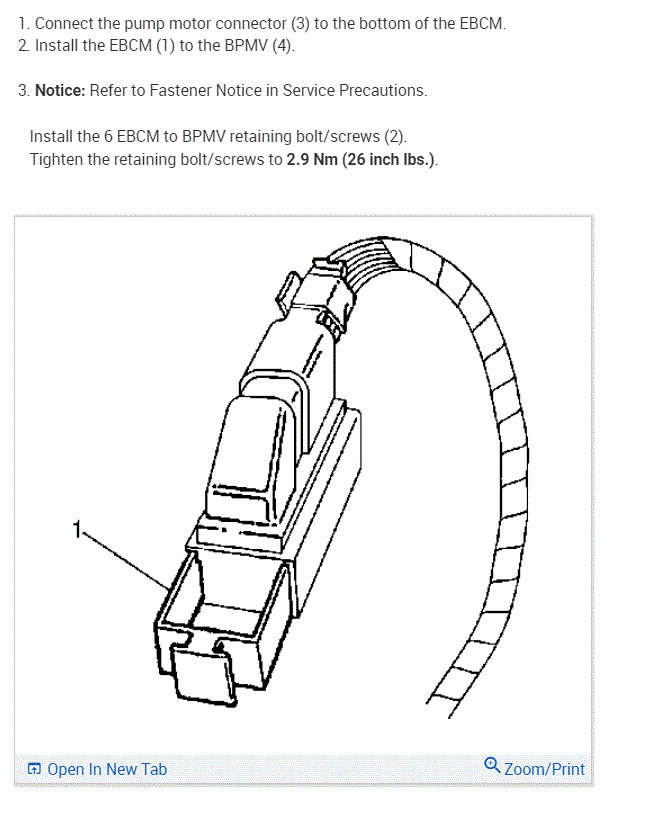

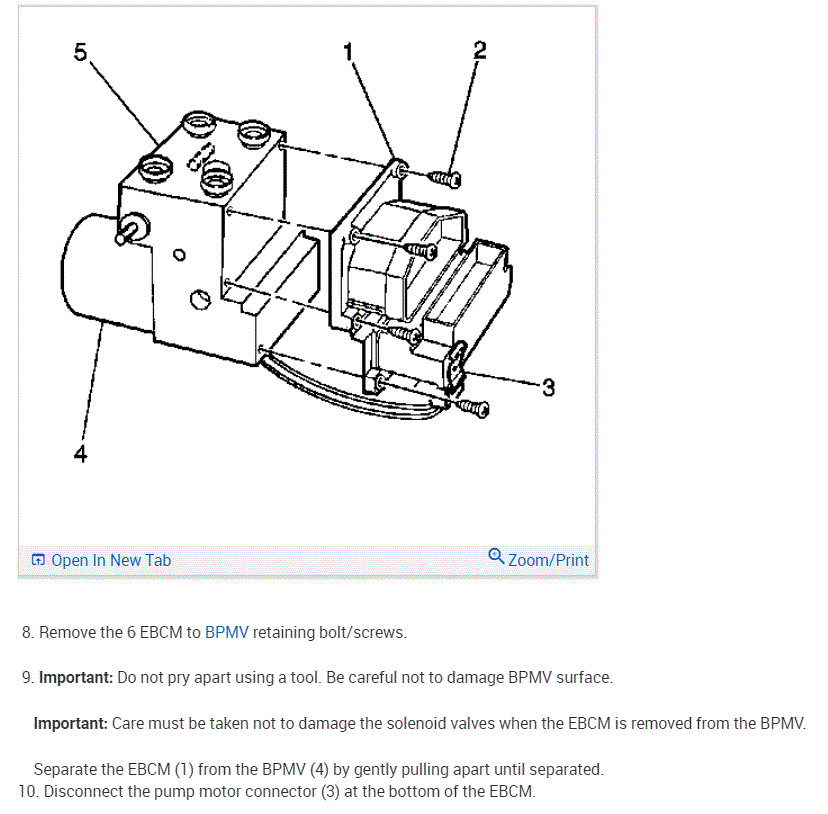

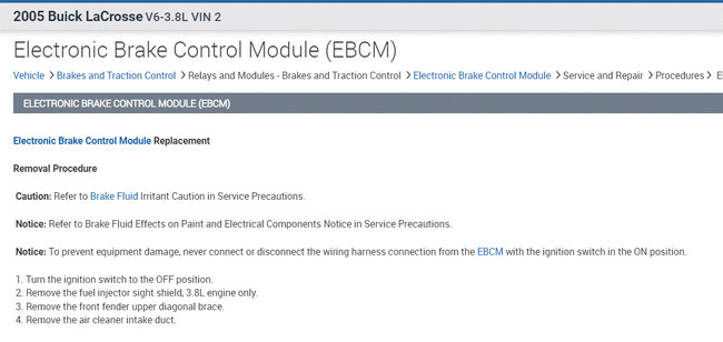

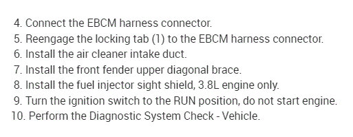

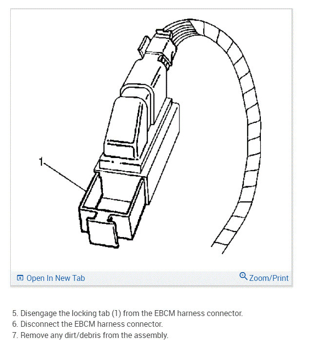

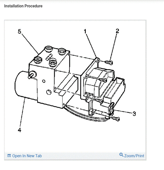

How do you change the ABS control module on the car listed above? i see that it is a few bolts holding everything together, if i remove the old one and put the new one on, is there anything else after that, that i would have to do?
Apr 13, 2022 at 3:35 AM
  • 110,248 POSTS
Replacing the electronic brake control module (EBCM) will take a little time. When you do it, it is extremely important to keep everything clean and to avoid getting dirt in the system.
If you look below, I attached the directions. Take a look through them and let me know if you have questions.
