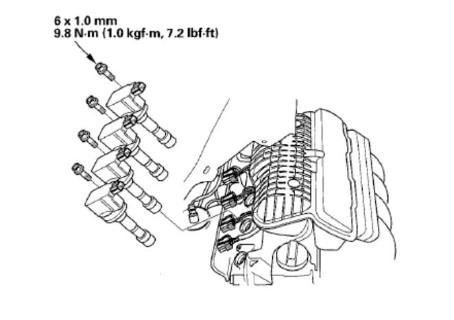

how to I get to the spark plugs???

we dont' have the Jazz model in U.S. but yours should be similar to the pic I'm sending. you have to gain access to coils disconnect electrical take coils out then spark plugs.
