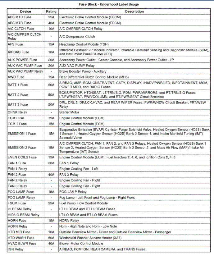

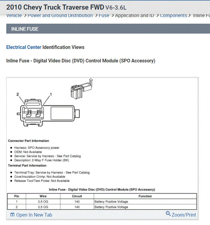

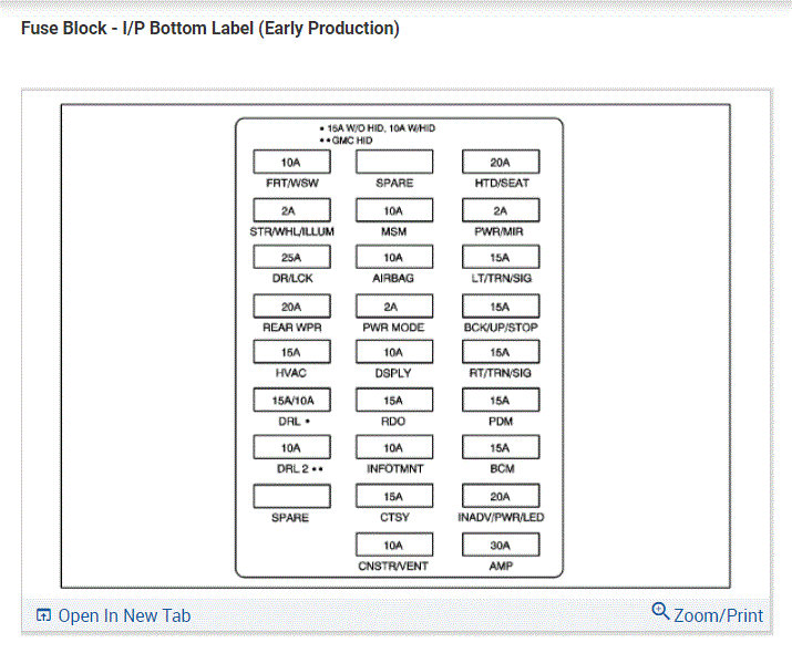

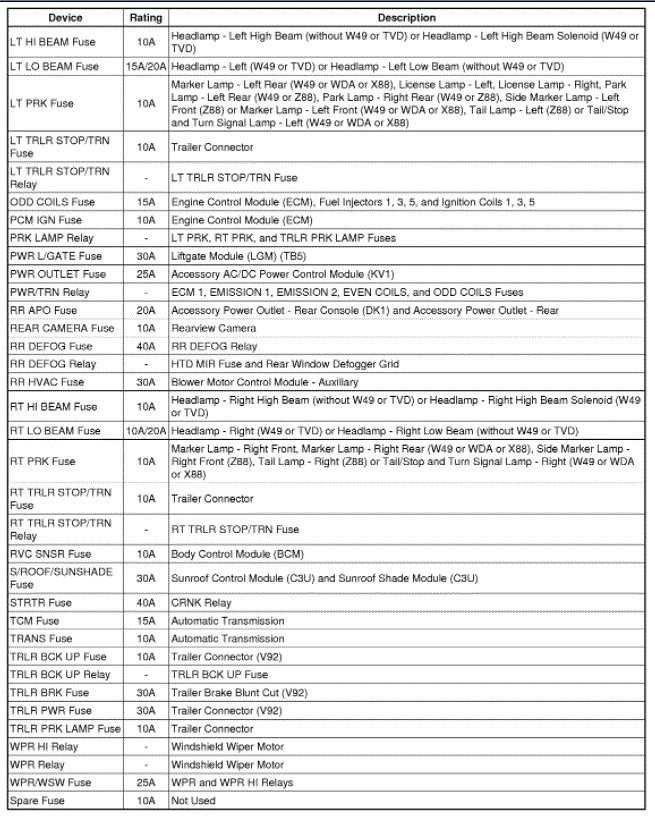

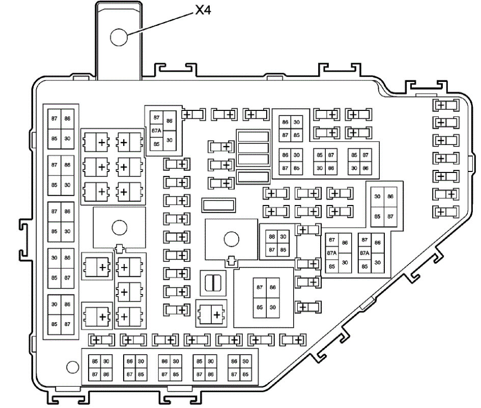

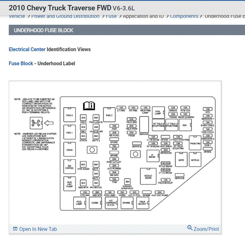

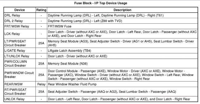

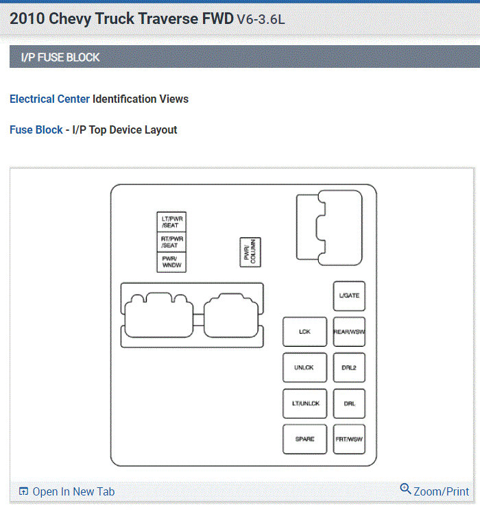

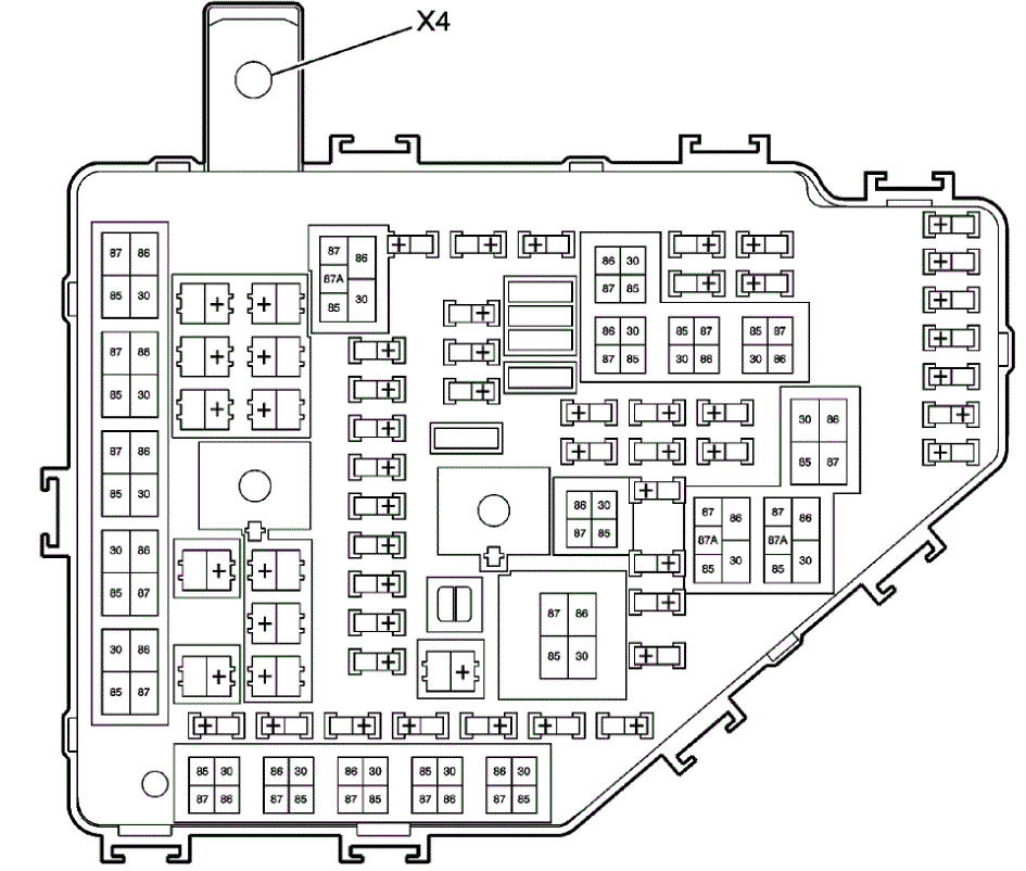

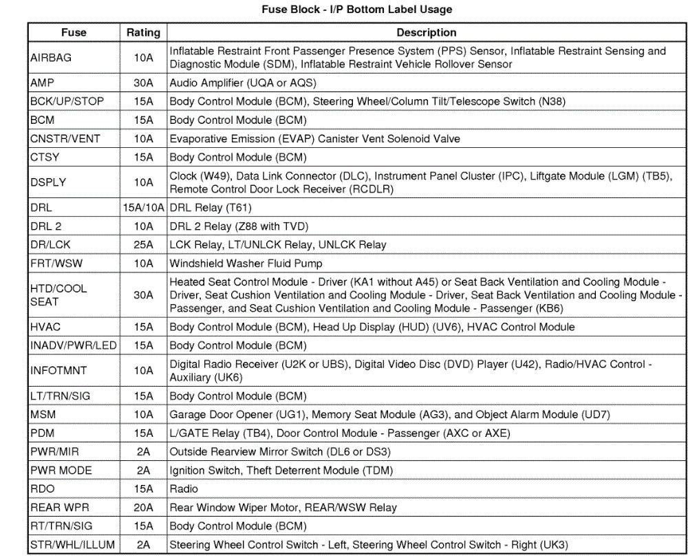

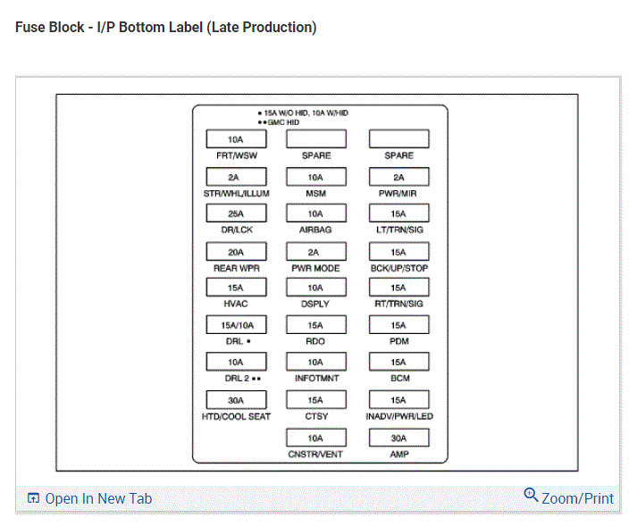

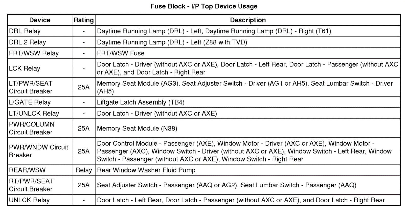

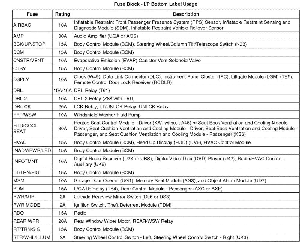

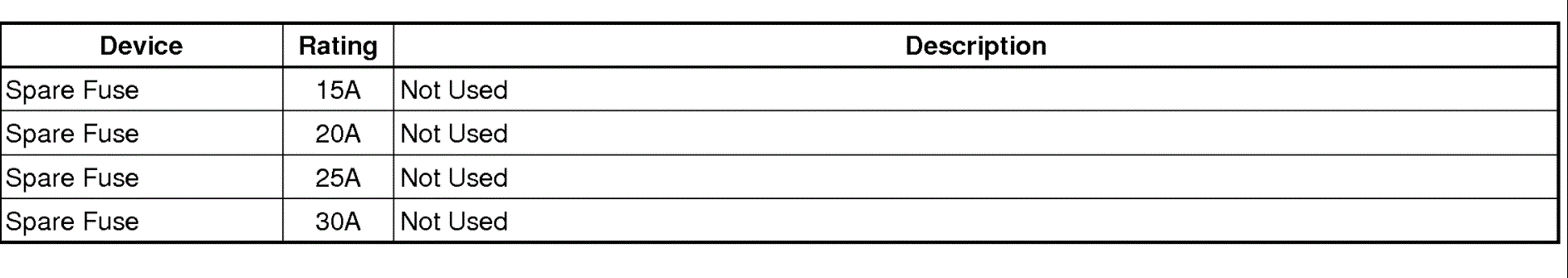

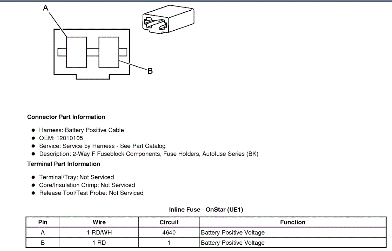

How to check the fuses I cant find them can you help me please?
Jun 29, 2013 at 11:26 AM
Experienced Mechanic
110,246 POSTS
If you look at the attachments below, they provide the fuse box orientations and what each fuse is for.
In addition to just checking a fuse, make sure there is power to it. A fuse may be good and not be receiving power.
Here is a link that you may find helpful when testing:
I hope this helps. Let me know if you have additional questions.
