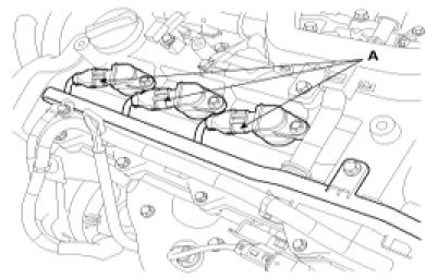

Need to change fouled plug on cylinder number one.

Here is a link that explains how to tune up a vehicle. If you skip down to step 6, it explains how to remove coils and plugs. Please remember, the wiring going to each coil is for that cylinder. Don't mix them up.
https://www.2carpros.com/articles/how-to-tune-up-a-car-engine
Here are the directions specific to your vehicle. The attached pictures correlate with the directions.
2008 Kia Rondo V6-2.7L
Removal and Replacement
Vehicle Powertrain Management Ignition System Spark Plug Service and Repair Removal and Replacement
REMOVAL AND REPLACEMENT
REPLACEMENT
SPARK PLUG
1. Remove the ignition coil connector(A).
pic 1
2. Remove the ignition coil.

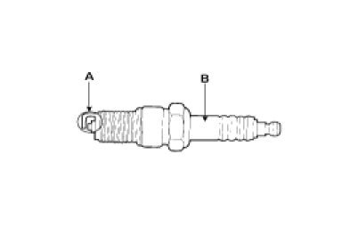

ON-VEHICLE INSPECTION
INSPECT SPARK PLUG
1. Inspect the electrodes(A) an ceramic insulator(B).

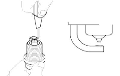

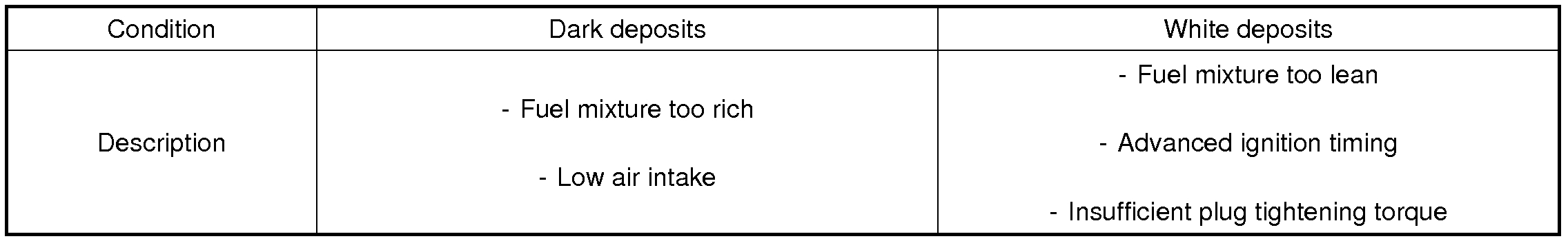

INSPECTION OF ELECTRODES
pic 3

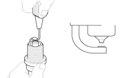

2. Check the electrode gap (A).
Standard : 1.0 - 1.1 mm (0.0394 - 0.0433 in.)
pic 4
