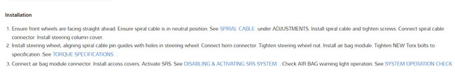

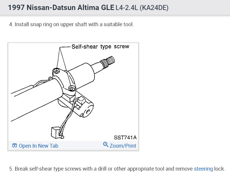

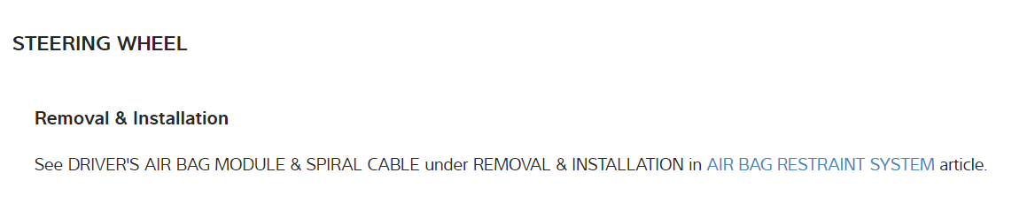

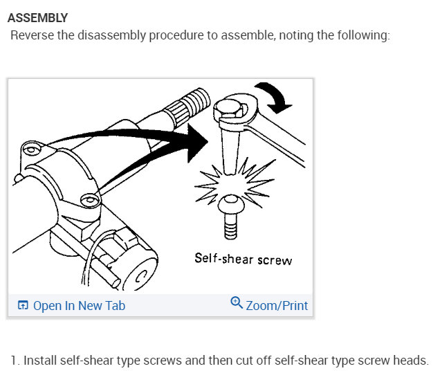

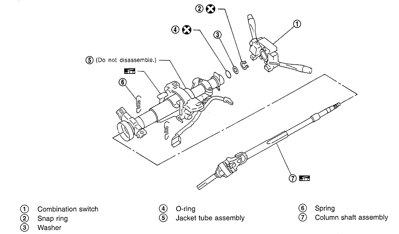

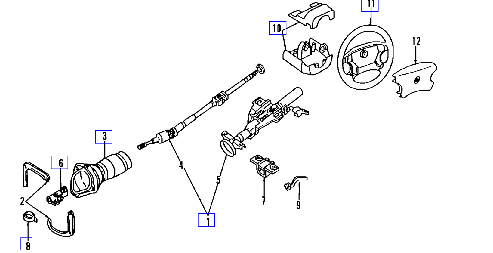

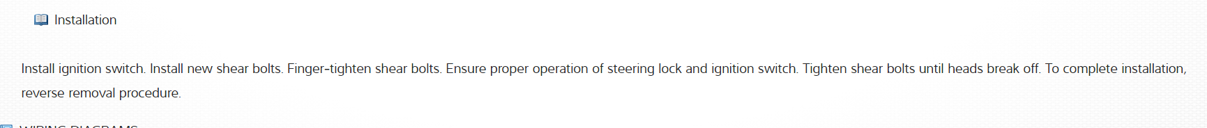

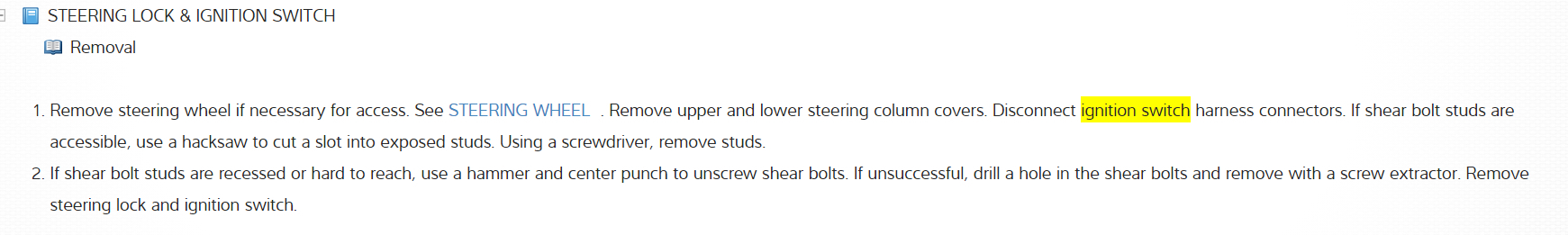

Hi, I need to know how to remove my electrical starter switch and how do I put on a new one?

I have included the instructions you requested in the diagrams down below.

Here are the diagrams and instructions you will need to change out the ignition switch. Check out the diagrams (below). Please let us know if you need anything else to get the problem fixed.
