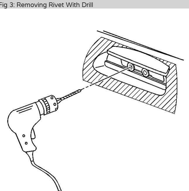

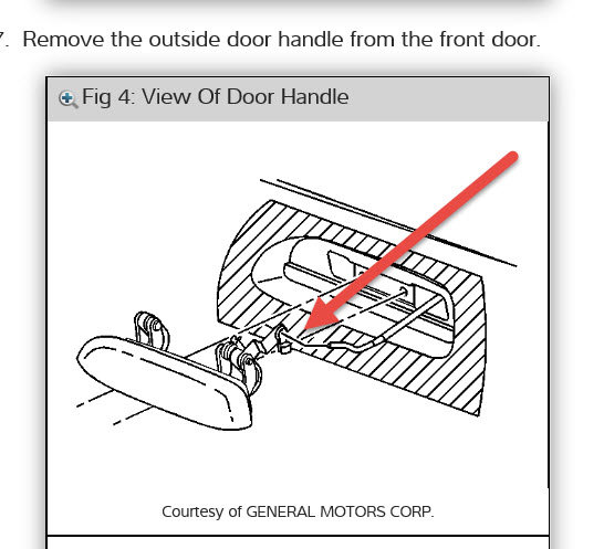

Need to change driver door handle on my car. How do I do this?
Sep 6, 2016 at 7:27 AM
HMAC300
  • 48,601 POSTS
these are riveted on you may need to pull inside trim panel. they need to be drilled out then clip turned to unhook from rod. reverse for reassembly. you will need a rivet gun to do this.
