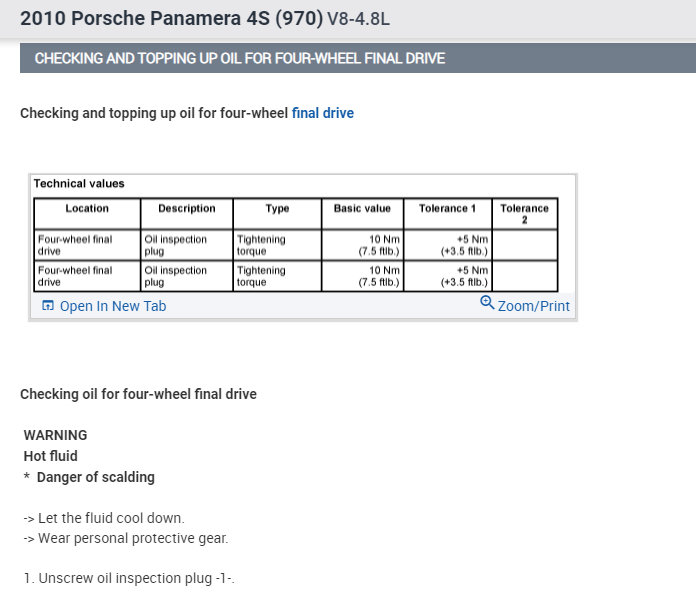

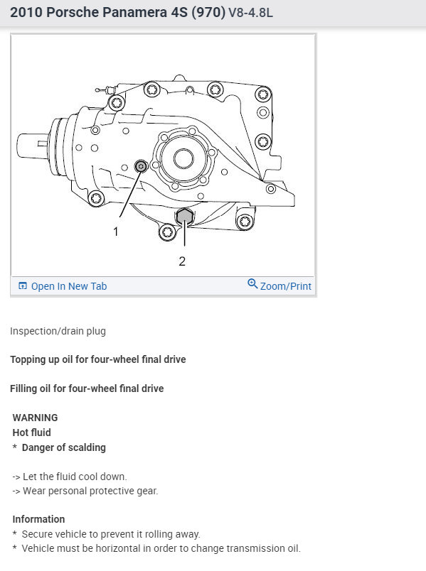

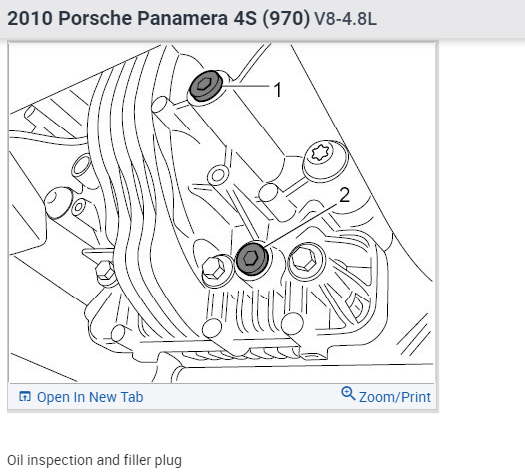

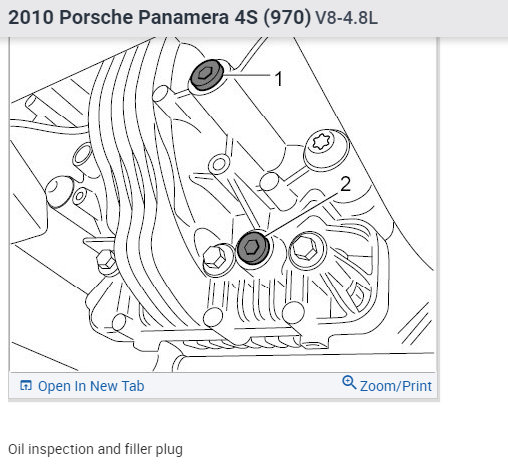

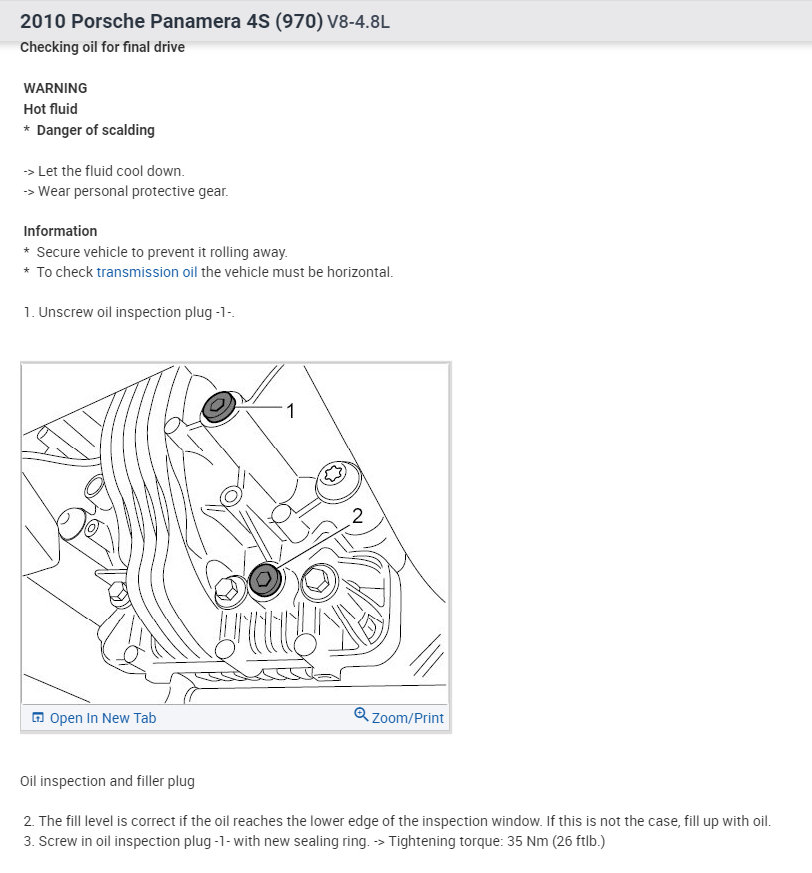

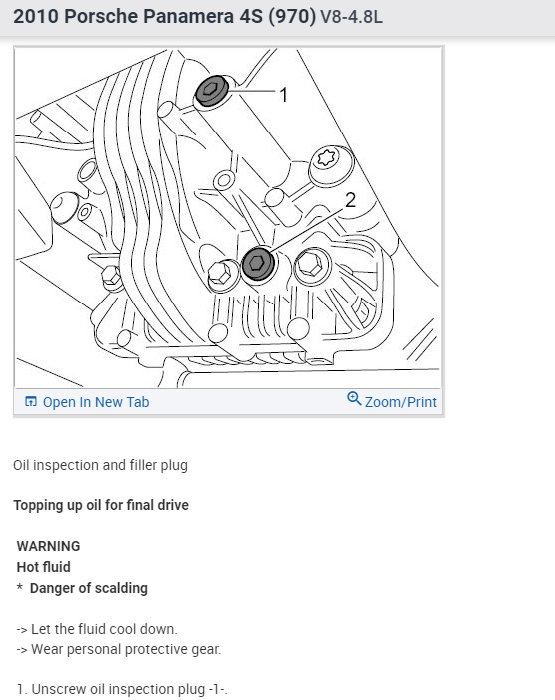

How to change differential fluid?
2010 PORSCHE PANAMERA
86,000 MILES • V8 • 4WD • AUTOMATIC
DIVIDES
  • 903 POSTS

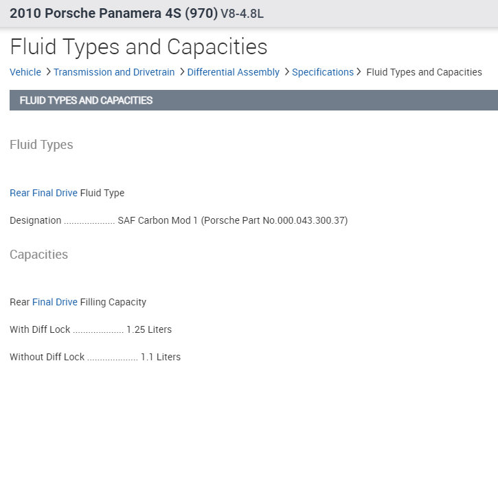

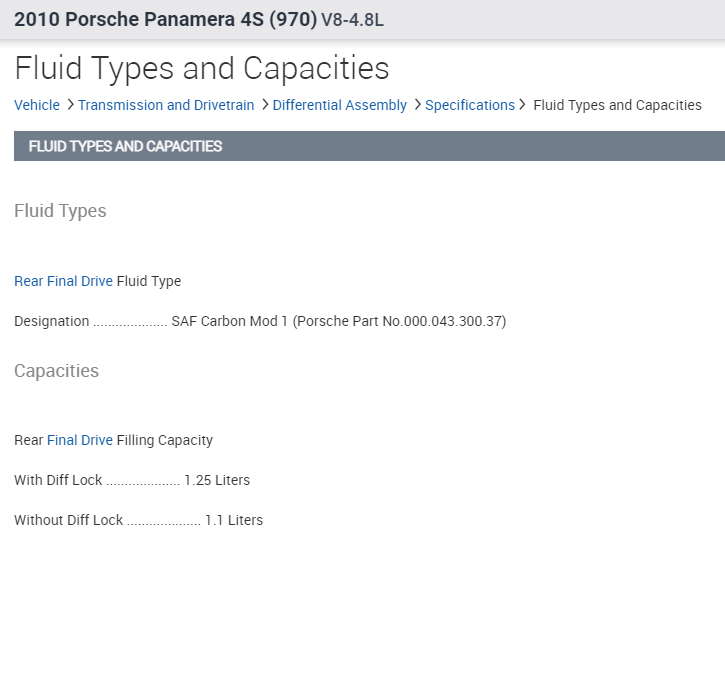

And what the book says the type of fluid is please.
Jan 8, 2022 at 6:06 PM
SQM
  • 6,383 POSTS

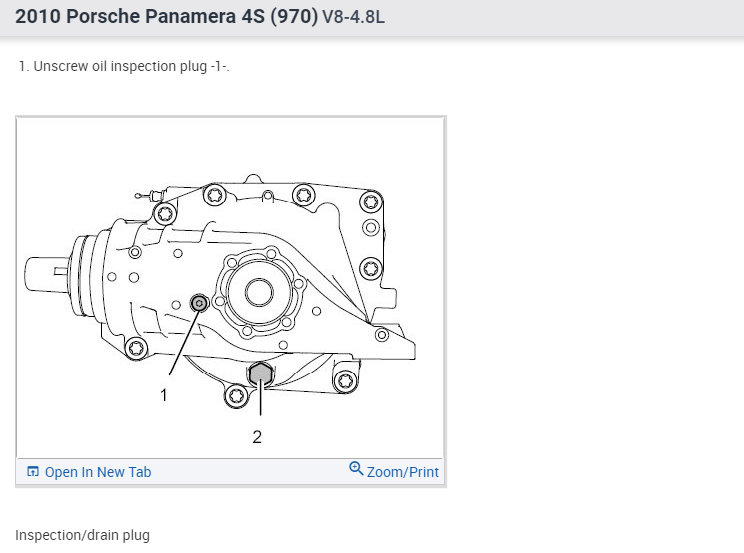

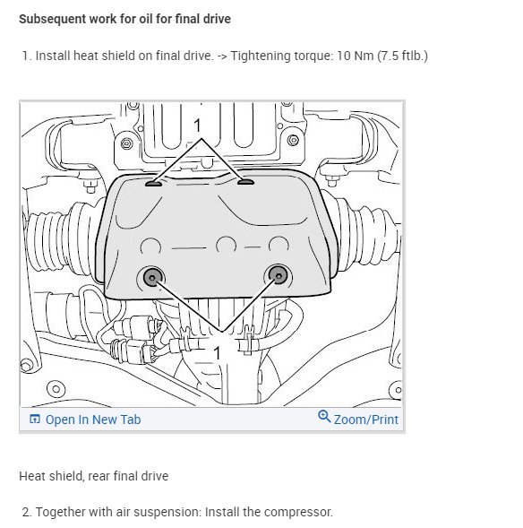

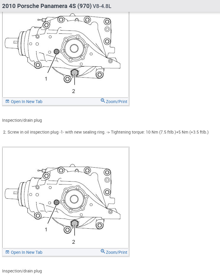

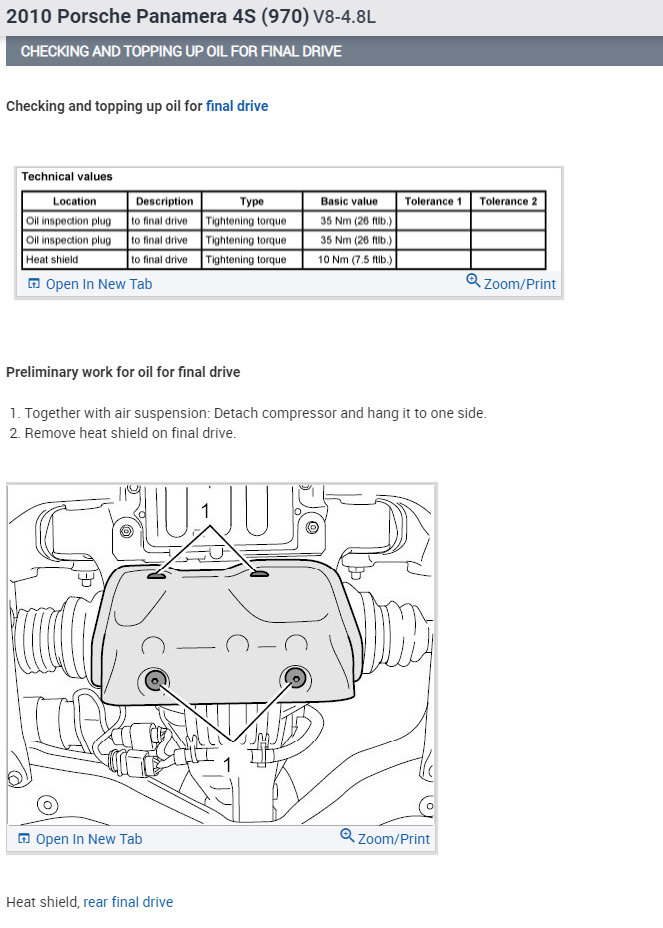

It calls for SAF Carbon Mod 1 (Porsche Part No.000.043.300.37).
I have attached the procedure for both front and the rear below.
Let me know if you have any questions.
