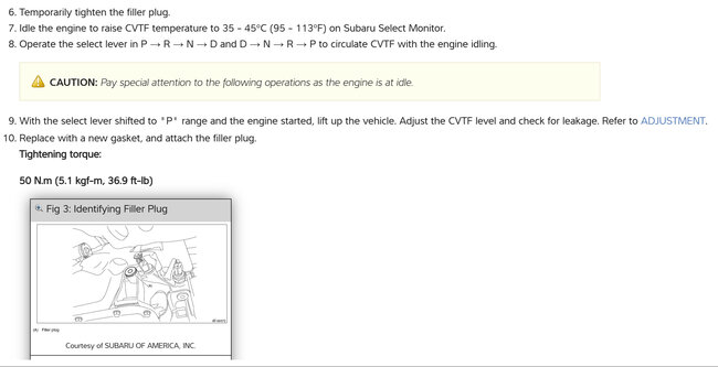

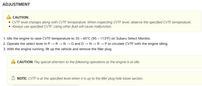

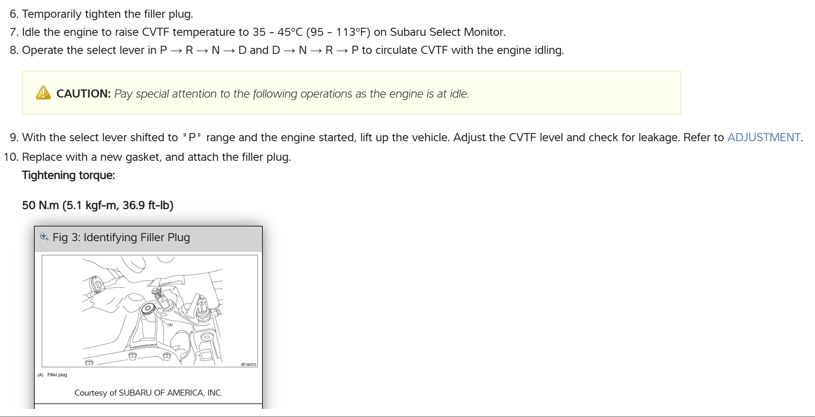

And if you know what temperature to wait until before opening the fill plug again while its running.
May 29, 2023 at 4:31 PM
BRENDON S
  • 653 POSTS

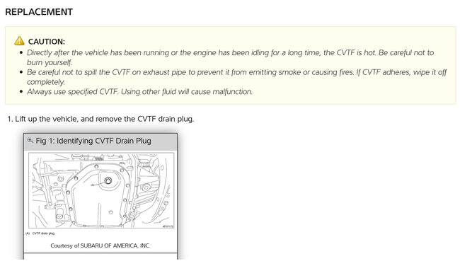

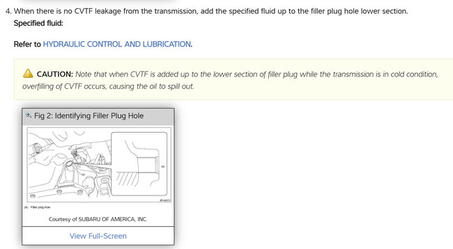

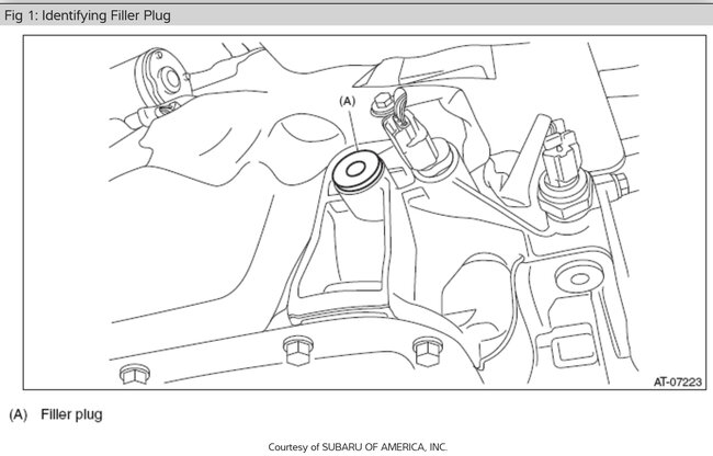

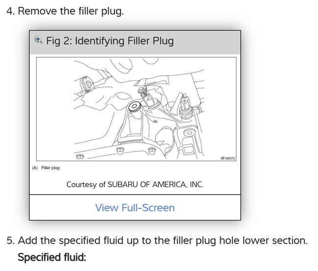

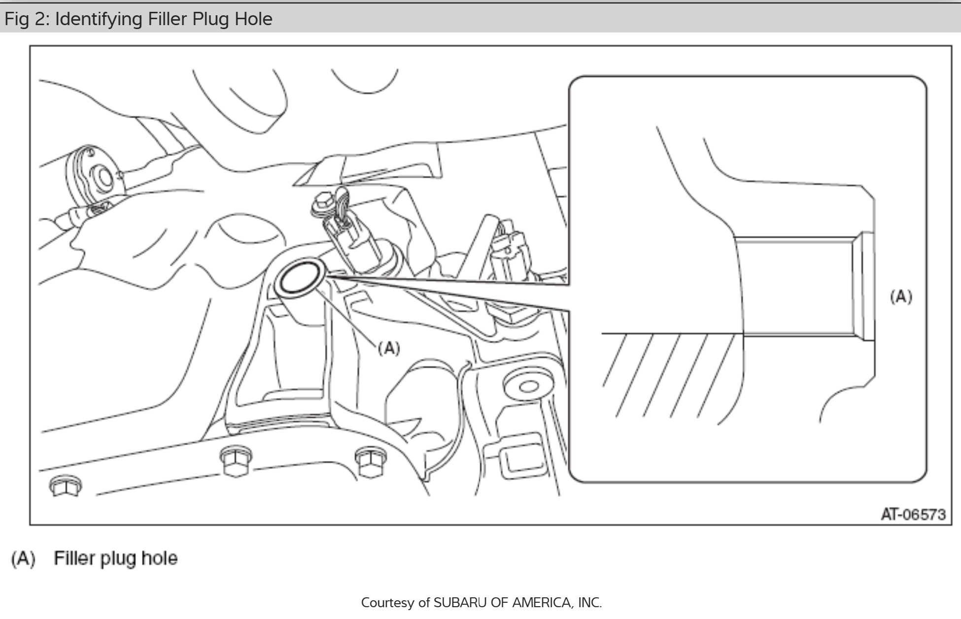

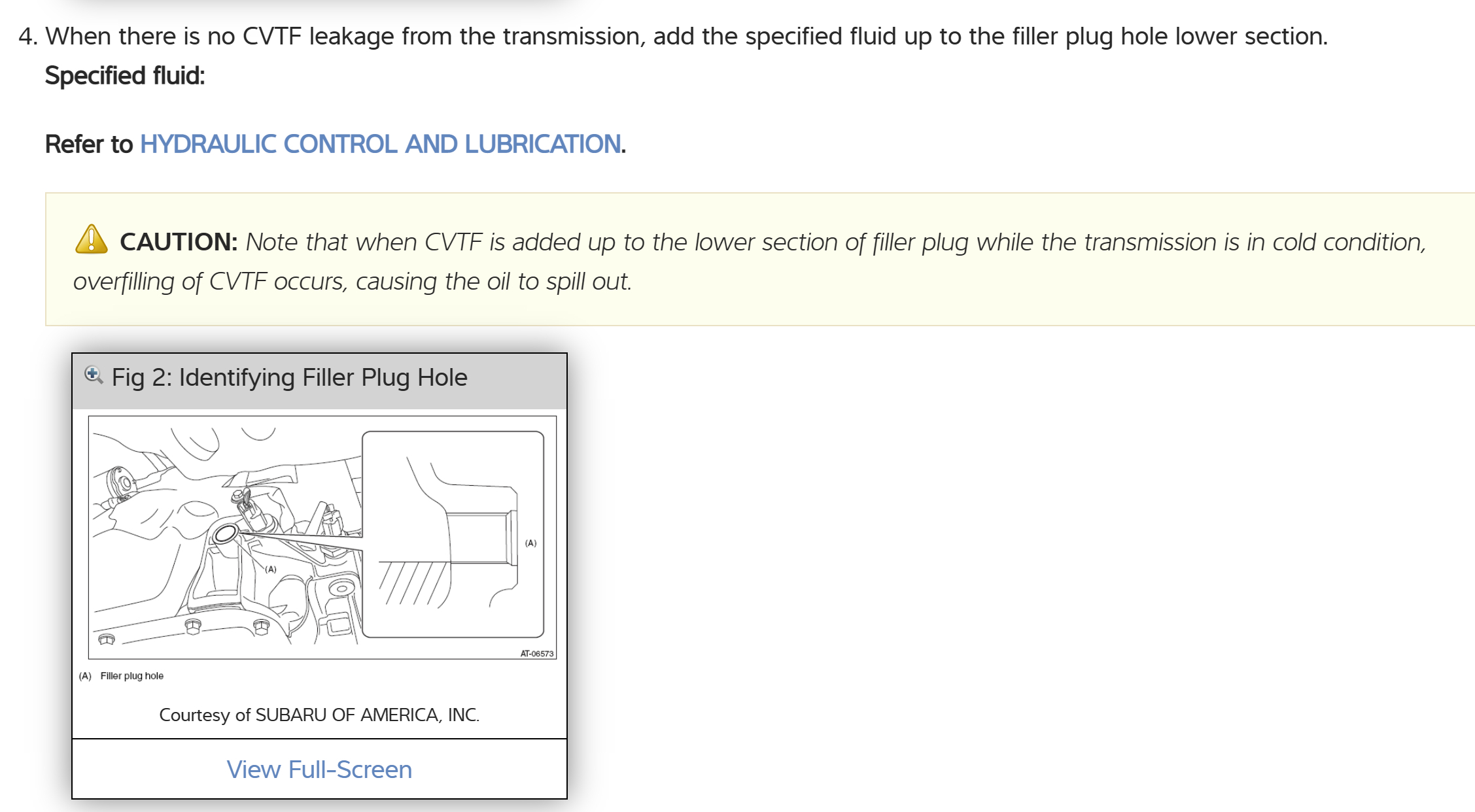

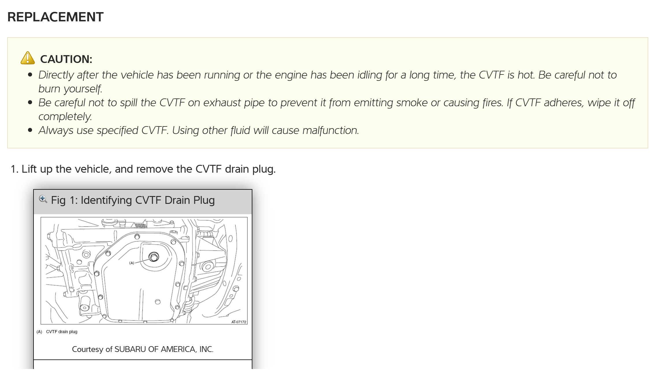

Hello again, BHAMDOC1973,

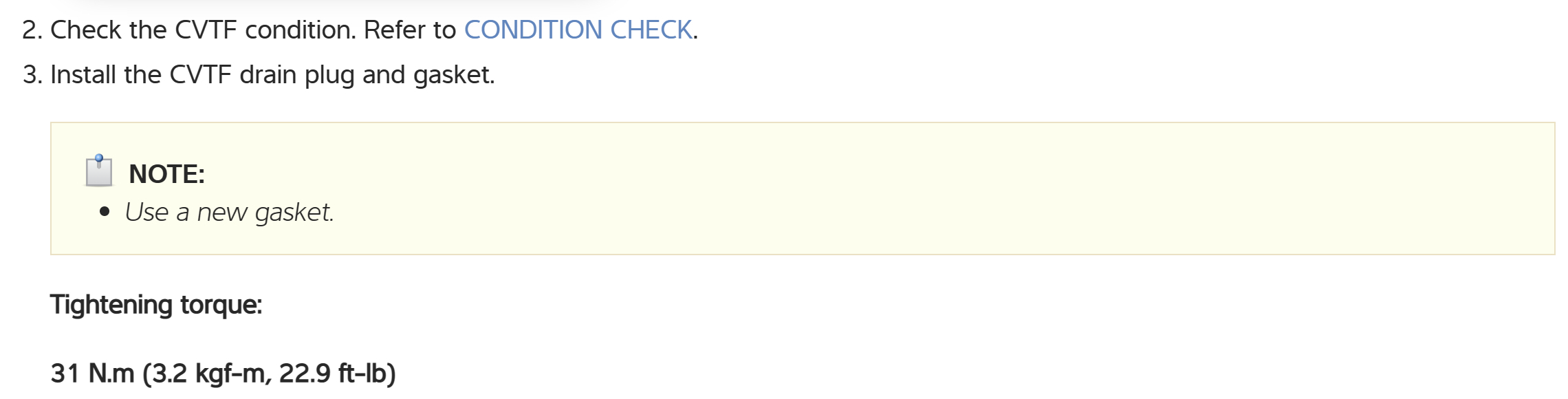

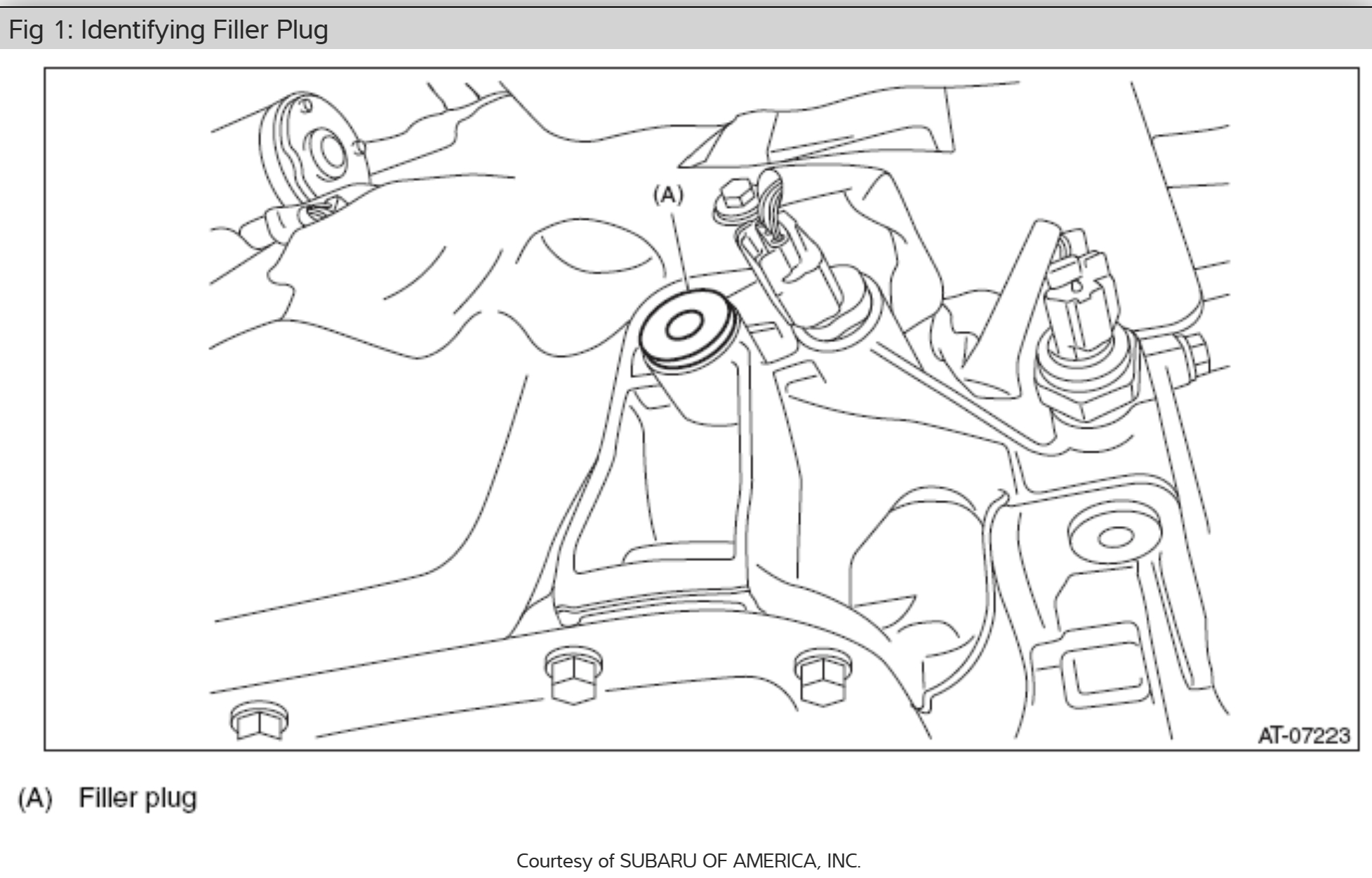

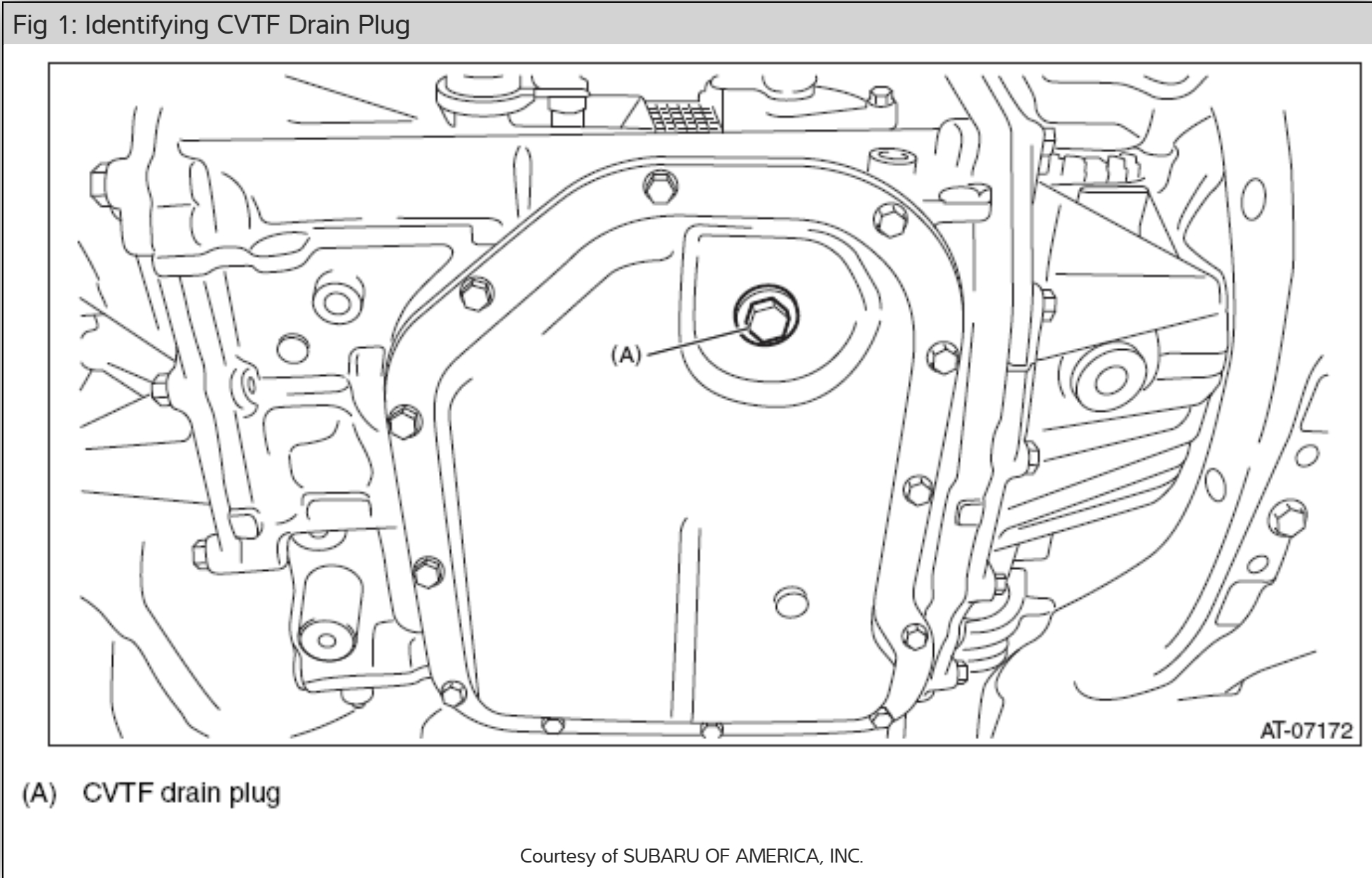

You will need to have a scan tool capable of measuring the transmission temperature. Once it reaches between 95-113 degrees Fahrenheit, you will have to shift through the gears and then adjust the fluid level to the bottom of the fill hole.

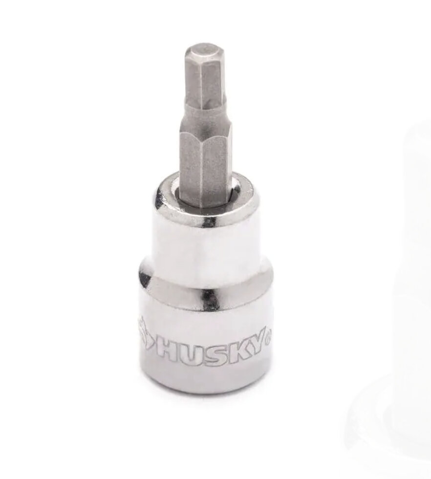

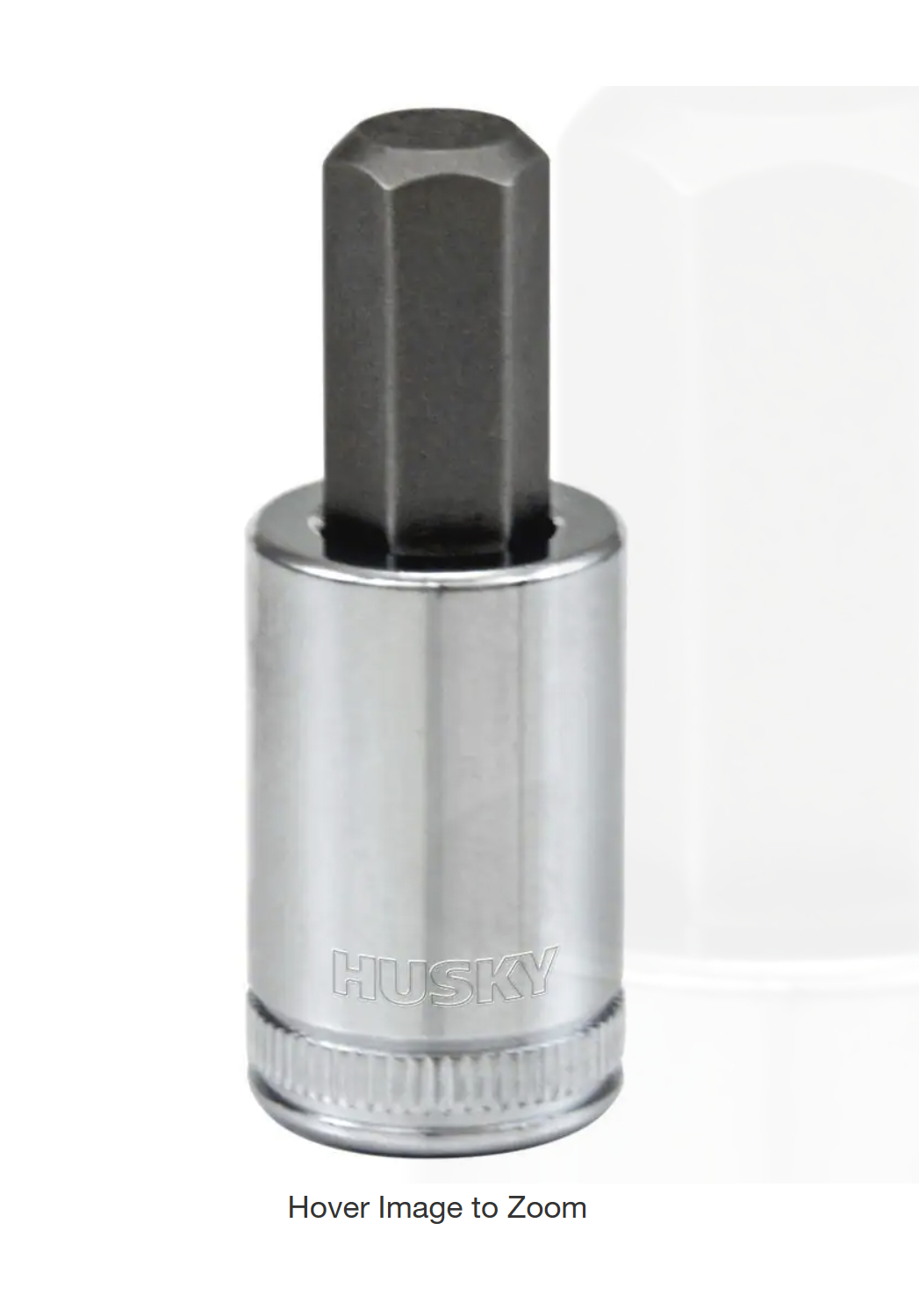

Some tools that you will need:
8mm Hex bit socket (drain plug)
10mm Hex bit socket (fill plug)
Hand pump
I will add images of these items for you as well as instructions on how to change and adjust the fluid.

The images of the Hex sockets I have added are from Husky which can be found right at Home Depot or on their site.

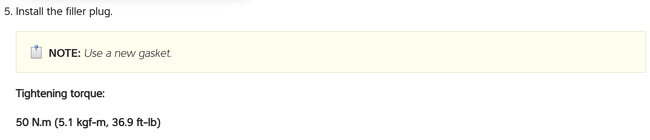

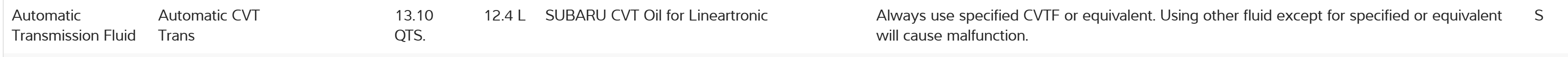

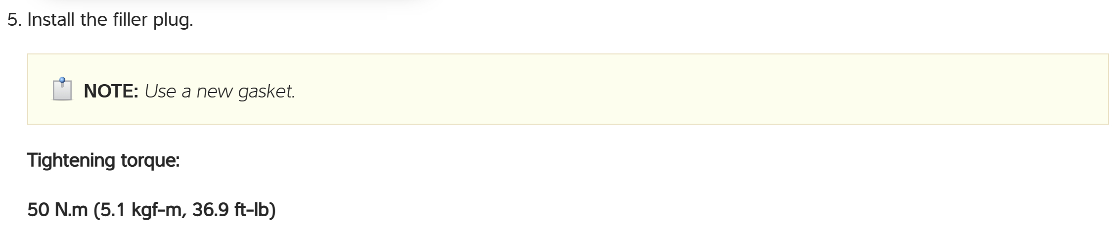

I would recommend getting the fluid directly from the dealer as well as a new fill plug gasket.
Also putting a couple pieces of 2x6 lumber under the rear wheels will help the vehicle be more level when you have it up on jackstands helping to ensure the fluid is at the right amount.
Let me know if I can give you any more information.
