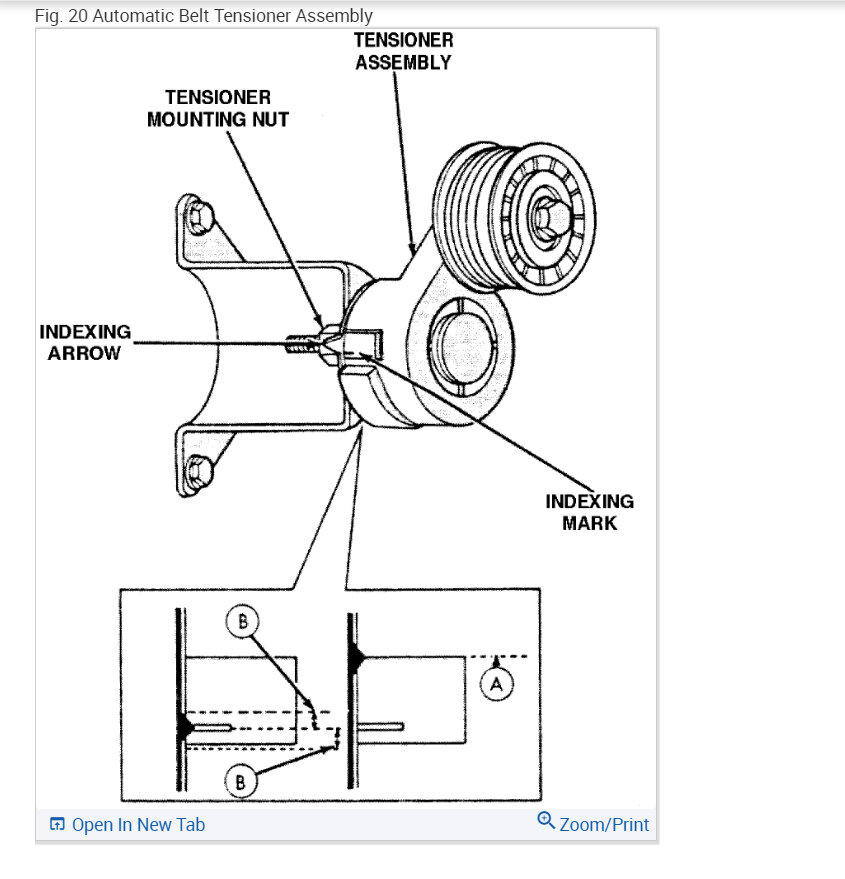

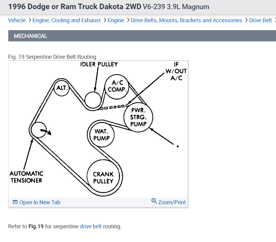

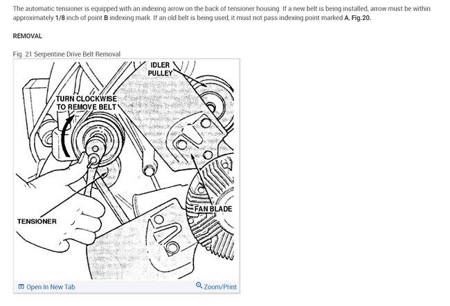

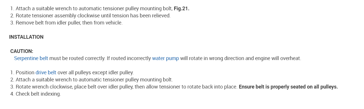

How to get the tensioner loose so the belt will come off?
Dec 10, 2022 at 6:55 PM
  • 55,781 POSTS
Here is a generic guide to help walk you through the steps and I have included the belt diagrams and how the tensioner is released in the diagrams below:
Check out the images (below). Please let us know if you need anything else to get the problem fixed.
