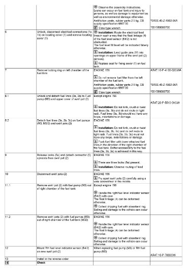

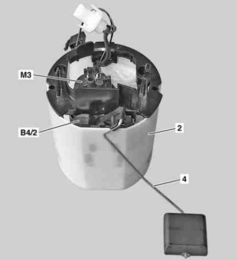

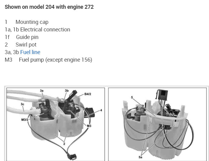

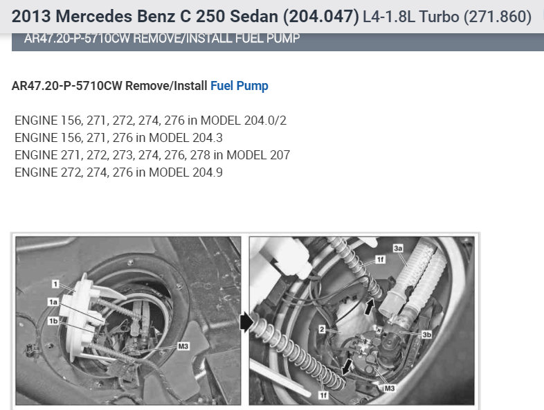

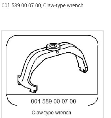

Hello, I'm Danny.

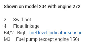

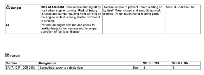

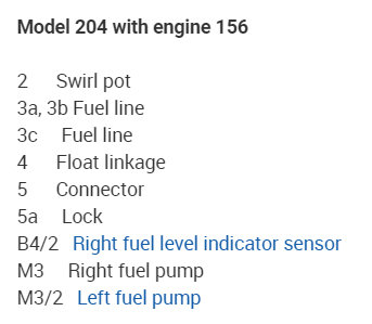

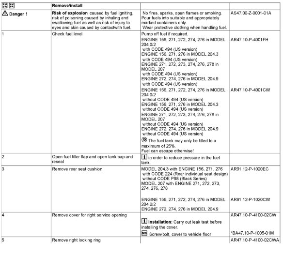

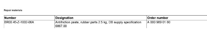

Here is a basic tutorial for you to look at involving an in tank fuel pump replacement:
https://www.2carpros.com/articles/how-to-replace-an-electric-fuel-pump
I've attached step by step picture instructions below for your vehicle.Hope this helps and thanks for using 2CarPros.

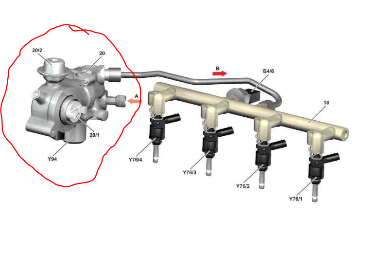

Sorry, but I wanted the high pressure fuel pump it’s attached to the the engine not the electric pump in the gas tank.

Hello again.
I've attached a picture below.I'm searching for instructions for you.Is your vehicle a diesel by any chance? Thanks again for using 2CarPros.
