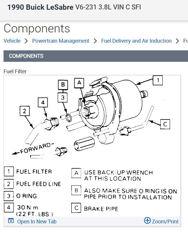

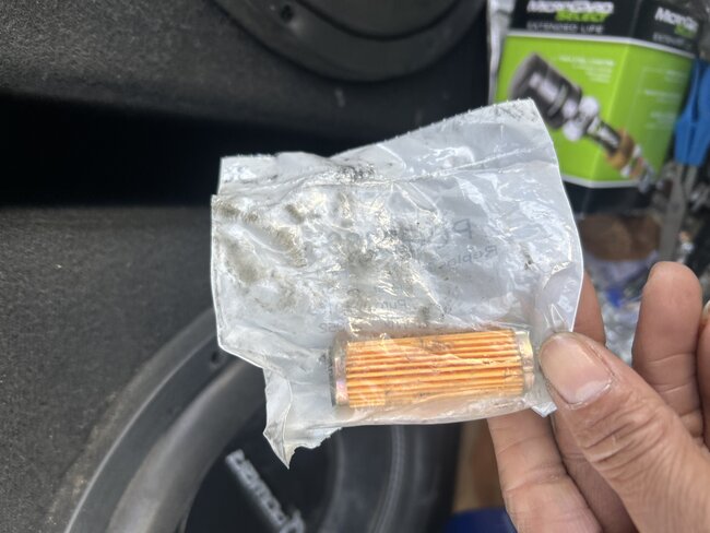

This is the fuel filter. I was told to change this first then I will be able to know if it’s my fuel pump or not.

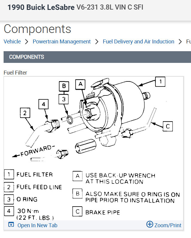

Hmm,, that is not the correct fuel filter, here is what it looks like which is located under the car. Check out the images (below). Let us know if you need anything else.
