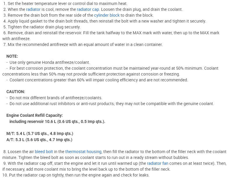

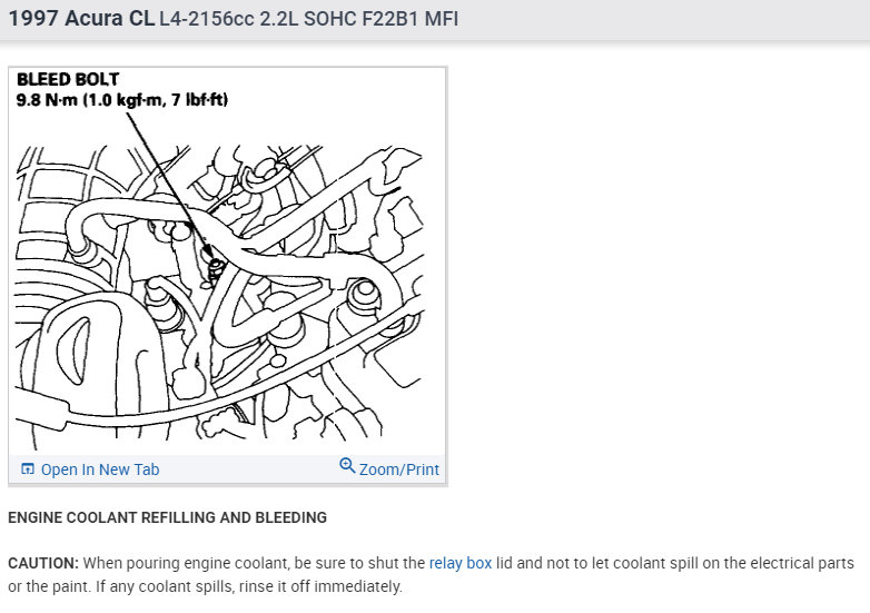

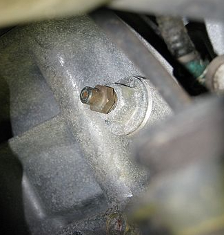

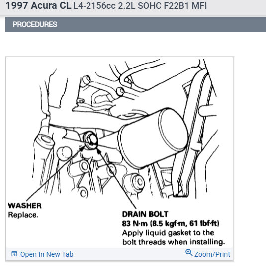

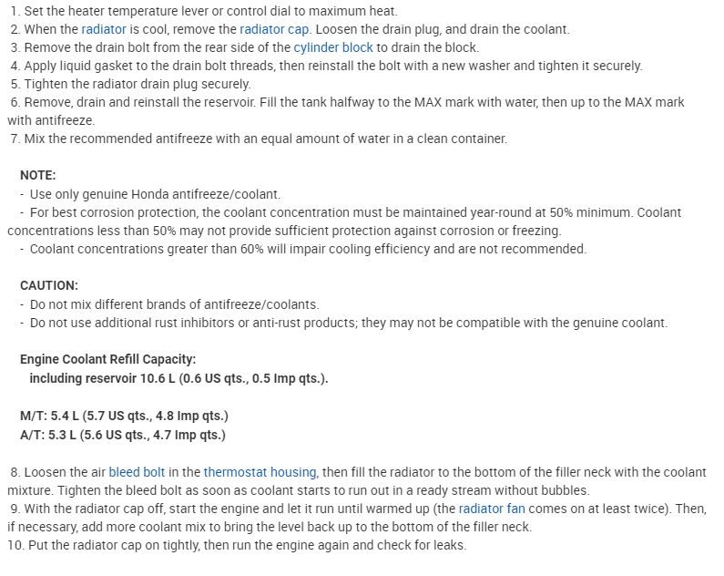

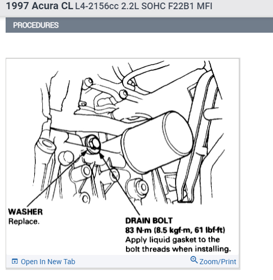

cannot locate the bleeder bolt to bleed anti-freeze.
Oct 28, 2021 at 3:43 AM
SQM
Experienced Mechanic
6,383 POSTS
The bleed bolt is located rear side of the cylinder block. I have attached the procedure below.
https://www.2carpros.com/articles/coolant-flush-and-refill-all-cars
