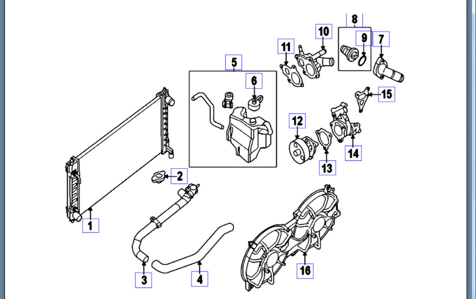

Also where is the coolant reservoir located?
Nov 25, 2020 at 1:35 PM

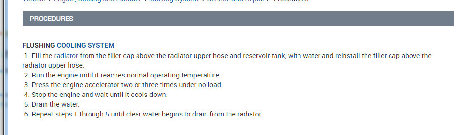

There is no "bleed" procedure for this vehicle. Basically it tells you to fill the radiator, run the vehicle until the thermostat opens, then flush the fluid if needed. However, once it is open you top off the radiator.
https://www.2carpros.com/articles/coolant-flush-and-refill-all-cars

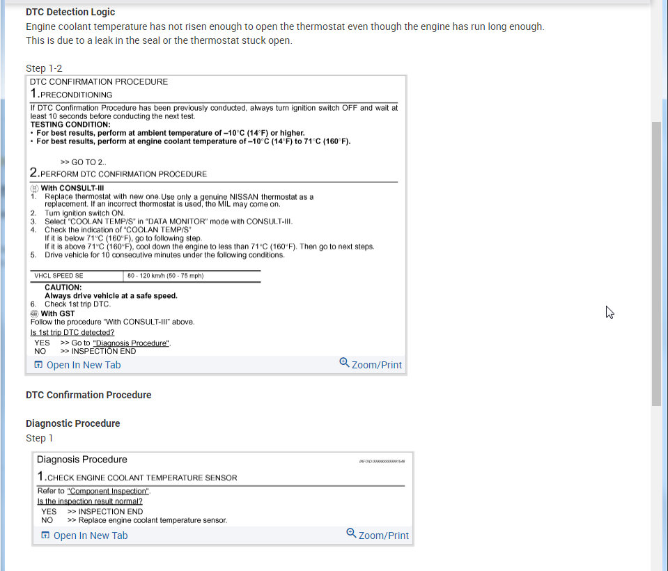

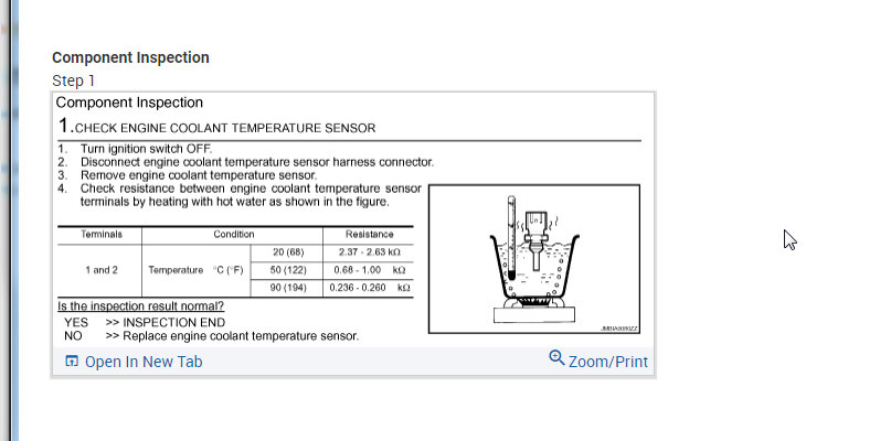

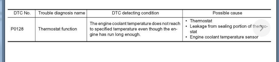

As for this code, are you sure this is new since you replaced these parts? If it is then you still have an issue because this code is telling you that the engine temperature is not high enough even though it has run enough to be hot. Basically there is a timer in the PCM that expects to see a certain temp after a certain amount of time. When it doesn't then it sets this code.
That could be due to a stuck thermostat open or a temp sensor. Since these are new, and if this code is new, I suspect one of them is defective.
I attached the testing so that you can run through it and see which it is.

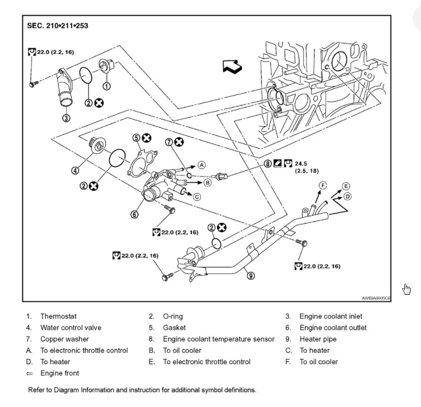

As for the reservoir it is in the box of this exploded view.

You are welcome. If the code did not return, then I would fill the system and rev the engine a few times to make sure there are not air pockets and then start driving it. Check the coolant level after the first couple of trips and if there are no issues, you are good to go. Thanks for the update and let us know if you need more info. Thanks

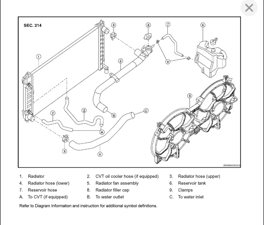

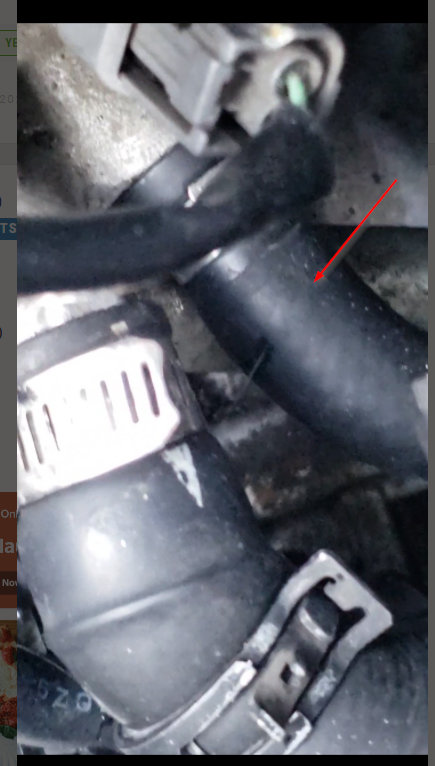

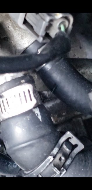

I found a leaking hose right under the ECT Sensor.
How can I identify this part?
It's curved and closest to the ECT sensor.
Dec 5, 2020 at 8:21 AM
BUSINESSFRED
  • 96 POSTS
Here's a picture:
Dec 5, 2020 at 8:22 AM
Just to confirm it is the one I pointed too?
Does your vehicle have CVT transmission? If it does, I suspect it is number 2 on the diagram. The larger hose appears to be the upper radiator hose.
You can confirm this by following it to the radiator and make sure it lines up with the diagram.
Dec 5, 2020 at 8:36 AM
BUSINESSFRED
  • 96 POSTS
It leads out towards the rear side of the engine.
It's smaller than the large hoses.
Dec 5, 2020 at 8:41 AM
Yeah. Take a look at those attachments to my last post. I think it is number 2. However, let's trace the hose and see where it stops. It should be the radiator if I am correct.
Dec 5, 2020 at 8:43 AM
BUSINESSFRED
  • 96 POSTS
It's from the thermostat housing to underneath the intake manifold.
Dec 5, 2020 at 8:49 AM
Okay. Out of the thermostat housing helps. Take a look at this one I attached. Is it B? Looks like that goes to the oil cooler. If not then it is C that goes to the heater core. B is going to be a smaller line then C but both of these are going to be smaller then the large radiator hoses.

Thank you so much.
It's definitely B.
