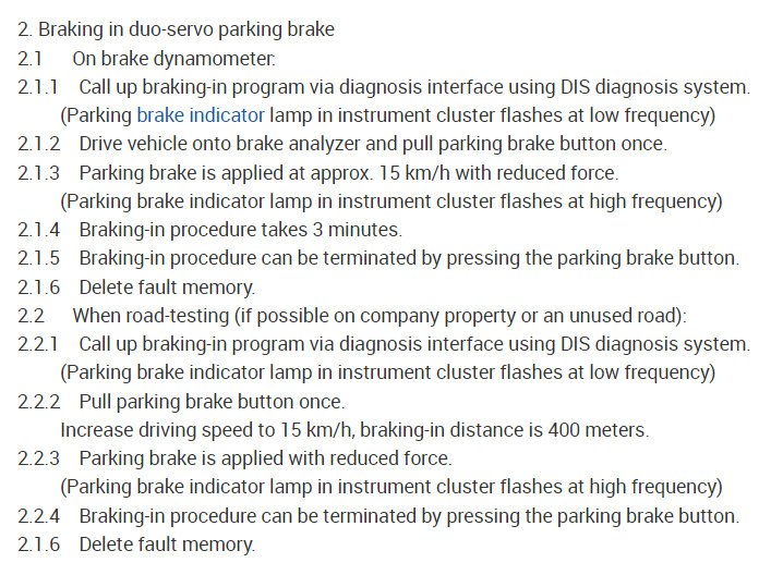

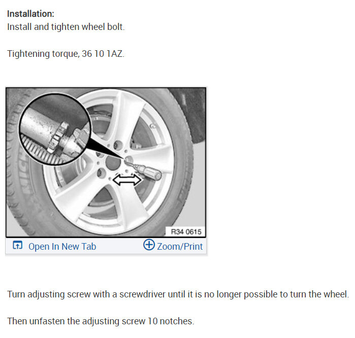

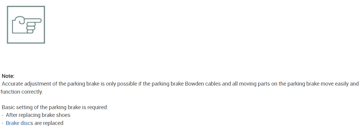

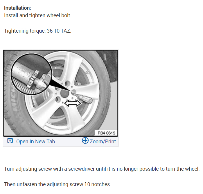

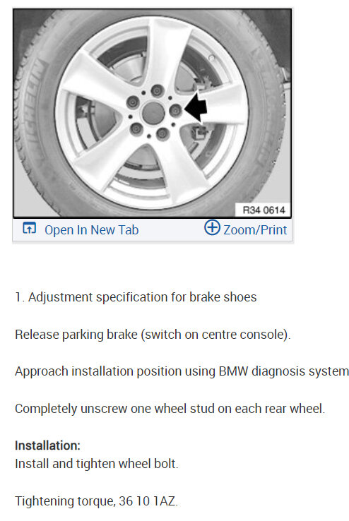

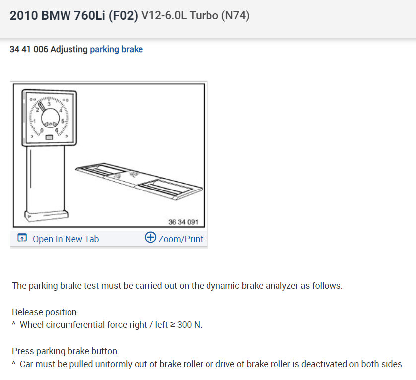

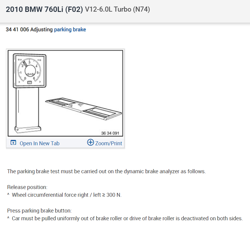

Good afternoon,
Please could I get the procedure to adjust the parking brake on the vehicle listed above. The parking brake does make noise when applied.
Mar 6, 2024 at 8:39 PM
  • 55,214 POSTS
It looks like the parking brake adjustment is done through the lug bolt hole. Here are the instructions in the images below. Check out the images (below). Let us know if you need anything else.
