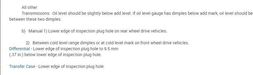

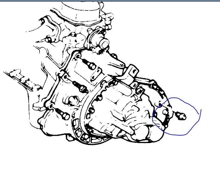

How to add oil and what kind of oil to transmission?
1980 CHEVROLET CITATION
514,611 MILES • 2.8L • 6 CYL • 2WD • MANUAL
KATHERINE JORDAN
Gearing when shifting is a bit stiff.
Mar 15, 2020 at 4:44 AM
Good afternoon,
the fluid is 75-90 gear oil and the plug is in the picture below. Check out the diagrams (Below). Please let us know if you need anything else to get the problem fixed.
