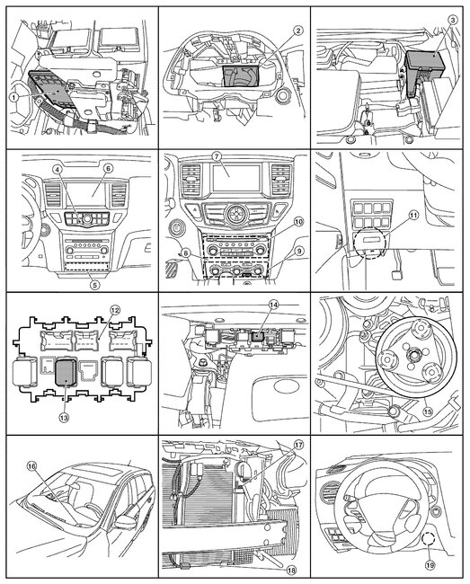

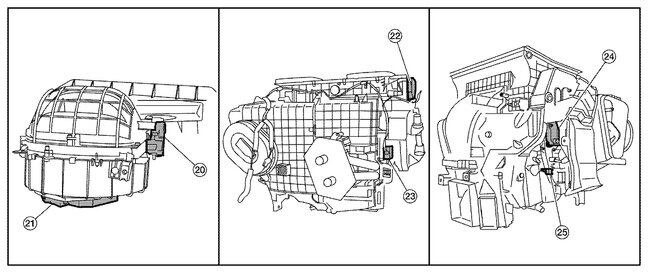

The mode door actuator on my 2014 pathfinder was determined to be defective. How do I access this item to replace it?

There's a left and right and middle front ..and a rear wich one do you need ?

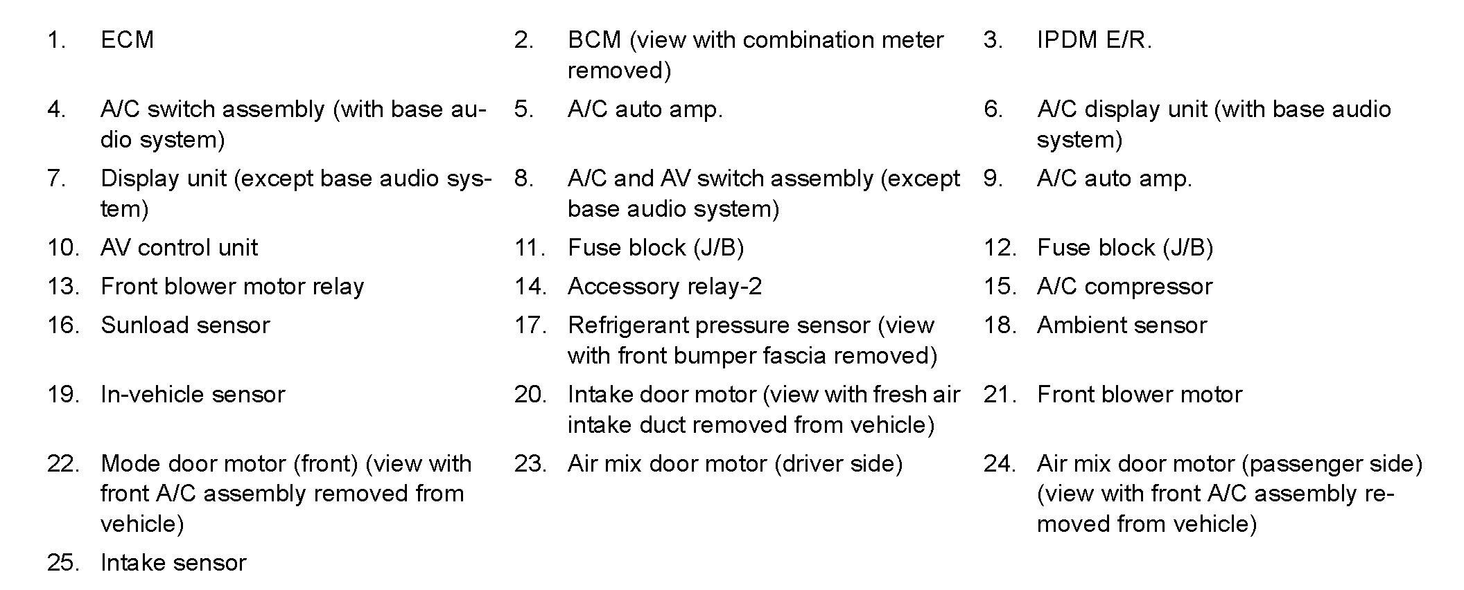

Heres the diagrams with locations im assuming you needed the one for the front please click the images below thanks good luck

Also often times the parts still ok so check all fuzes and relays first I think in total there's 3 relays for that best of luck let us know how it goes

Thank you Mechtrix…I believe it is the center one based on symptoms. The front dash does not always blow out of the center vents. I can reach in and manually move it to get some air. The other symptom is that sometimes it blows warm air when it should be cold. New compressor and radiator fan. Symptoms the same before and after. Two auto ac shops said it is the mode door actuator but neither shop does dash work!
