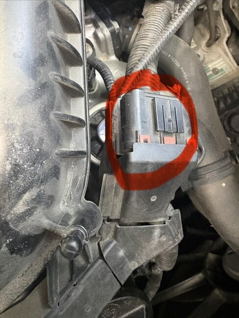

I would like to remove and clean the EGR valve on my 2018 Honda Pilot Elite. However, there is a connector on top of the EGR valve (in addition to the one connected to the EGR valve) that I would like to disconnect to make it easier to get to the EGR valve, but I can’t figure out how to disconnect it. I have included a photo of this connector circled in red. Can anyone tell me how to disconnect it?

The connector should release by pressing the locking tab and pulling the connector straight off, it helps to first push the connector slightly inward, then press the release tab, and then pull it back off the sensor/valve. This should enable you to remove the connector. Here is a diagrams below to help you as well. Check out the images (below). Please let me know what happens.

I can get the connector loose that you’re referring to. I’m asking about the big connector on top of the EGR valve.

Just to clarify, the connector that I have circled is not connected to the EGR valve. It’s above the EGR valve and I don’t know how to get it loose.

Got it, yes push down or pull up on the tab where I marked it on the arrow. Check out the images (below). Let me know how it goes

The plastic clip on top is the release for the connector, you might need to work it a little because they can be become stuck due to the weather pack seal.

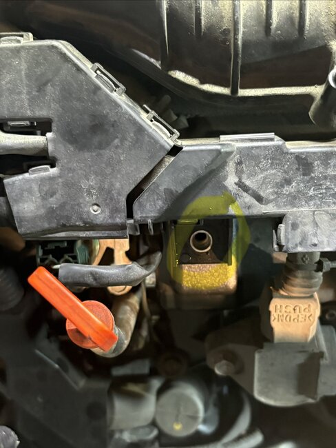

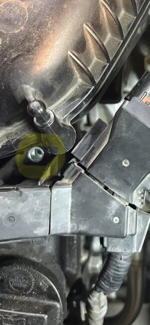

The wire harness I mentioned earlier was not the issue as it was not movable by itself. What I did was disconnect the two bolts along the wire harness assembly, which are shown in the photos. This allowed me to lift up the wire harness assembly just barely enough to remove the EGR valve.

I meant I removed the two bolts, not disconnected.

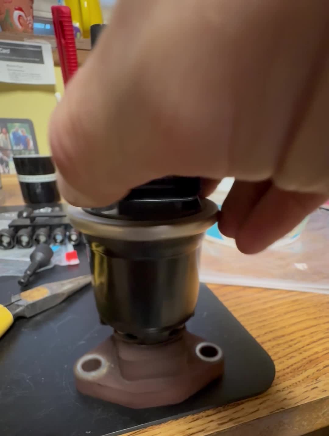

Yes, the hesitating is gone. Before I installed the new EGR valve, I cleaned the ports with throttle-body and air intake cleaner. I could’ve cleaned the old EGR valve and put it back in and I think the hesitating would’ve been gone also, but it had enough corrosion that I decided to replace it.

Sorry, I accidentally sent a video on save a photo I meant to send.

Sorry. I meant to send a photo instead of a video. Please disregard the last reply. No more voice typing for me.
