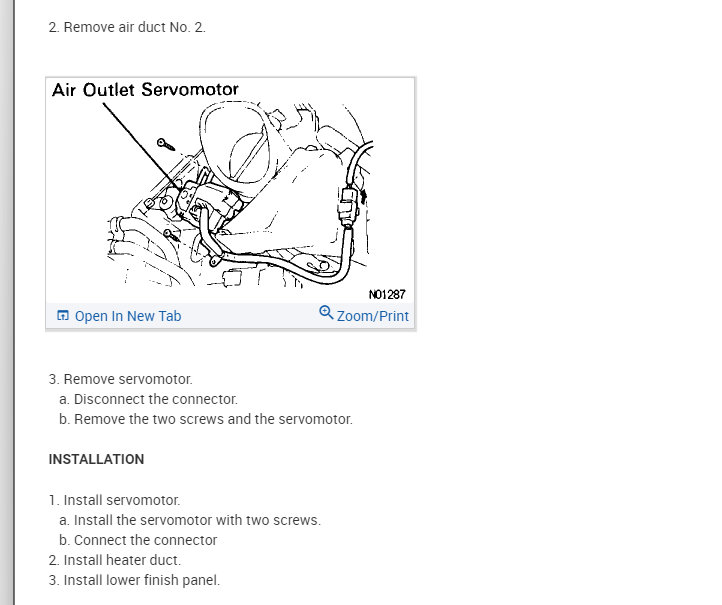

Does anyone know how I can access the center air vent damper on the car listed above? I have no air coming out of the center vents, but I have air coming from the side vents, and I suspect it might be the center air vent damper.
Thanks for any and all help.
Jan 19, 2022 at 9:14 AM

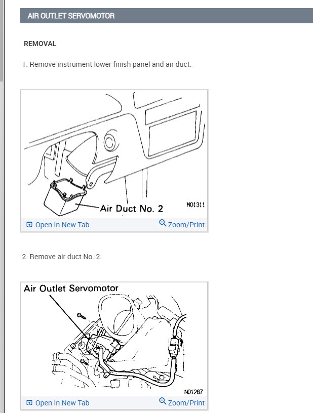

More than likely this is an outlet servo motor issue.
I suspect this is what you were talking about when saying the damper.
Here is a guide that will help with this issue in general:
https://www.2carpros.com/articles/low-or-no-air-flow-from-vents
Below you will find the info from the manual on the servo.
If you are talking about something different, please let me know and we can dig further into that.
Thanks
