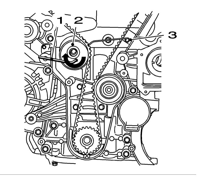

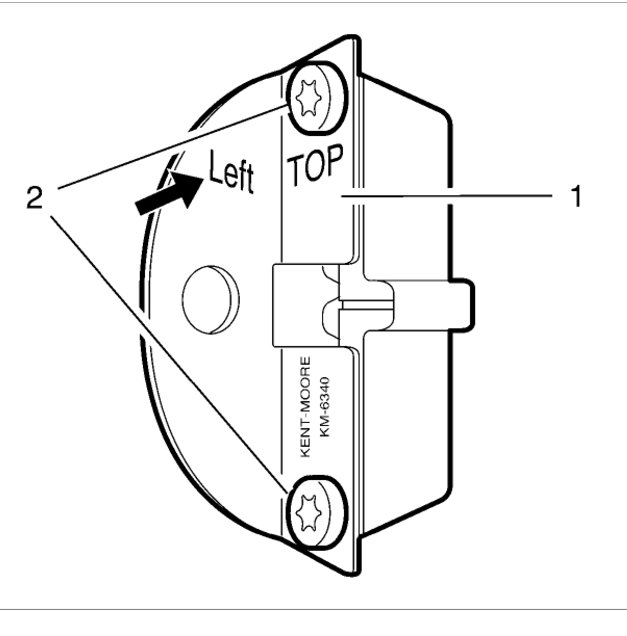

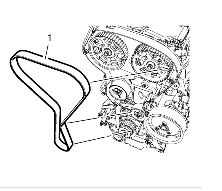

What are the timing chain timing marks for my car listed above?
Aug 19, 2017 at 1:50 PM
  • 54,837 POSTS

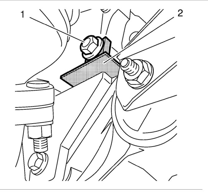

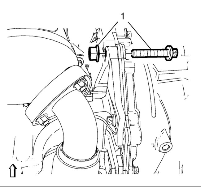

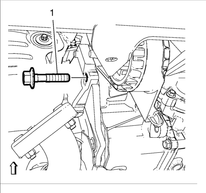

You will need to jack the car up first. Here is a guide for that.
Remove the serpentine belt, here is a guide that will give you an idea of what you are in for when doing that job.

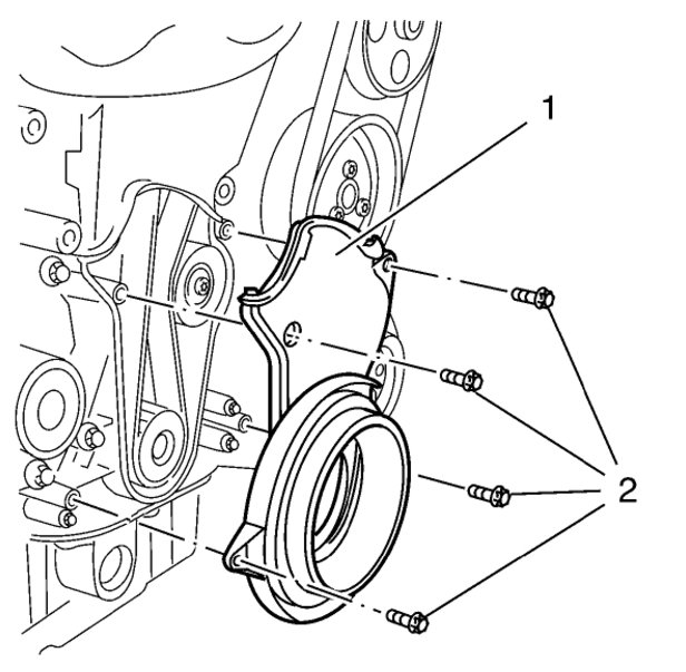

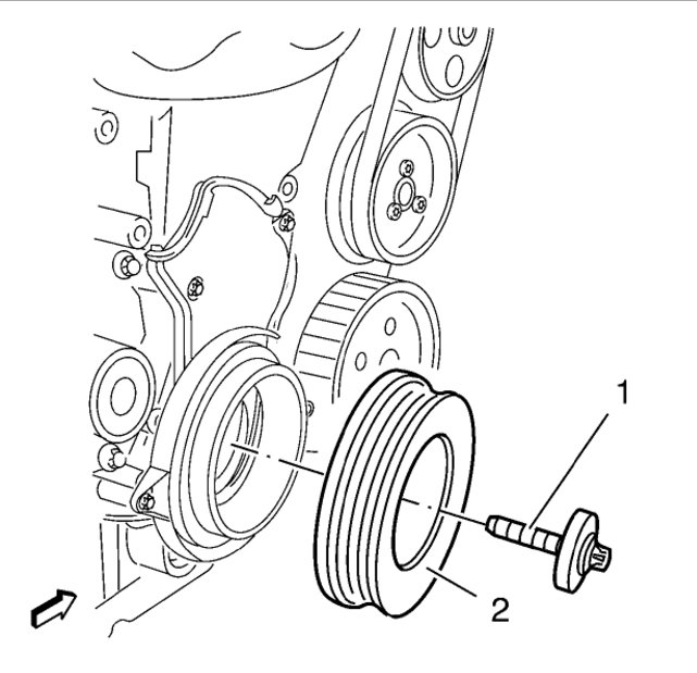

Then take off the balancer,
https://www.2carpros.com/articles/how-a-harmonic-balancer-works
Here are some factory notes for the tool
Note:
The left half of the EN-6340 locking tool can be recognized by the lettering "left", arrow, on the tool.
Prepare the left half of the EN-6340 - locking tool.
Remove the 2 bolts (2)
Remove the front panel (1) from the EN-6340 - locking tool- left.

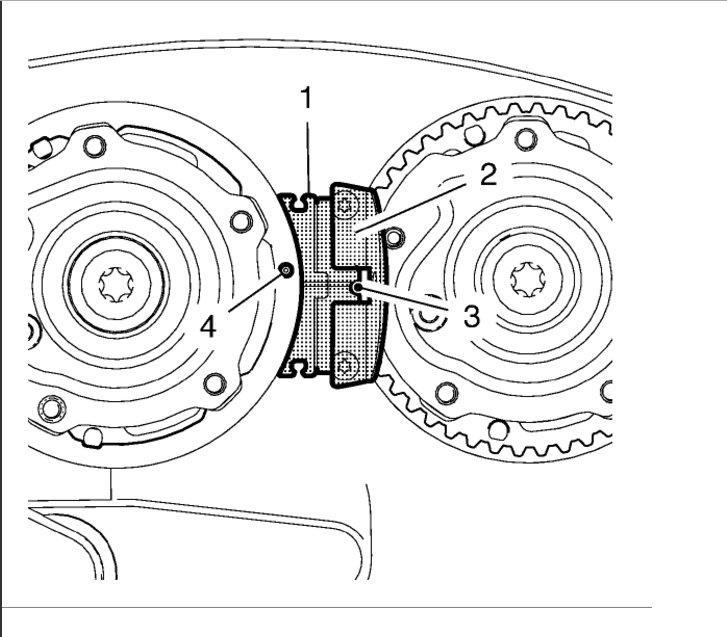

Install the EN-6340 - locking tool into the camshaft adjusters.
Note:
The spot type marking (4) on the intake camshaft adjuster does not correspond to the groove of EN-6340-left during this process but must be somewhat above as shown.
Install the EN-6340 - locking tool- left (1) in the camshaft adjusters as shown.
Note:
The spot type marking (3) on the exhaust camshaft adjuster must correspond to the groove on EN-6340-right.
Install EN-6340 - locking tool- right (2) in the camshaft adjusters as shown.
Please let us know what happens so it will help others.
Here is the timing belt
