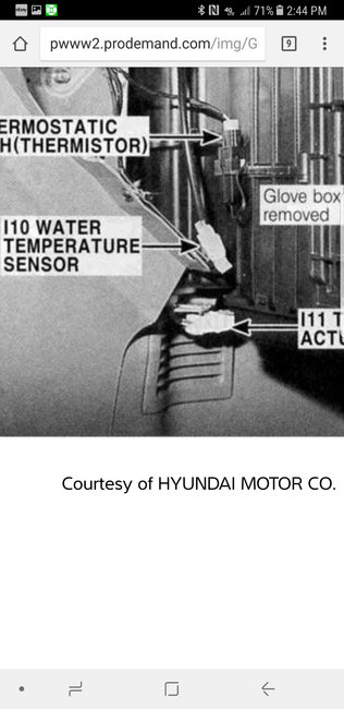

What does it mean then? Something electrical
Oct 25, 2020 at 5:30 AM
SATURNTECH9
  • 30,869 POSTS
I found a sensor labeled water temperature but not sure if it's the gauge sensor.To me it sounds like the gauge is miss reading the actual temp if it doesn't match the new coolant temp sensor readings on your code reader.
VISH4369
  • 32 POSTS
Which car is that? Anyway I swapped it with duralast couple of hours ago. Now even 195 F is fall under operating temps. But fans not coming on. It went to 205F at one point still no fan. But it's not fluctuating like before
SATURNTECH9
  • 30,869 POSTS
The fans are going to come on at like 210 on low then ramp up a little higher temp.Iam having trouble finding info on when the fans come on.That diagram is supposed to be your car.
VISH4369
  • 32 POSTS
But my sensor is under the hood. Yeah even I have trouble finding info on temperatures but I saw other Hyundai car which is from India it turn on in between 96C to 100C
