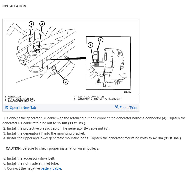

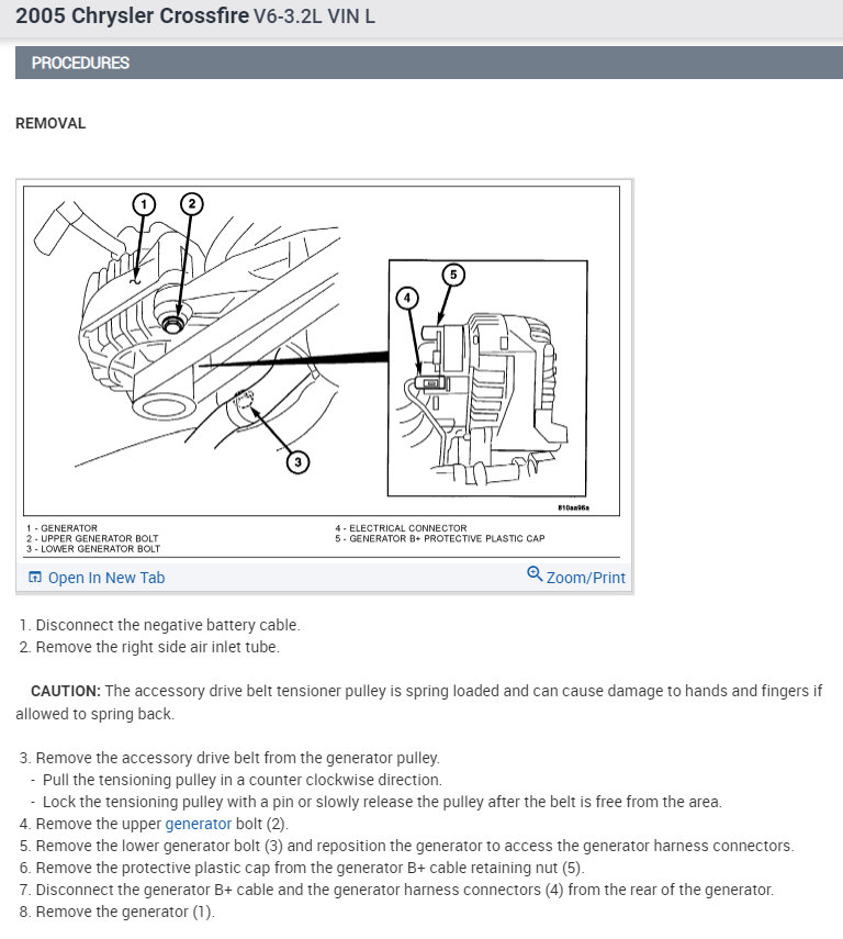

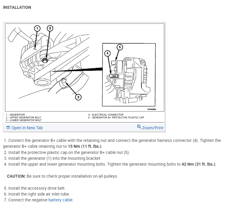

On idle the alternator should have an output between 13.6V to 15.2V to the battery.
Here is a guide on how to test the alternator:
Look below for the alternator replacement procedure.
Let me know of any questions.
