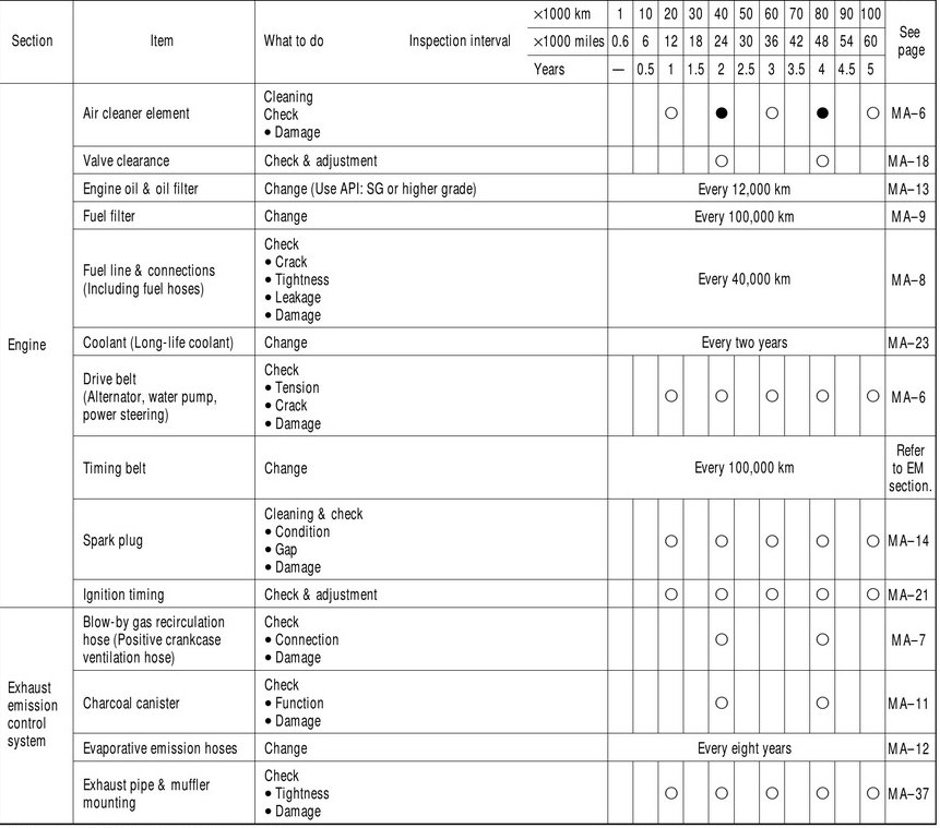

You might find these articles helpful:
https://www.2carpros.com/articles/differential-service
https://www.2carpros.com/articles/coolant-flush-and-refill-all-cars
See attached maintenance intervals.
