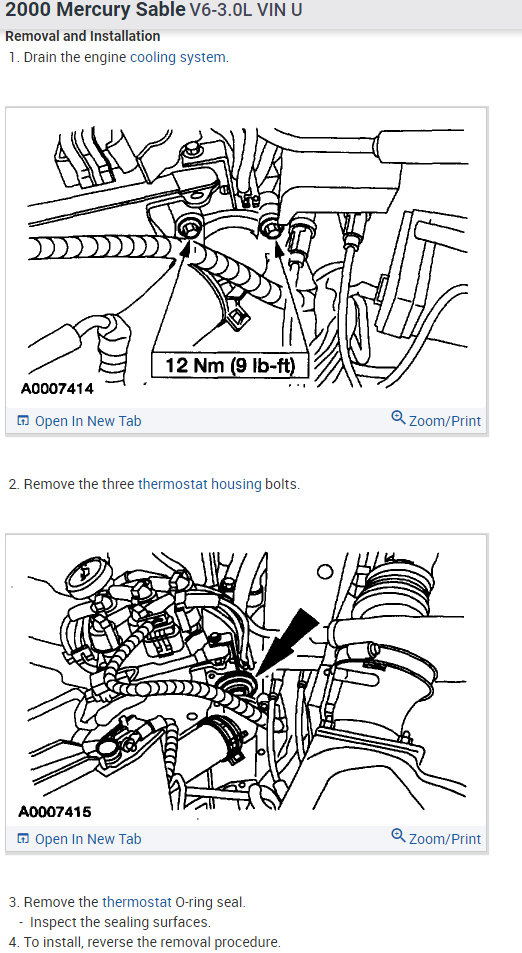

Here is a guide to check for overheating issues:
https://www.2carpros.com/articles/engine-overheating-or-running-hot
https://www.2carpros.com/articles/how-an-engine-thermostat-works

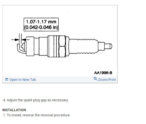

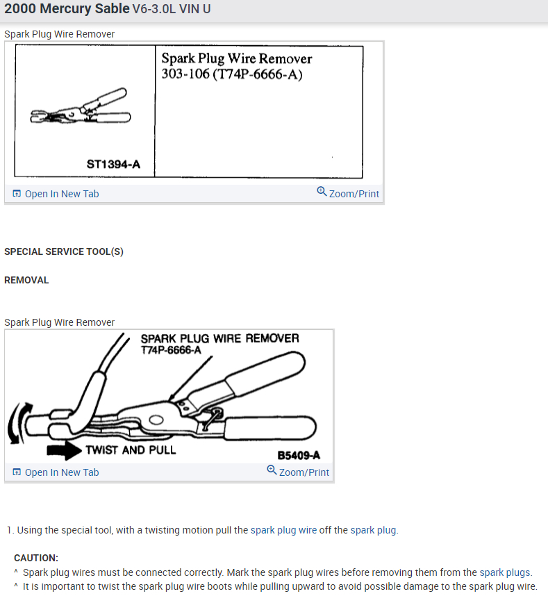

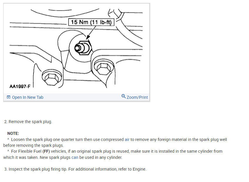

Some tips on tune up:
https://www.2carpros.com/articles/how-to-tune-up-a-car-engine
