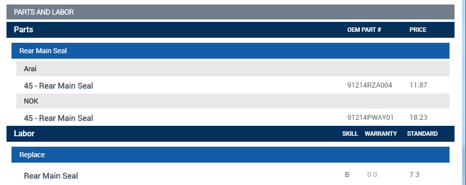

How much to replace rear main seal
2009 HONDA CRV
65,000 MILES • 2.4L • 4 CYL • 4WD • AUTOMATIC
MOLUKUANGHUAN

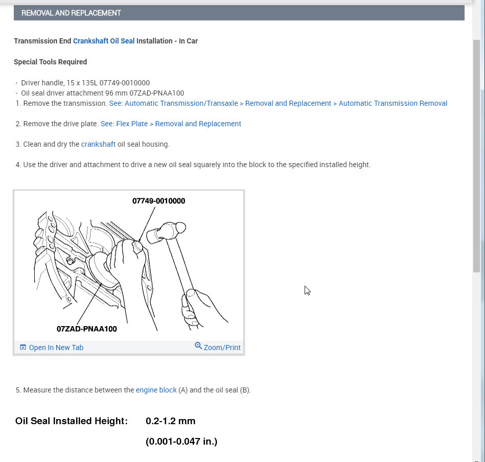

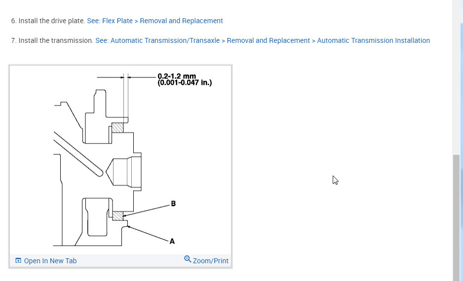

It's leaking between engine and transmission and getting worse. Looks like rear main seal.
Dec 5, 2019 at 10:26 AM
Looks like the rear main seal costs about $20.00 and the labor is 7.3 hours according to AllData. This means if the shops door rate is $100.00 per hour it will be about $730.00 in labor.
Let me know if you have questions. Thanks
