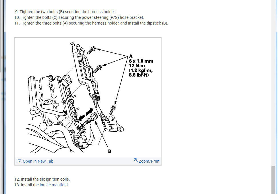

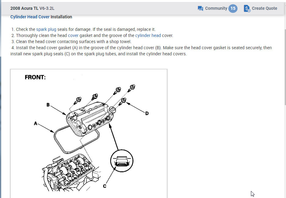

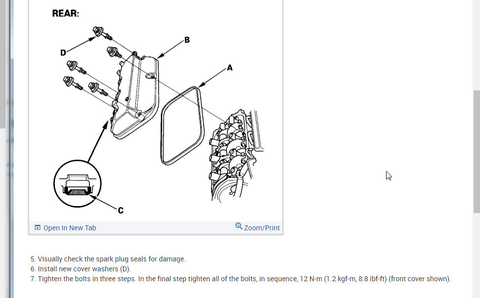

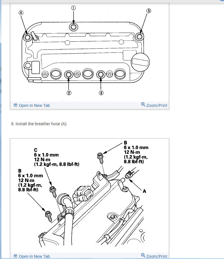

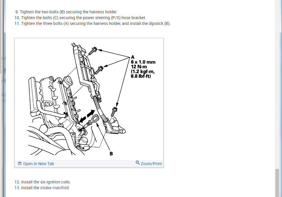

Can you tell me how many valve cover gaskets does my car have?
Oct 25, 2020 at 8:53 AM
You have one on each head for a total of 2. I included the process on how to replace them if you need that as well.
