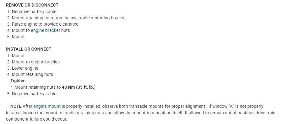

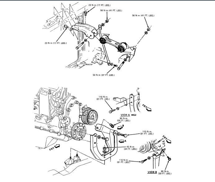

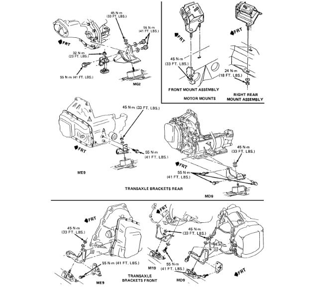

Good afternoon,
There is one on the front of the motor, one on top of the motor and 2 on the transmission.
I attached pictures and the procedure for you.
Jan 27, 2020 at 1:06 PM

Roy from the diagram it’s hard to tell but does my transmission have the same mounts for the transmission or are they different? Just making sure, according to GM there is just one transmission mount. So that would be the same part for 2 on the transmission?

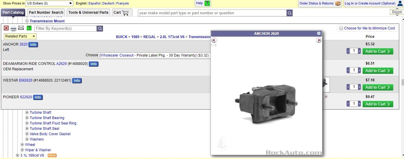

There are 2 mounts. One on the front and one on the rear.
The parts are not showing the second mount. Good chance they do not make it anymore.
I attached the picture of the left one.
Jan 27, 2020 at 4:26 PM

So the transmission support, mentioned by GM is the rear transmission mount. That is called the transmission mount support that they don’t make anymore. The transmission mount is still available. It wouldn’t hurt to just replace the one mount right? As the other one is just a support and it shouldn’t wear out should it?
Jan 28, 2020 at 4:01 PM
Correct. Just replace the one mount.
