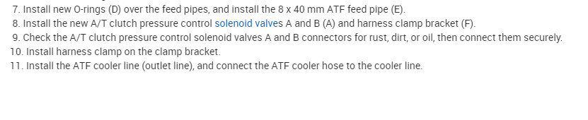

Slow acceleration , hard shifting , car shows a p1750 error code. How many sensors?
Jul 15, 2020 at 10:10 AM

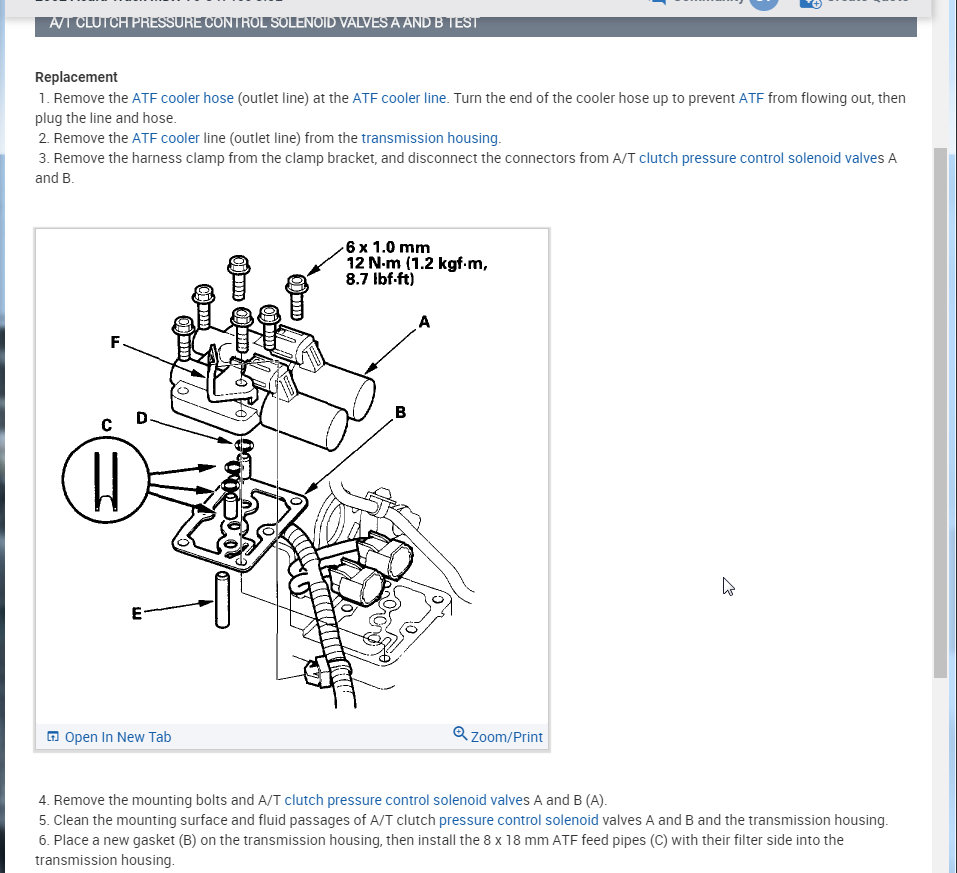

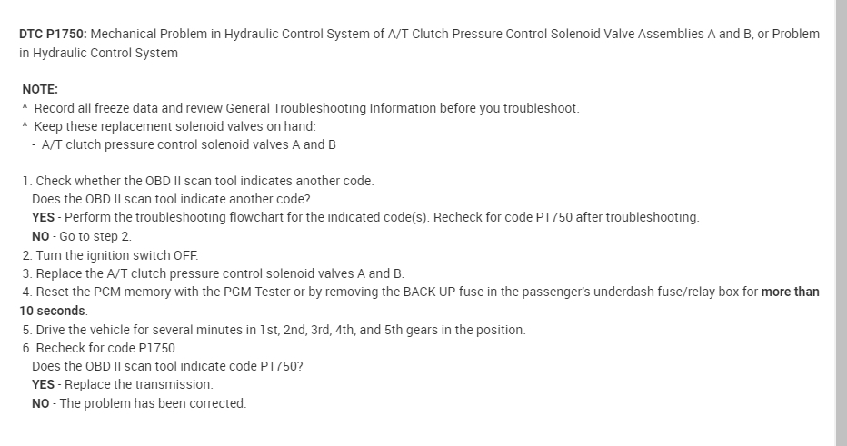

I attached the info for this code. Unfortunately, it just has you replace the clutch pressure control solenoid valves A and B (process attached) and if that doesn't fix it then you need to replace the transmission.
Review this material and let me know if you have questions. Thanks
