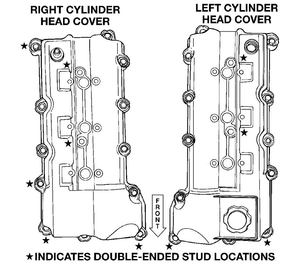

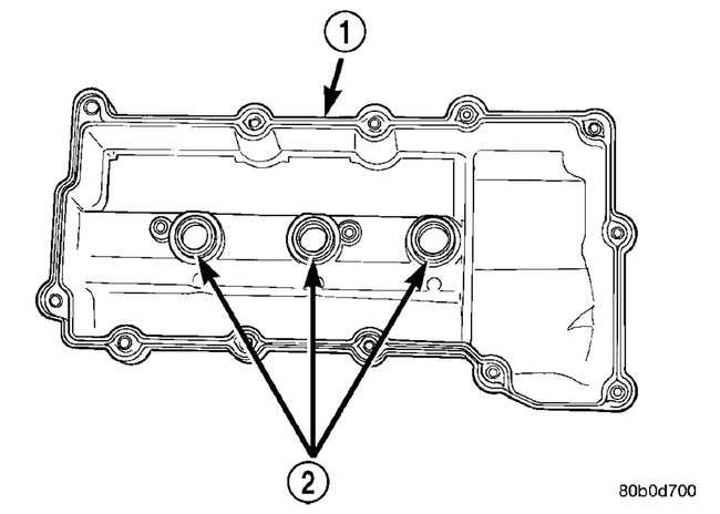

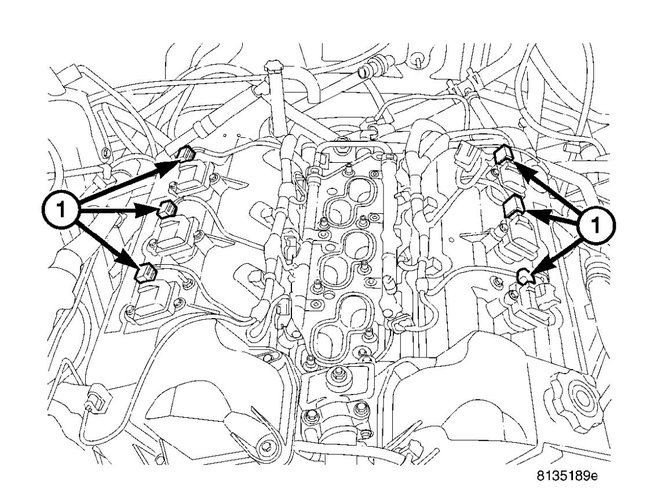

I am having difficulty finding how much transmission fluid my vehicle takes. Also, my second ignition coil and spark plug keeps getting a black thick substance on it and they are both brand new.

Your transmission holds 5.30 quarts of ATF Plus 4 or equivalent. Does the spark plug and coil issue set a code or check engine light? Hope this helps and thanks for using 2CarPros.

Yes, the code that it sets of is: cylinder two misfire, and injector circuit/open- cylinder two
P0300 Cnf.
And yes the check engine light also comes on and sometimes blinks.
Aug 23, 2018 at 5:35 AM
DANNY L
  • 5,648 POSTS
Hello again.
How long between replacement did it do again (code set/oily deposit)?
Also, the mileage in between. Probably the valve cover gasket leaking oil into the spark plug well.... fairly common issue
Since you have to remove the upper intake to do this and one side is leaking you may want to consider replacing both sides while it is apart.
Let me know. Thanks again for using 2CarPros.
Danny-
Some diagrams below of replacing V/C gaskets
