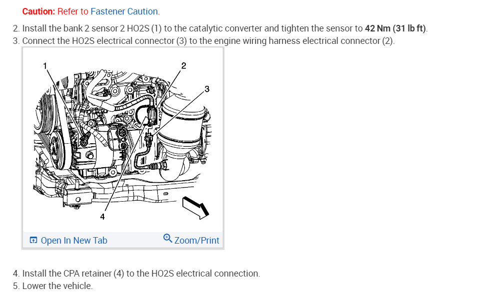

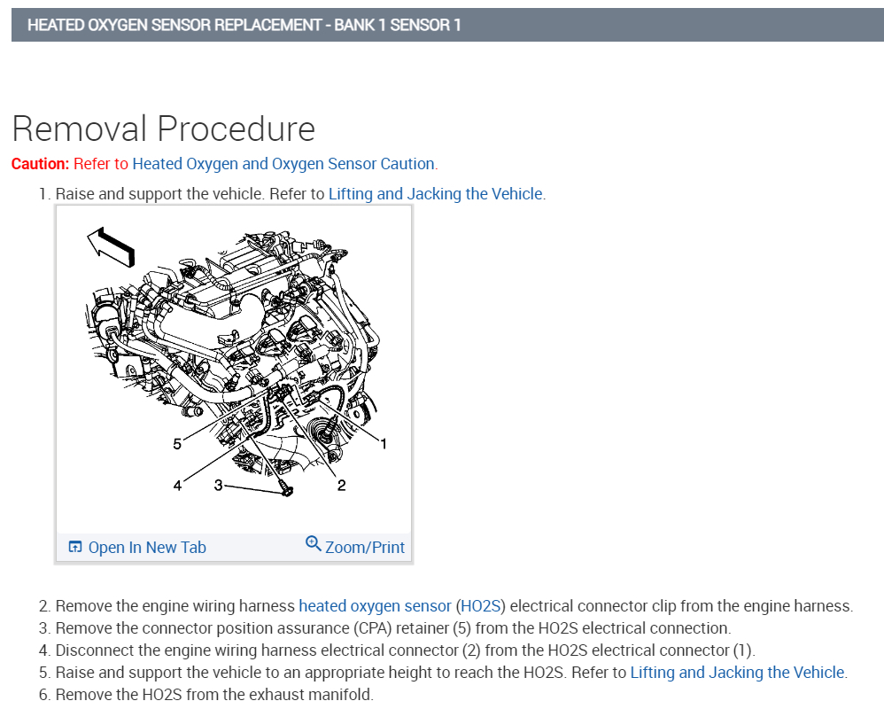

Changed out O2 sensor while I changed out radiator fan. Now check engine light is on so trying to figure out how many O2 sensors there are.
Jul 15, 2023 at 8:19 AM
  • 55,845 POSTS

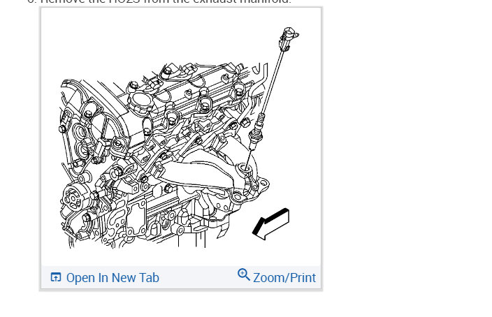

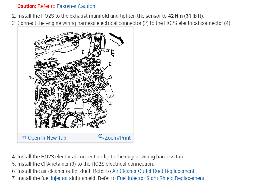

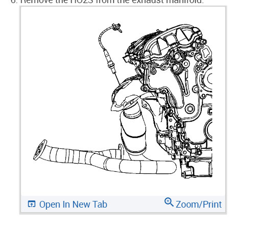

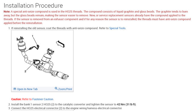

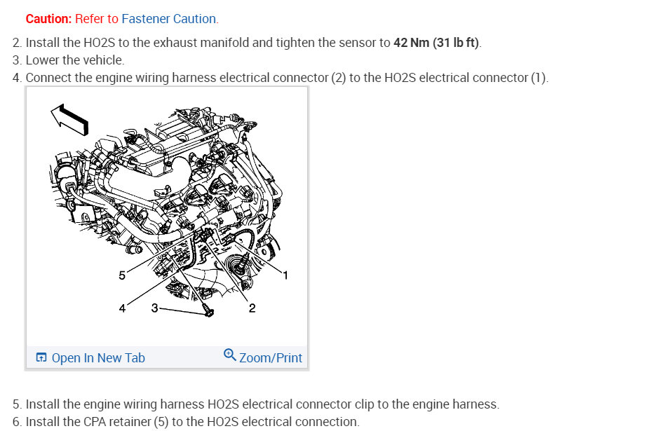

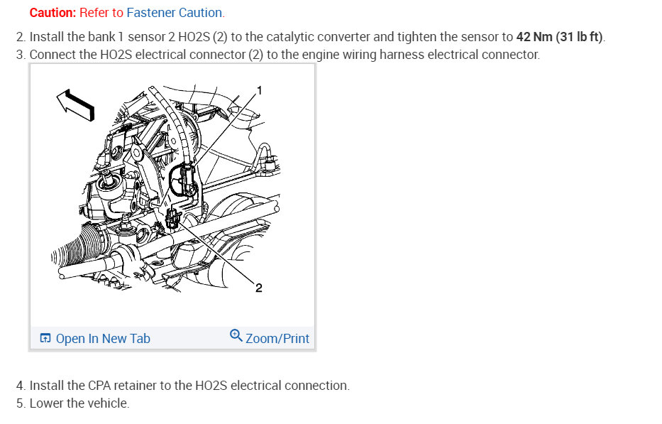

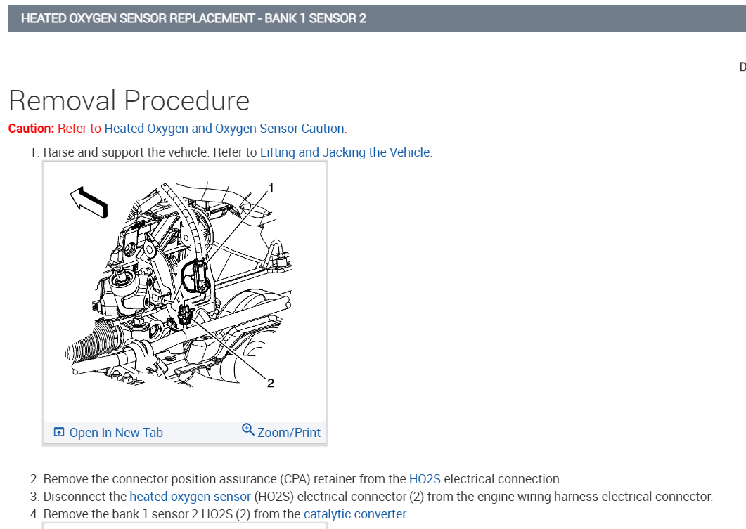

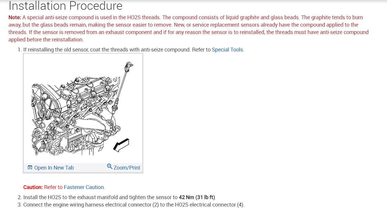

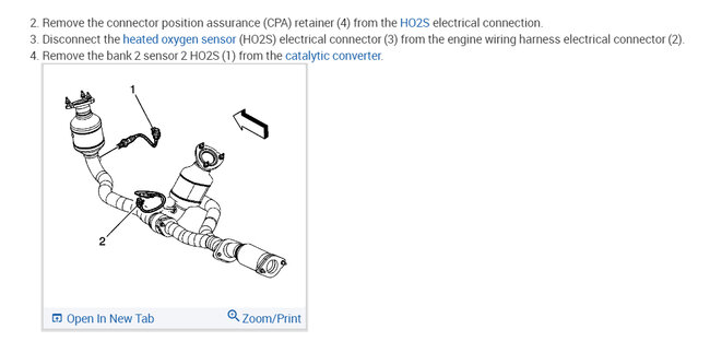

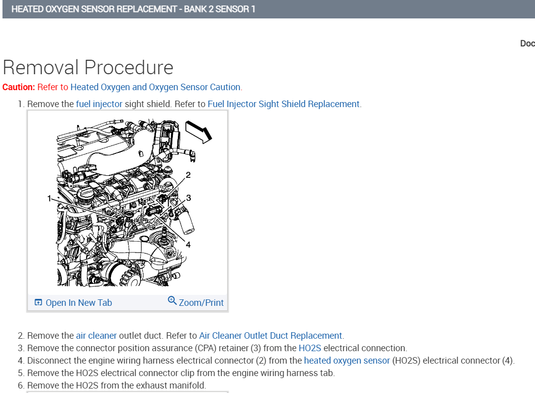

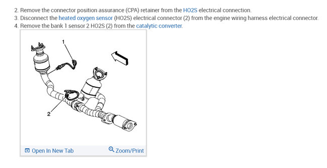

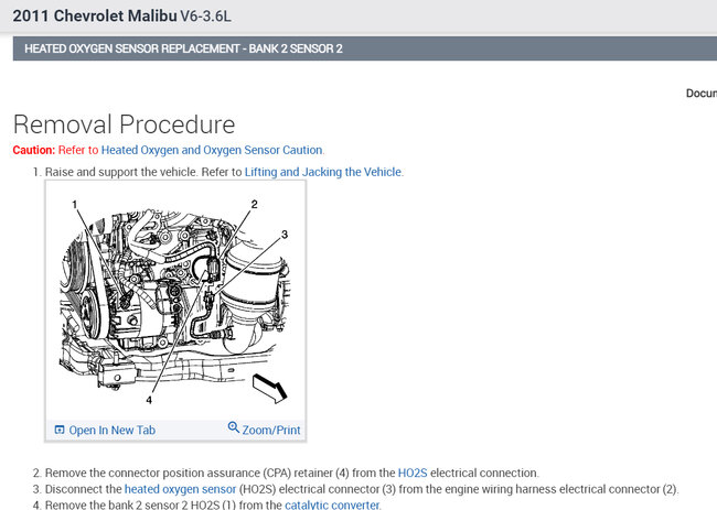

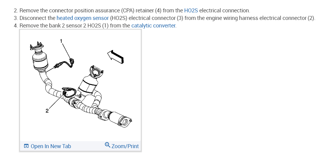

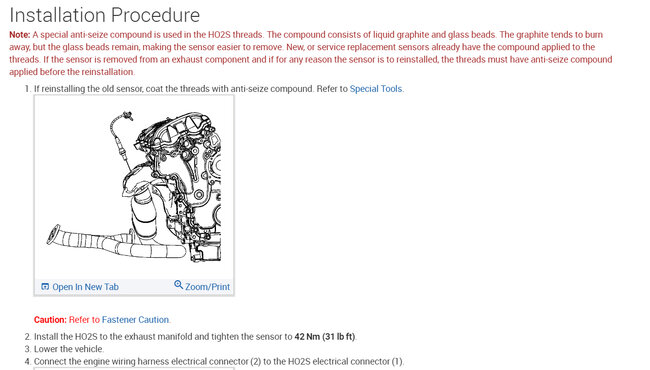

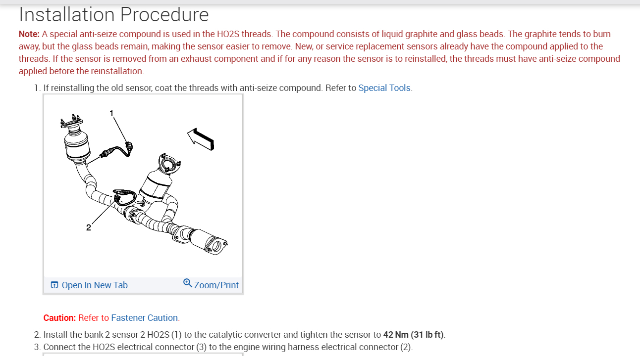

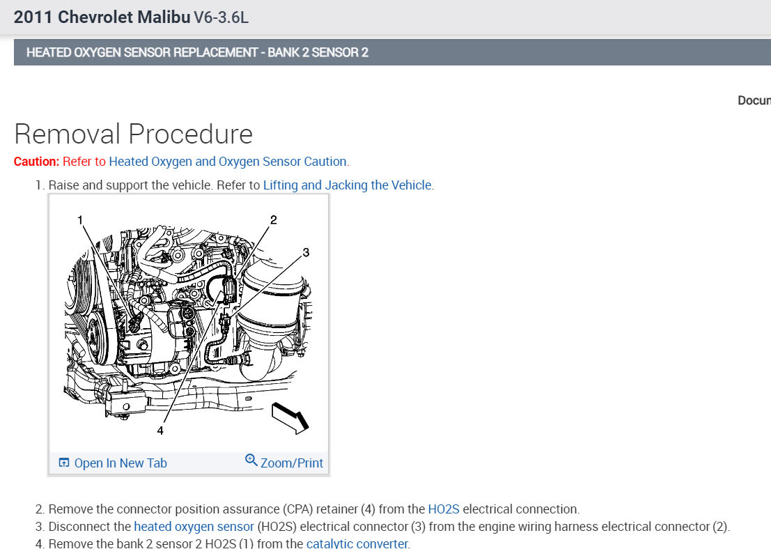

This engine has four oxygen sensors, two primary and two secondary sensors. Here are the locations and how to change them out. Here is a generic guide to help you step by step with instructions in the diagrams below to show you how on your car:
https://www.2carpros.com/articles/how-to-replace-an-oxygen-sensor
Bank 1 is on the right side of the engine near the firewall. Check out the images (below). Please let us know if you need anything else to get the problem fixed.
