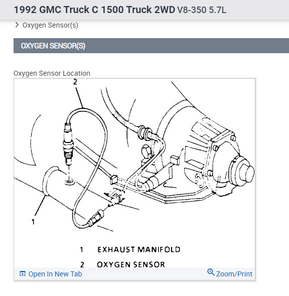

How many O2 sensors does this vehicle have and their locations?
1992 GMC C1500
108,000 MILES • 5.7L • V8 • 2WD • AUTOMATIC
JETZEN101
I could only find bank1 sensor 1. I can't fine bank 2 sensor 2, O2 sensors location on 1992 GMC C-1500.

I believe in 1992, there was one used off the exhaust manifold. If you take a look below, I attached the only pic I could find related to its location.
Let me know if that helps or if you have other questions.
See pic below.
