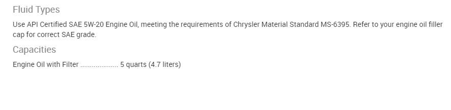

How many liters needed for changing engine oil?

Good morning,
The specs for the engine oil are attached for your engine. Check out the diagrams (Below). Please let us know if you need anything else to get the problem fixed.
Image (Click to enlarge)
