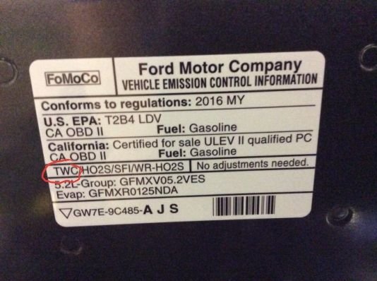

I want to know specifically if my car has 2 or 4 catalytic converters.
Dec 30, 2019 at 12:55 PM
JIS001
  • 3,412 POSTS

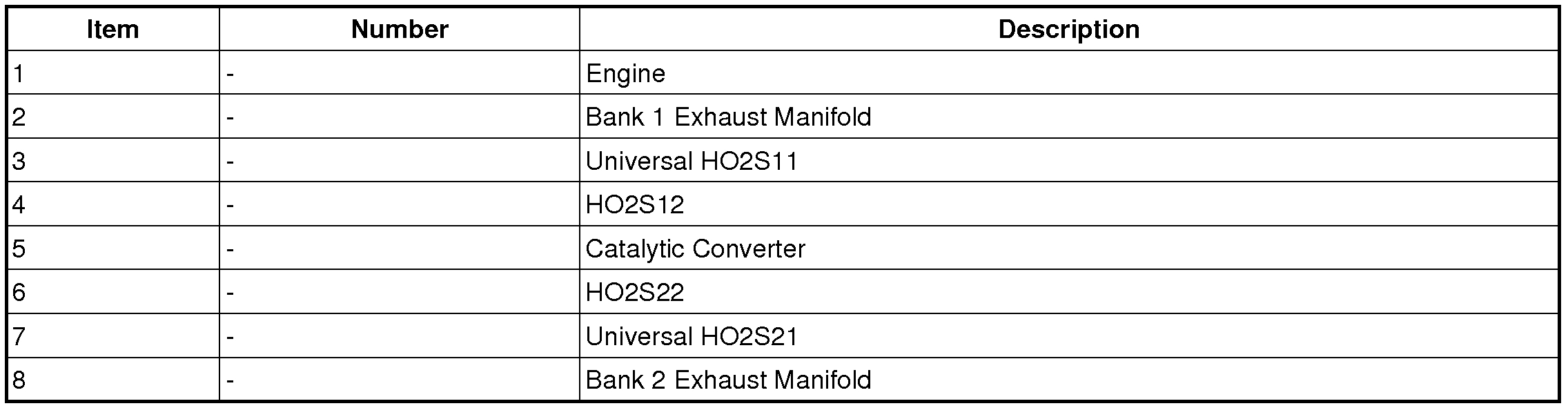

It looks like you have 2 but the emissions label will tell you for sure. See images below. The emissions label I attached is an example. If you take a picture of it I can tell you for sure how many you have.
Apr 13, 2021 at 3:38 AM
STEVE W.
  • 15,356 POSTS
If it's the base model 3.7 it has 2 converters, one for each cylinder bank, then a set of resonators behind them. Then there is the crossover. Then the rear section of the system with dual mufflers.
