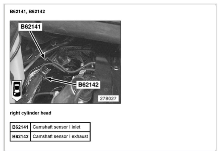

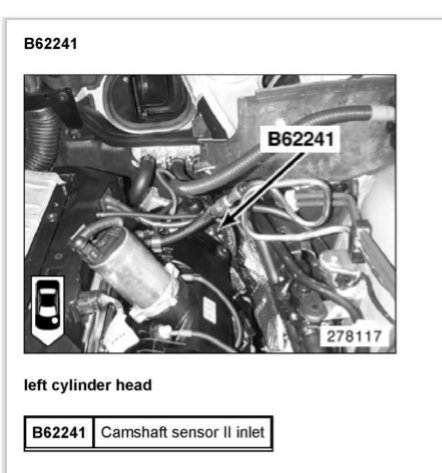

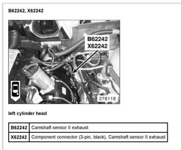

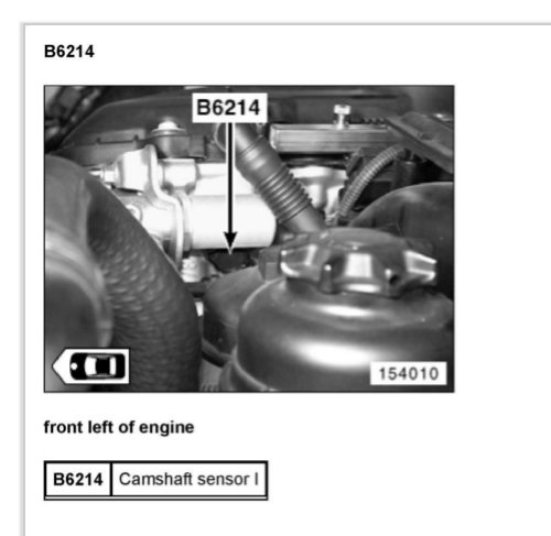

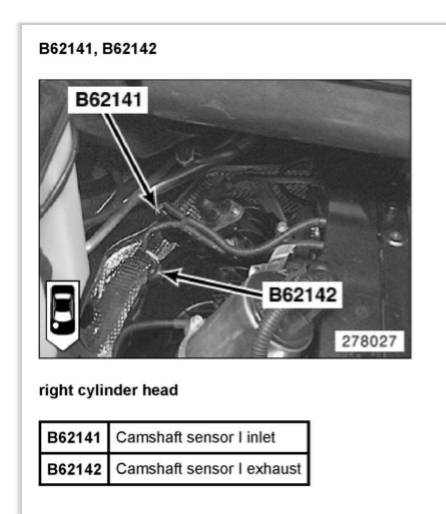

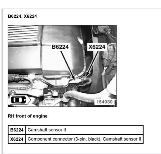

How many camshaft position sensors does it have and where are they located?
Feb 8, 2019 at 3:05 PM
SCGRANTURISMO
  • 4,897 POSTS
It looks like six. I have included photos of there locations in the diagrams below. Check out the diagrams (Below). Please let us know if you need anything else to get the problem fixed.
