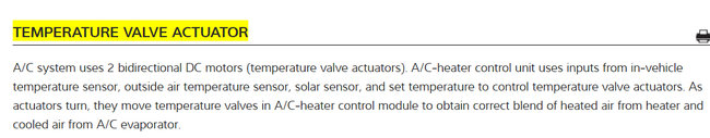

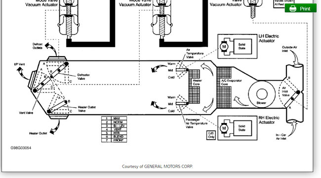

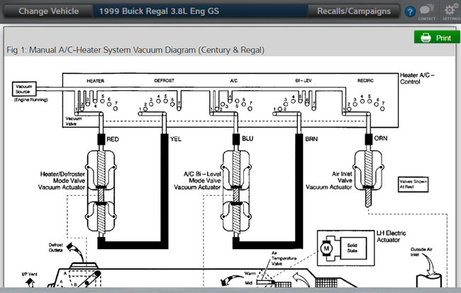

How many blend door actuators does my car have and where are they located in my car listed above?
Apr 10, 2019 at 4:10 AM
SCGRANTURISMO
  • 4,897 POSTS
It looks like there are three of them for your vehicle's Heating, Ventilation and Air Conditioning (HVAC) system. I have include a description and diagrams in the diagrams down below for you. Please go through this information and get back to us with what you are able to find out please.
