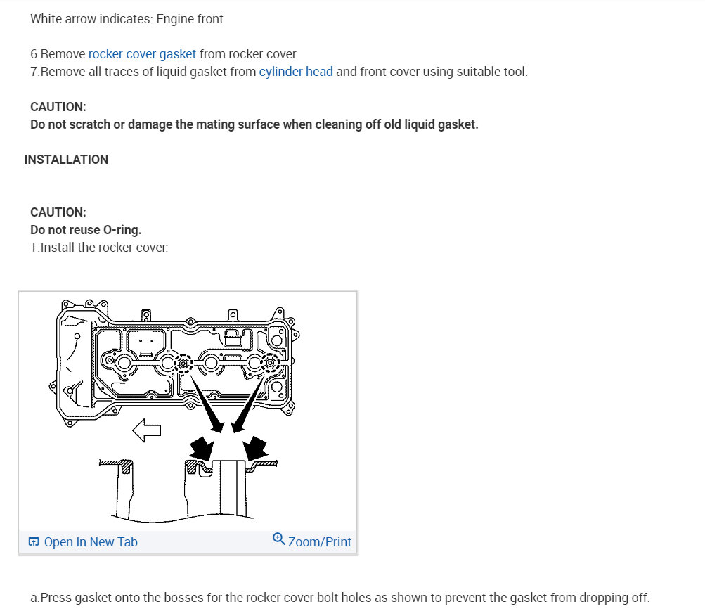

how long does it take to replace the valve cover gasket on the above vehicle?
85,000 MILES • 1.6L • 4 CYL • 2WD • AUTOMATIC
ALEX STATHAS
  • 71 POSTS
It's a simple question and I don't get wordy or technical about cars, so how long does it take to replace the valve cover gasket? Take your time to answer because I just asked a very simple question without going technical about cars?
Jan 18, 2023 at 12:25 PM
  • 55,709 POSTS

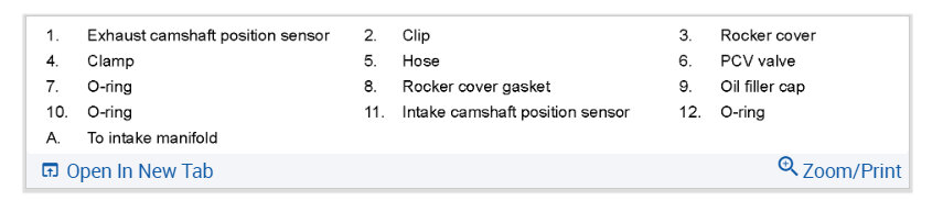

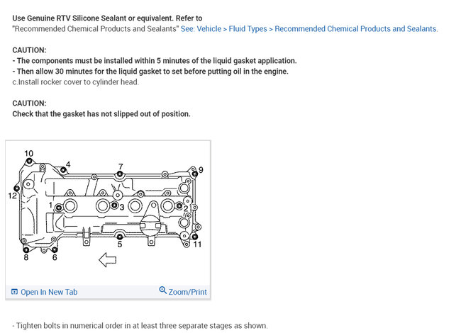

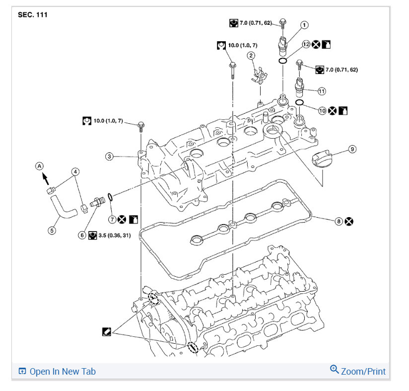

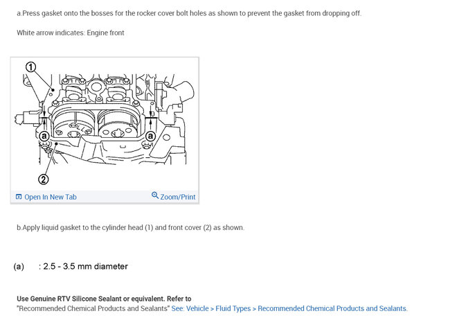

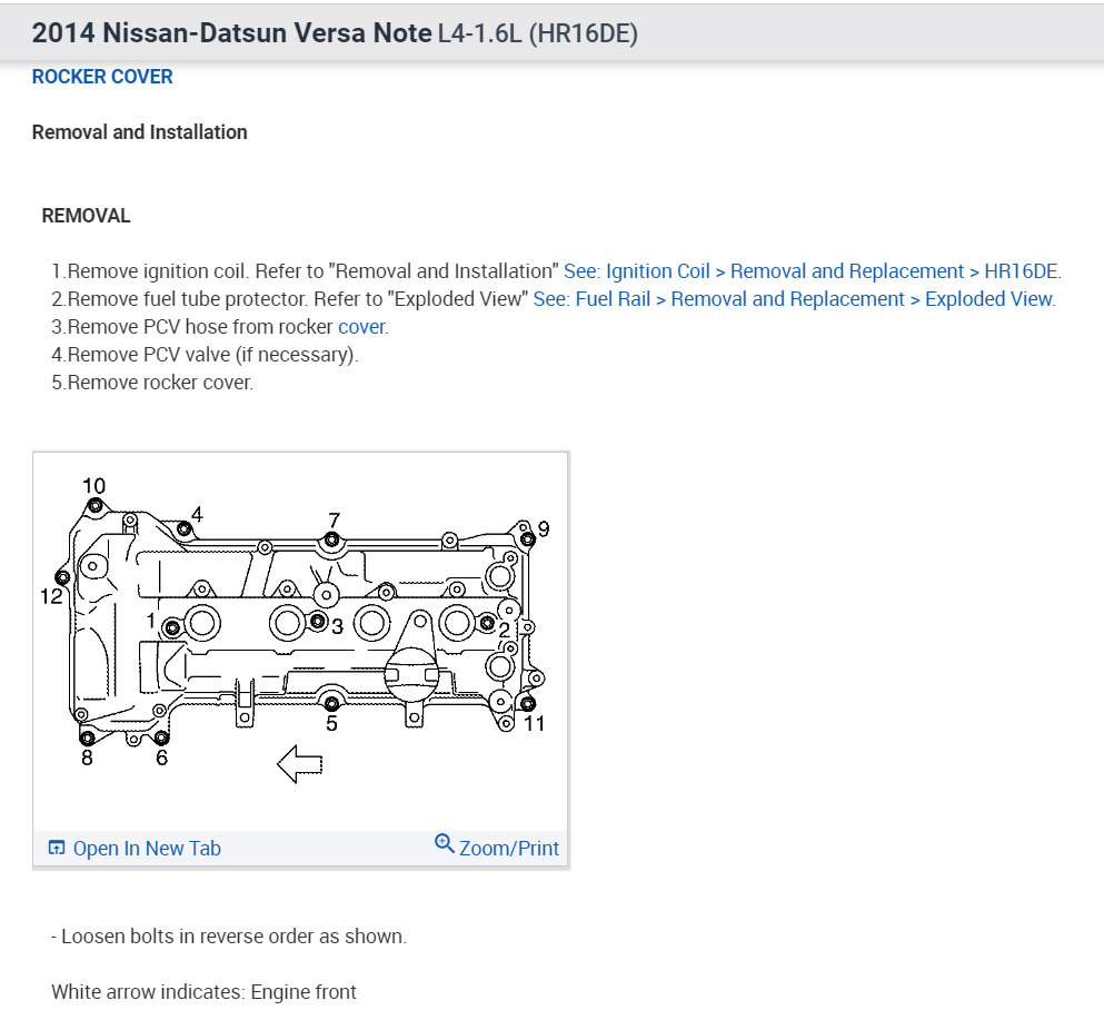

The valve cover or rocker cover takes about an hour to change out. Here is a generic guide to help you step by step with instructions in the diagrams below to show you how on your car.
https://www.2carpros.com/articles/replace-valve-cover-gasket
Check out the images (below). Please let us know if you need anything else to get the problem fixed.
