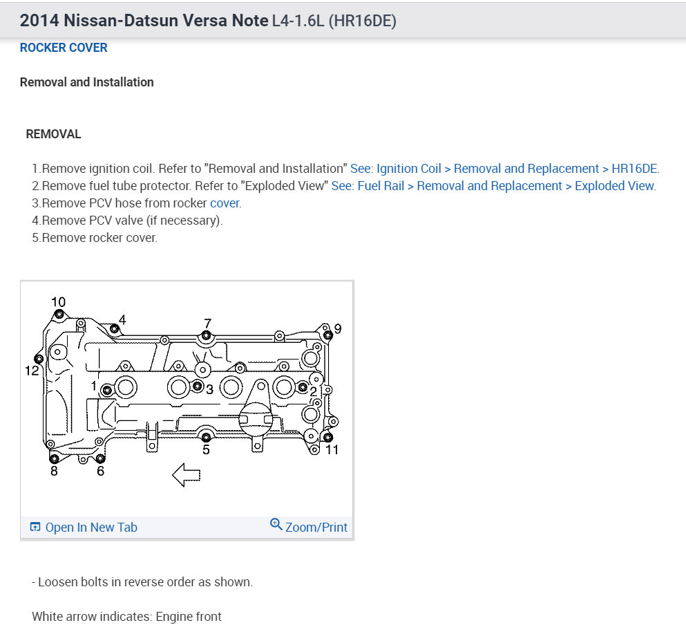

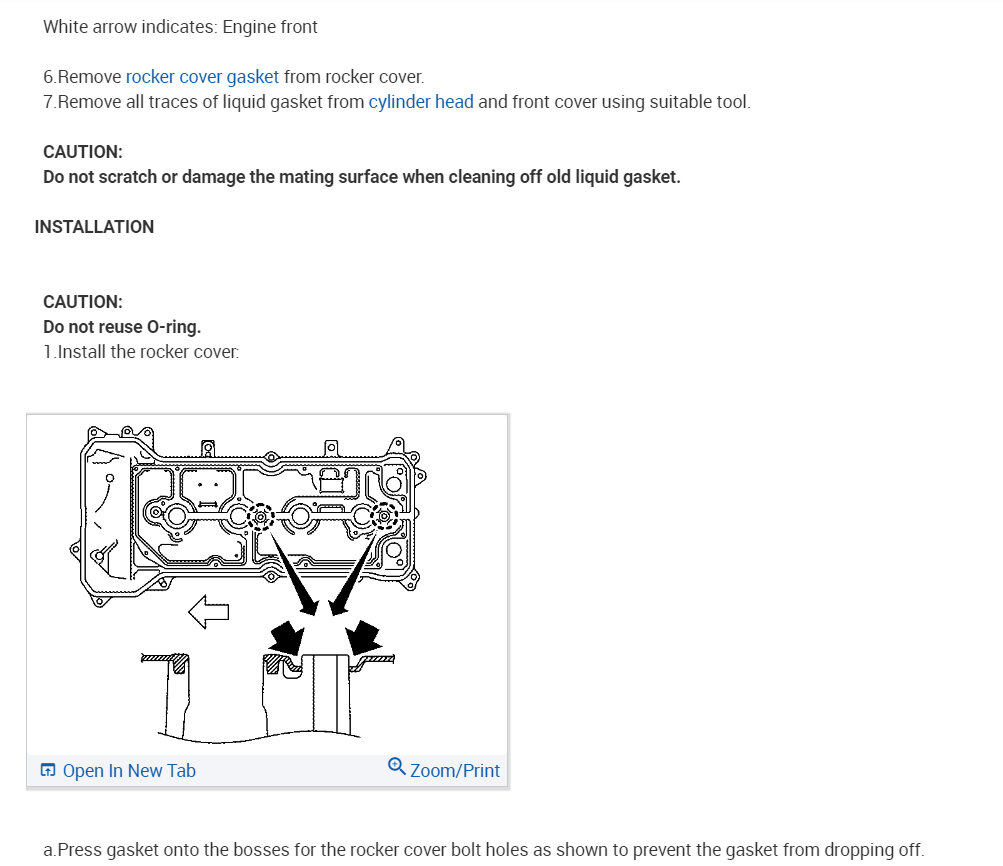

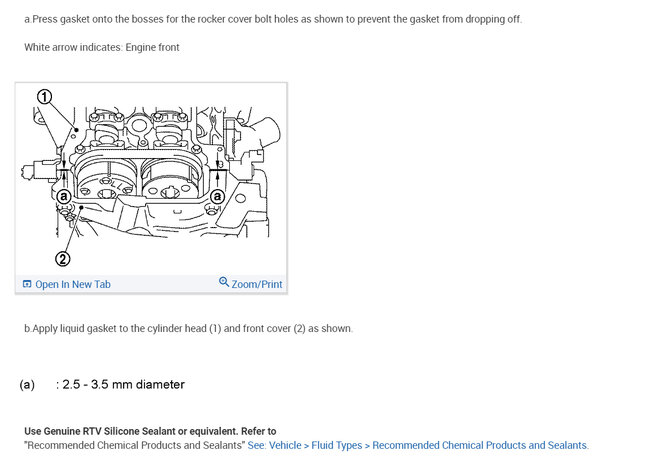

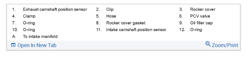

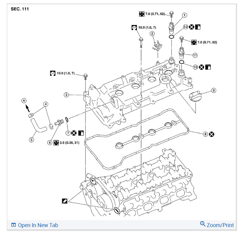

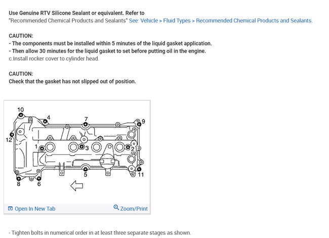

The valve cover or rocker cover takes about an hour to change out. Here is a generic guide to help you step by step with instructions in the diagrams below to show you how on your car.
https://www.2carpros.com/articles/replace-valve-cover-gasket
Check out the images (below). Please let us know if you need anything else to get the problem fixed.
