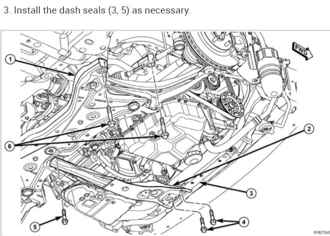

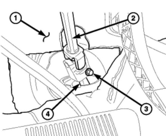

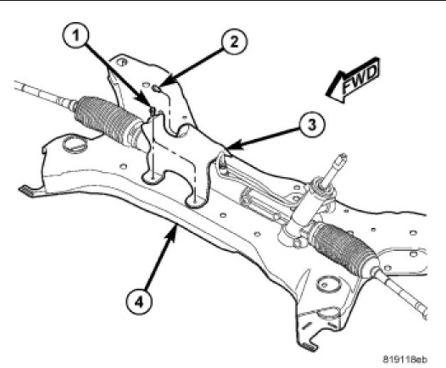

rack and pinion replacement instructions please?
2008 DODGE CALIBER
112,265 MILES
SHAYY
It has been off my car for a year now is has a bad bad rack and pinion
Aug 13, 2019 at 10:58 PM
CARADIODOC
  • 34,381 POSTS
That's the steering gear assembly. You can't move the car without it. Use 2CarPros anytime, we are here to help. Please tell a friend.................
Aug 14, 2019 at 4:28 AM
DANNY L
  • 5,648 POSTS
Hello, I'm Danny.

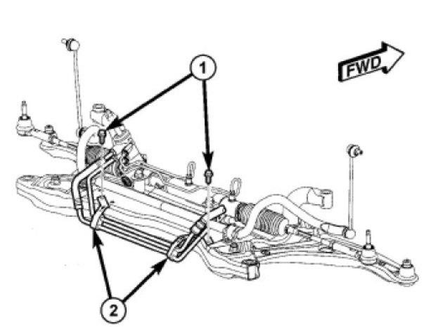

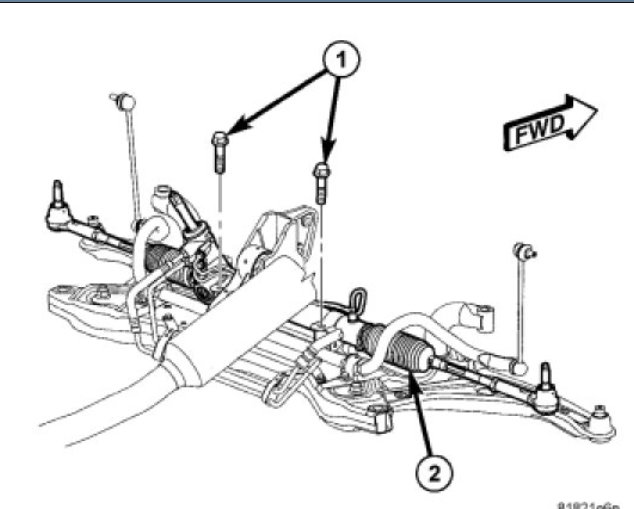

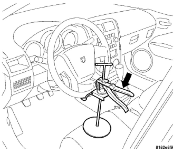

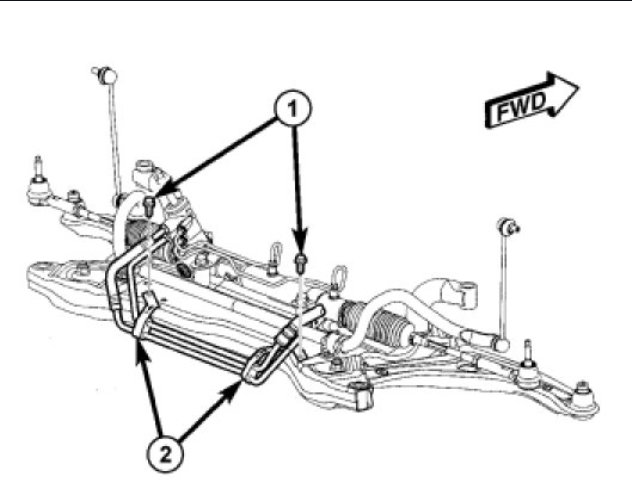

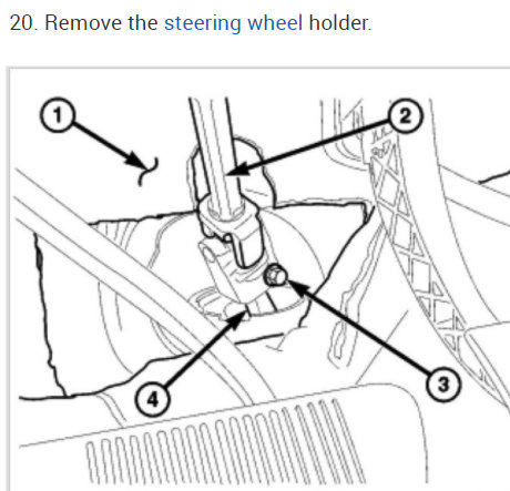

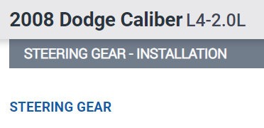

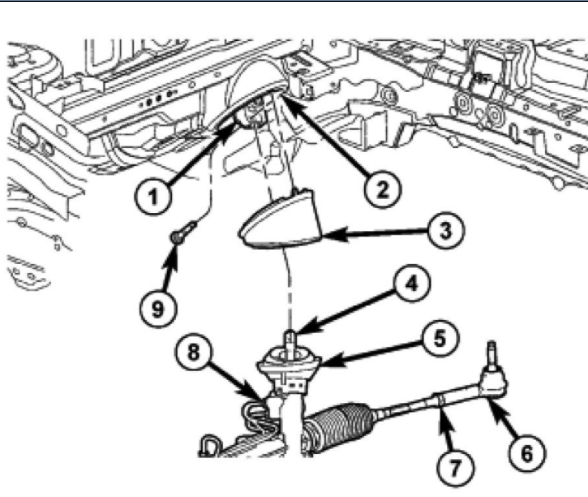

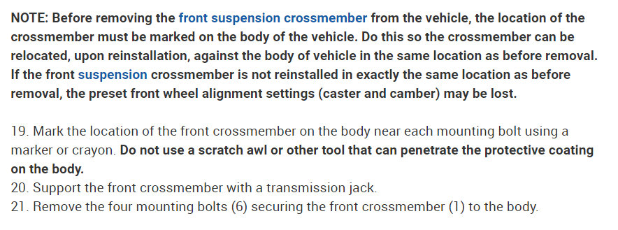

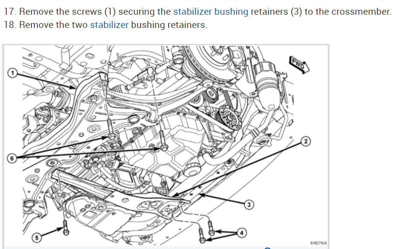

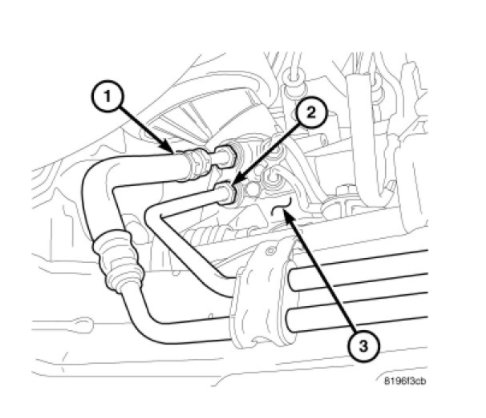

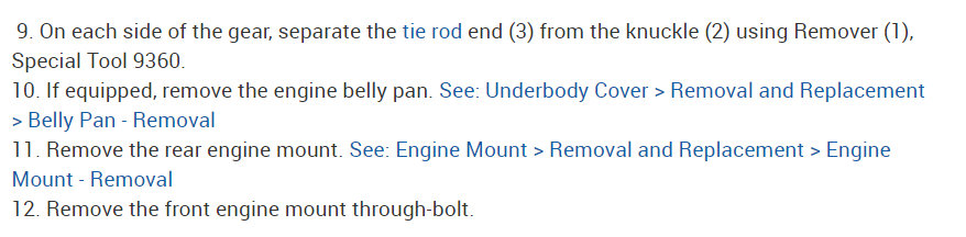

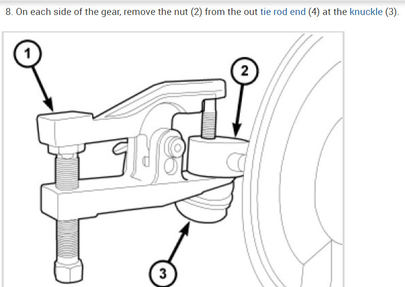

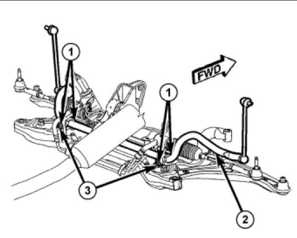

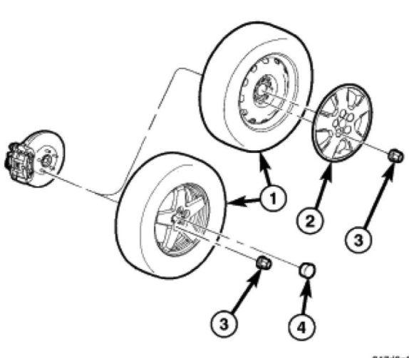

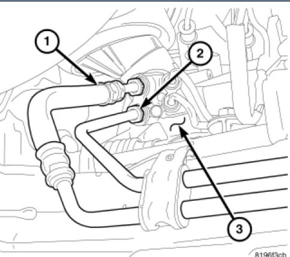

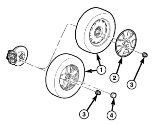

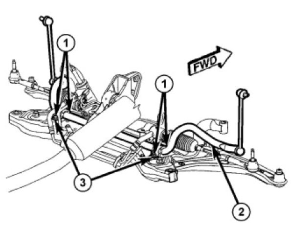

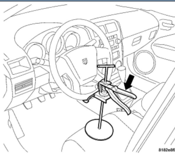

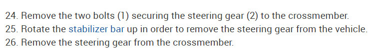

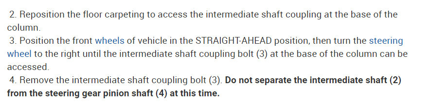

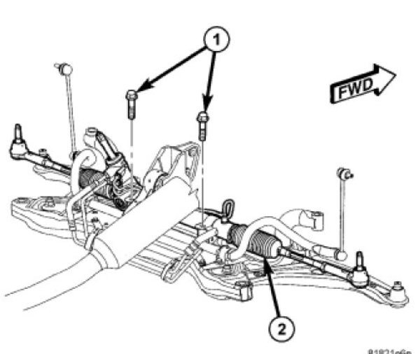

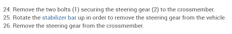

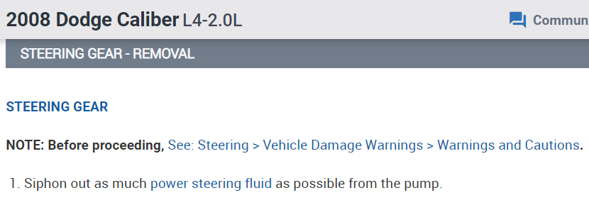

I've attached picture steps below on how to replace the power rack and pinion steering gear. Here is a tutorial show how to release ball joints which is part of the process:
https://www.2carpros.com/articles/how-to-release-a-ball-joint
I've attached the picture steps below for your car. Since there are a bunch of picture this will have to be in 2 parts. This is Part 1 removal process. Hope this helps and thanks for using 2CarPros.

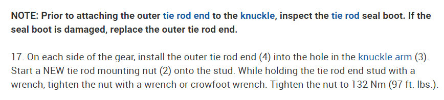

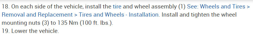

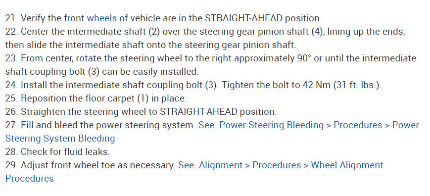

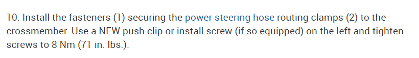

Dec 31, 2020 at 8:29 AM
DANNY L
  • 5,648 POSTS

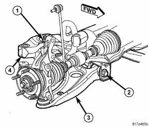

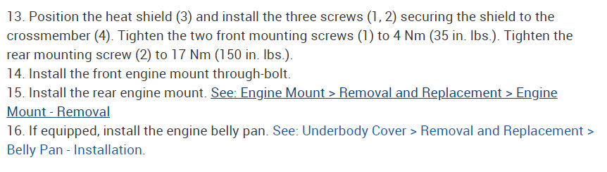

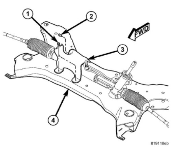

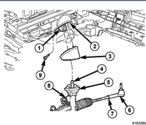

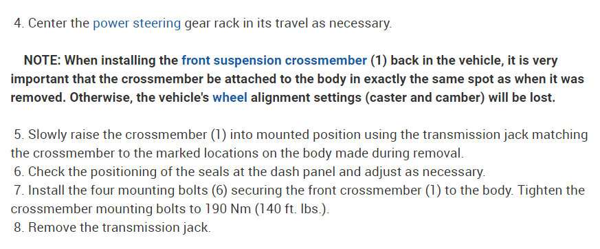

Hello again.

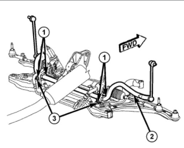

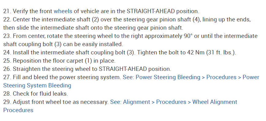

Here is post part 2 for installation. The picture replacement steps are attached below for your car. Hope this helps and thanks again for using 2CarPros.
Danny-

front steering rack arms and track rod end same.
Jan 7, 2021 at 4:16 AM (Merged)
STEVE W.
  • 15,347 POSTS
Part numbers show as different items.

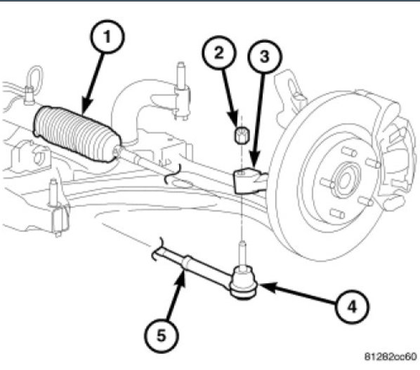

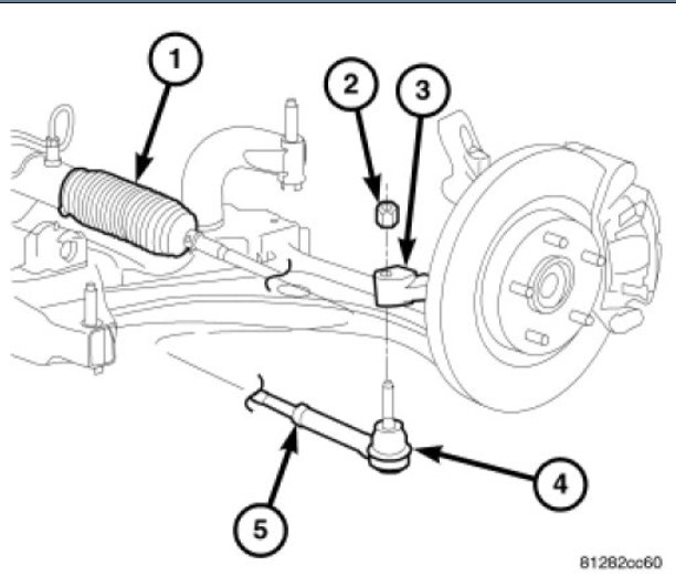

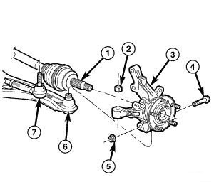

NIPUNA WEERASINGHE
Mot failure due to play in both front steering rack arms. nut when I try to buy parts not many familiar with word rack arm. does that mean track roads?
STEVE W.
  • 15,347 POSTS
Steering rack play would normally be in the inner or outer tie rod ends. Part 7 in the first picture.
There could also be play in the lower ball joints or in the lower control arm bushings.
Part 6 in the first picture and parts 1 and 2 in the second picture.
