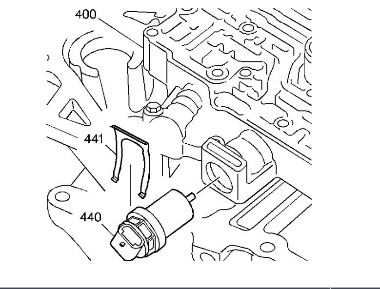

I need to find out where the automatic transmission input shaft speed sensor is at.
How hard is it to change the automatic transmission input shaft speed sensor?
Sep 28, 2018 at 6:17 AM
Good afternoon.
The sensor is inside the side cover of the transmission. The side cover case has to be removed in order to access the valve body for the sensor.
To remove the cover, you need to remove the axle shaft, drop that side of the cradle that holds the engine and transmission in order to get the correct amount of room to release the cover.
The job pays four hours in a shop with a lift and all the tools. If you were to attempt this, I would say you will need to double the time and maybe more.
Removal Procedure
1. Remove the case side cover.
2. Disconnect the transaxle wiring harness.
3. Remove the input speed sensor clip (441) from the case cover.
4. Remove the input speed sensor (440) from the case cover.

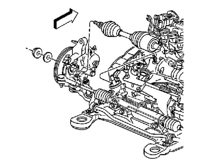

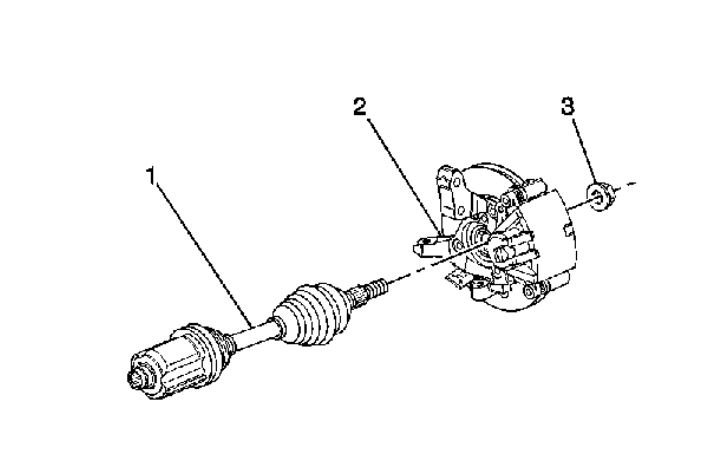

How hard is it to takeout the axle shaft?
Sep 28, 2018 at 7:07 AM
You need to remove the wheel, brake caliper, mount and the nut for the axle. Then the lower ball joint has to be released to allow enough movement to remove the out part of the axle. Then you can remove the axle shaft.

What size socket for the hub nut?
Sep 29, 2018 at 1:39 AM
Either a 32mm or a 36mm. Needs to be a deep socket and you need a 1/2 impact gun to remove it.
Sep 29, 2018 at 8:34 AM
DUSTYAE
  • 22 POSTS
Why can I not do it with a breaker bar or a ratchet?
Sep 29, 2018 at 10:03 AM
If you can break it loose from 220 to 230 ft lbs then go for it.
