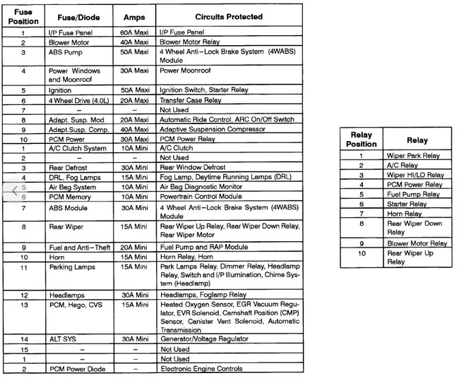

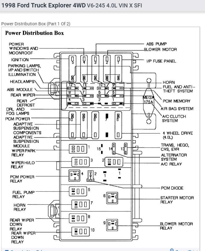

Boult a ford explorer the running lights not working no fire to the light check all fuse and light switch so how trace it
Feb 18, 2016 at 11:55 AM
SQM
  • 6,383 POSTS

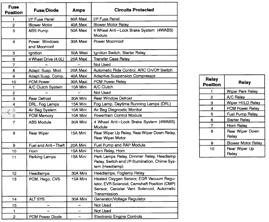

The parking light fuse is located under the hood in the power distribution center fuse box (see diagram below).
It should be fuse number 11, which is a 15A fuse.

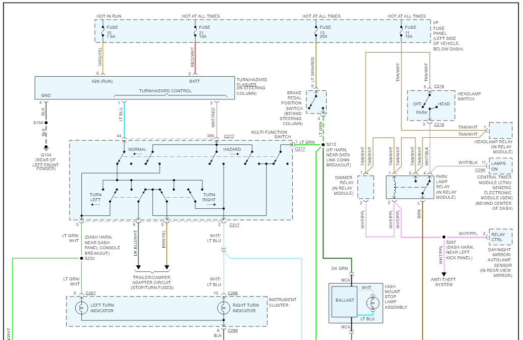

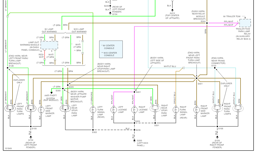

If the fuse if good, then the issue is likely a bad wire. Which will require tracing of the wires to find the short or a bad ground.
Here is a helpful guide:
I have attached wiring schematics below.
