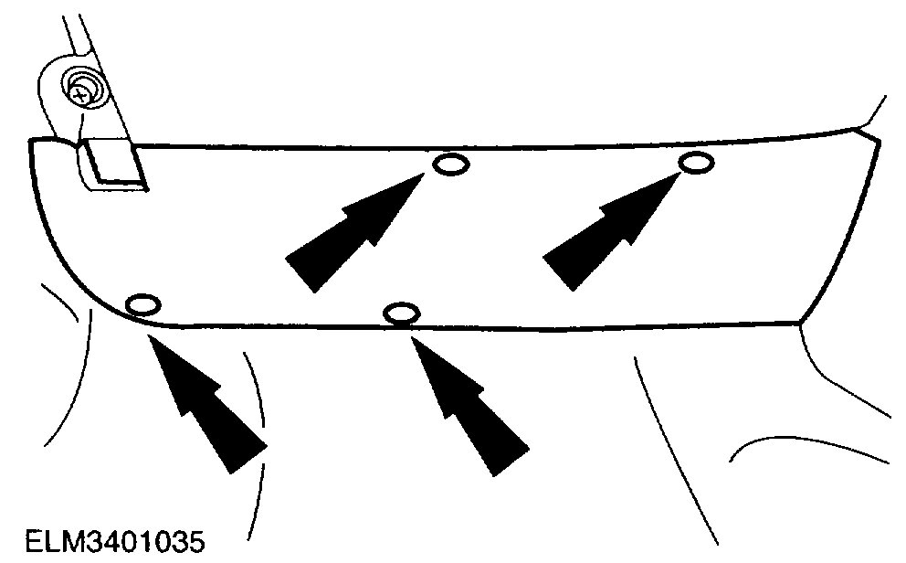

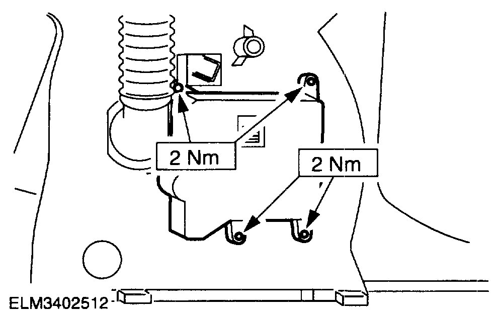

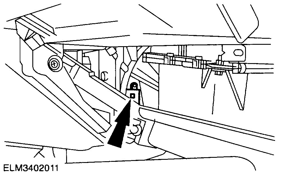

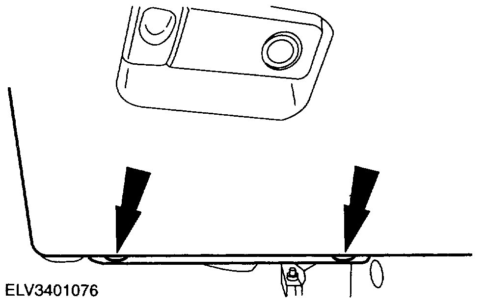

Here are the directions for removal and replacement of the blend door actuator. I'm adding this just to confirm we are referring to the same part. The attached pics correlate with the directions.
__________________________
1999 Mercury Cougar L4-122 2.0L DOHC VIN 3 SFI
Blend Door Motor
Vehicle Heating and Air Conditioning Air Door Actuator / Motor Service and Repair Procedures Blend Door Motor
BLEND DOOR MOTOR
REMOVAL
1. Disconnect the battery ground cable.
pic 1
2. Remove the glove compartment.
pic 2
3. Remove the footwell upper trim panel (passenger side).
^ Remove the pushpins.
pic 3
4. Disconnect the electrical connector.
pic 4
