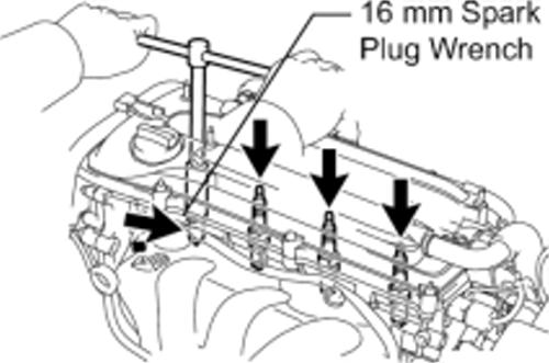

how exactly do i get to the spark plugs and wires?

2.4L Engine
Specific to:
Toyota Camry 2007-2008
Before servicing the vehicle, refer to the Precautions Section.
Remove the plastic engine cover.
Disconnect the 4 ignition coil connectors and remove the 4 bolts and ignition coils.
Using a 16 mm (0.63 in.) Spark plug wrench, remove the 4 spark plugs.
Installation is the reverse of removal.
Torque the ignition coils to 66 inch lbs. (7.5 Nm) and the spark plugs to 13 ft. lbs (18 Nm).

Try cleaning the throttle body using carb/throttle body spray cleaner, a rag and/or small soft bristle brush.
